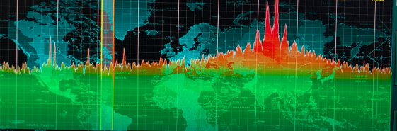

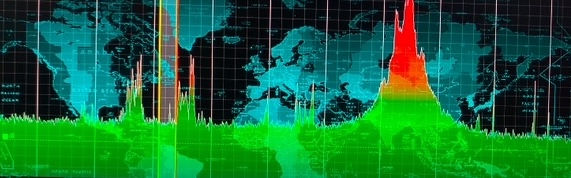

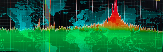

I'd like to ask for advice and possible solutions with regard to a problem that came up over the past few weeks. There is a 1.5kW station not that far down the road from me that operates on a frequency in the 40m about 45 kHz up from me regularly. His signal is causing artifacts across the entire phone part of the 40m band, and beyond. The entire 40m phone band undulates up and down with static crashes and waves of distortion. I have a .mov file which shows what's going on well, but that doesn't seem to be one of the acceptable attachment file types, so I'm settling on a few stills.
Chris, NU6C
Note added: Since it might not be clear from the images, the signal in question is an SSB signal that itself sounds reasonable when I tune it in.

Re: high power amateur station down the road wiping out 40m band
Post by ea3aqr »
Do you have NB active?, if so turn it off
Posts: 6109
Classic co-channel interference. There's not a lot to be done about it. Cranking some step attenuator in on receive will help a little, but at the expense of weaker signal reception.
It would be interesting to see the entire UI screenshot, with freq's, amplitudes and S-meter shown. And you might consider adjusting your display baseline so that fully half of it is not noise ;)
Another option would be to set up another antenna to use the diversity (really beamforming) feature of the radio. If you can get things arranged so that there is a 20dB antenna pattern null in the direction of your neighbor, that plus 10dB or so of attenuation would make a big dent in things.
I'm not sure how well you know this person. The signal has a lot of IMD (splatter) on it. If you could get him to drive his amp a little less hard that would also help. But, you know, most hams don't feel like they are getting their money's worth unless the power needle stays pinned at 1500W :roll:

I looked at the YT video. That's an oldie but goodie. Gerald is 100% correct. Indeed, I normally run my preselector (bandpass filters) in bypass 100% of the time because I often like to look at two different bands.
The other thing to consider is that, in all of the Hermes-derivative Apache designs, there is an LTC6400 differential amplifier immediately prior to the LTC2208 ADC. The LTC6400 will not start to saturate until the total RF input power level is well above +10dBm. Thus that is not a limiting factor, the ADC will overload first.
You are not seeing an ADC overload condition, if that's what you are thinking. That is real splatter coming from the antenna. I wonder what sort of radio and amplifier that station uses.

Here's an update. As noted here by ea3aqr and also noted by someone who responded to a thread on this subject I created elsewhere, the use of noise blanker (NB, NB2) with very strong signals leads to artifacts that wipe out the band. The very strong, dirty signal still remains after turning off noise blanker, but at least the entire band is not trashed. The dirty signal emanates from an LSB transmission at "7.225." It's a rag chew. An updated video is linked below. The very strong signal at "7.225" (there are a couple at lower frequency too, but not nearly as bad) is featured at the start of the video with noise blanker off. After a few seconds I click through NB and then NB2 to show the effect. At the 23 second mark the very strong signal at "7.225" ceases, and then a new, weaker, dirty signal comes in at the 27 second mark from someone else. I do adjust the attenuation in practice in my use of the radio, despite the fact that ATT is showing 0 dB in the video. The general lack of responsiveness of the spectrum display in the previous video was not due to averaging, but was due to the use of the default FFT algorithm.
Chris, NU6C
