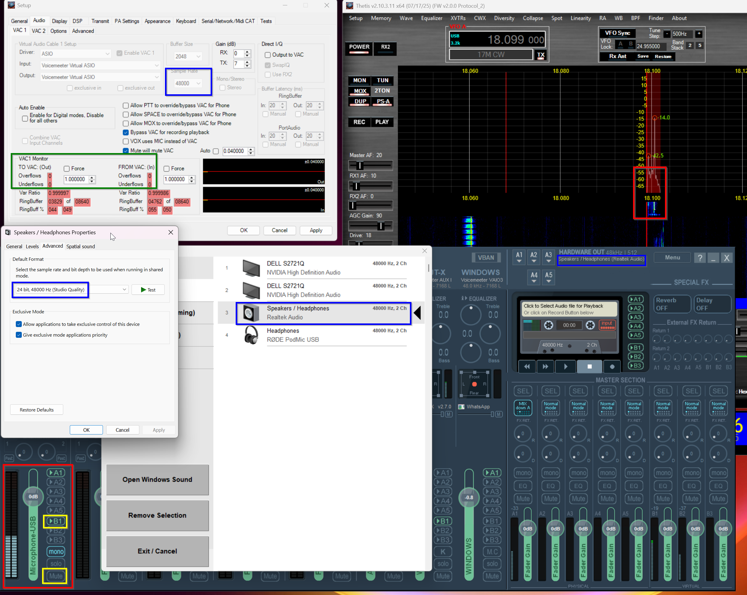

I'm fairly new to both this group and to using G2. I've been running into an issue with VAC overflow and underflow on both the input and output sides. As a result, I'm losing data packets in FT8 mode, which is impacting both transmit and receive performance.
Please see the attached image for reference. After resetting the values to zero, I’ve noticed that as soon as the transmit cycle completes, the overflow and underflow counts begin to rise again. I'm not sure what's causing this or how to resolve it.

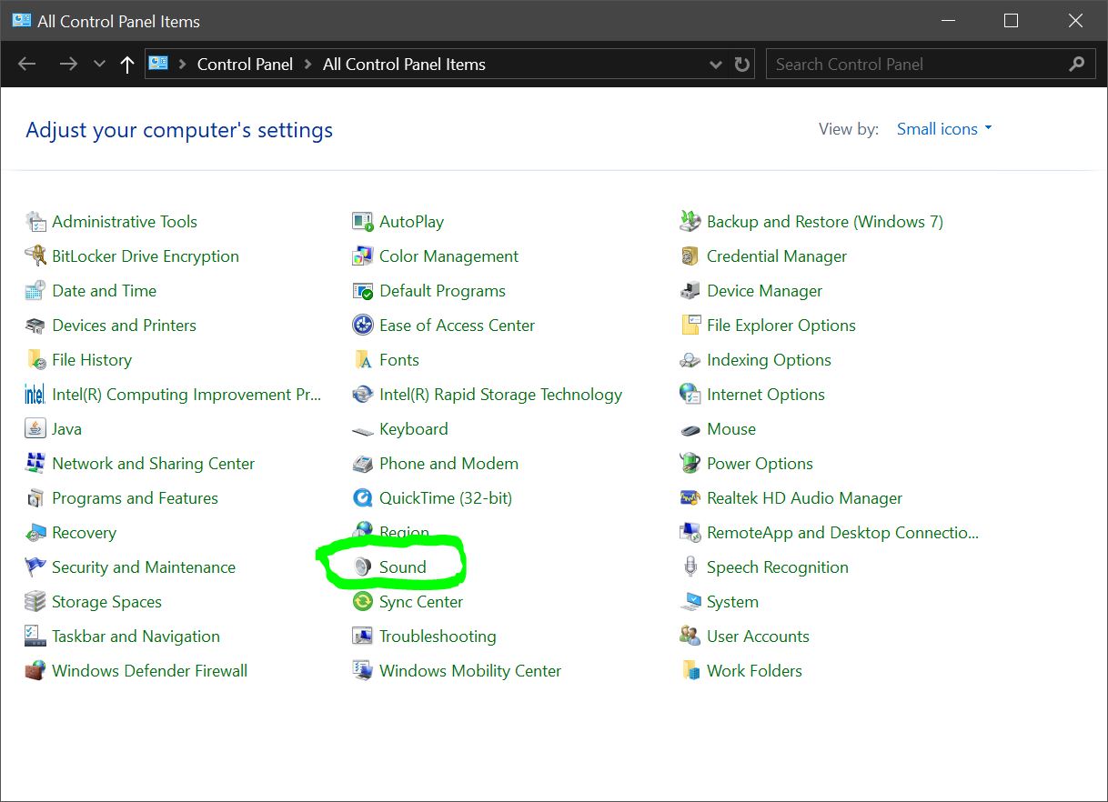

First and foremost, make certain that you have gone into the old Windows Sound Control Panel, this one here:
Drill down into all of the Voicemeeter related devices and change their properties to 48KHz sample rate. 16 or 24 bits doesn't matter. Then restart Voicemeeter.

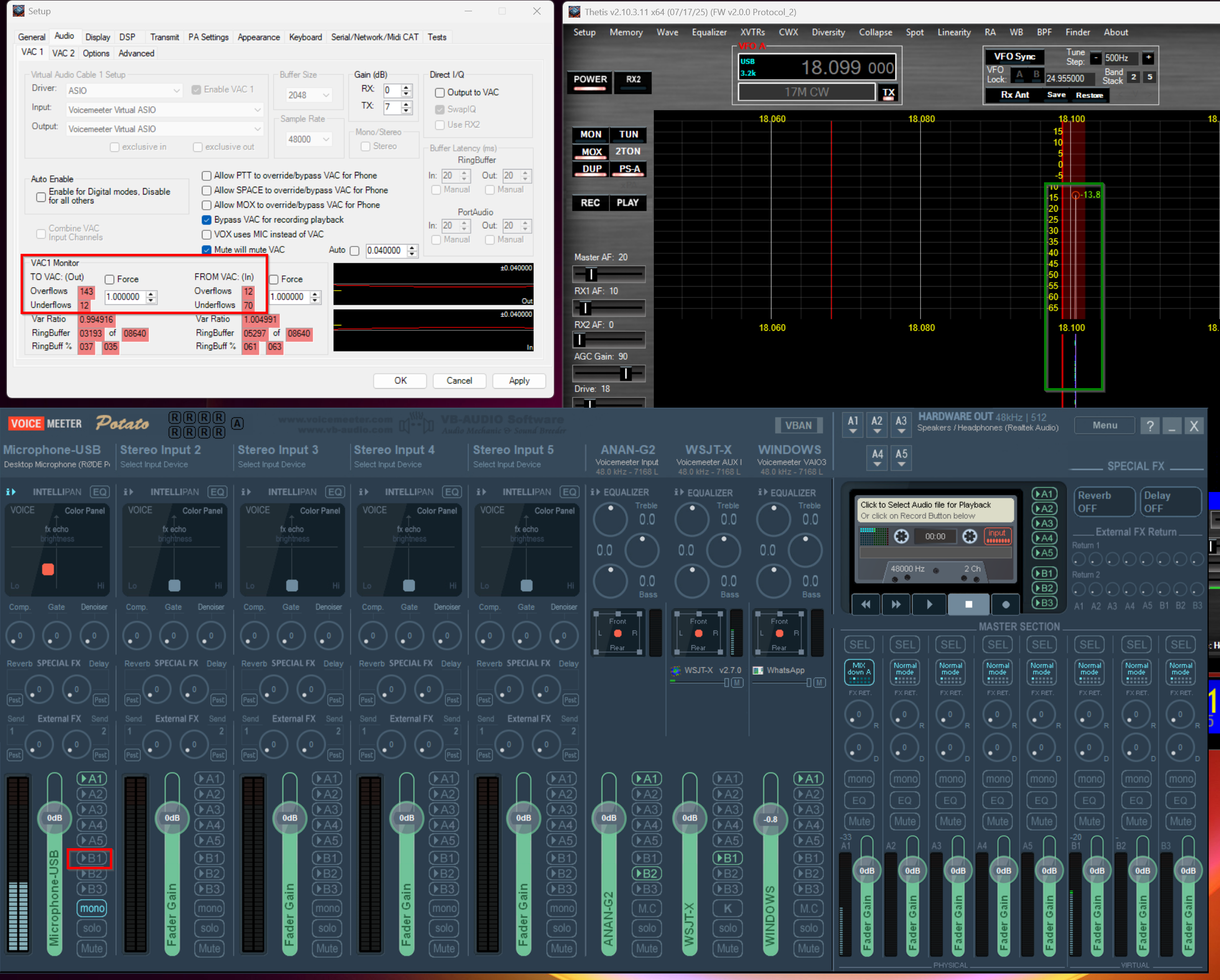

I’ve identified when VAC1 overflow and underflow values begin to rise—they occur if I mute the microphone or disable M1 while operating in FT8 mode. Otherwise, ambient room noise is captured by the mic and mixed into the FT8 transmit signal, as shown in the G2 waterfall (marked in red). Following that, at the end of the transmission cycle, VAC1 OF/UF values increase, resulting in degraded FT8 decoding.
VAC1 error when Mute or B1 turned off.png (1.45 MiB) Viewed 433 times
Once M1 disables or mutes the mic, the OF/UF values begin to increase. But as you see transmitted signal is clean.

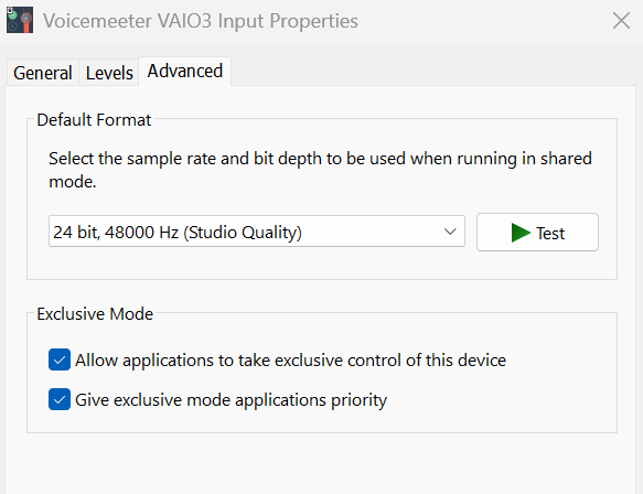

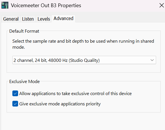

You showed your PC sound interface output is 48KHz. What about the Voicemeeter virtual devices in the sound control panel? Input and output?

Both VM virtual devices are configured to 48kHz. I also tried using MME, but that didn’t yield any results. I’m starting to think the onboard sound card on my PC might be the culprit. What puzzles me, though, is why the VAC values begin to rise whenever I mute or disable B1 in VM.

Scott — issue resolved. No more VAC overflows or underflows. The mic is muted or B1 disabled. Turns out I was using USB mode in FT8 instead of DIGU.
