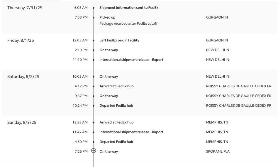

This is the travel history on the one I ordered.
