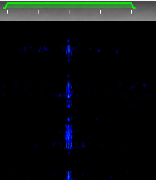

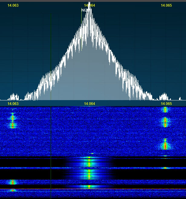

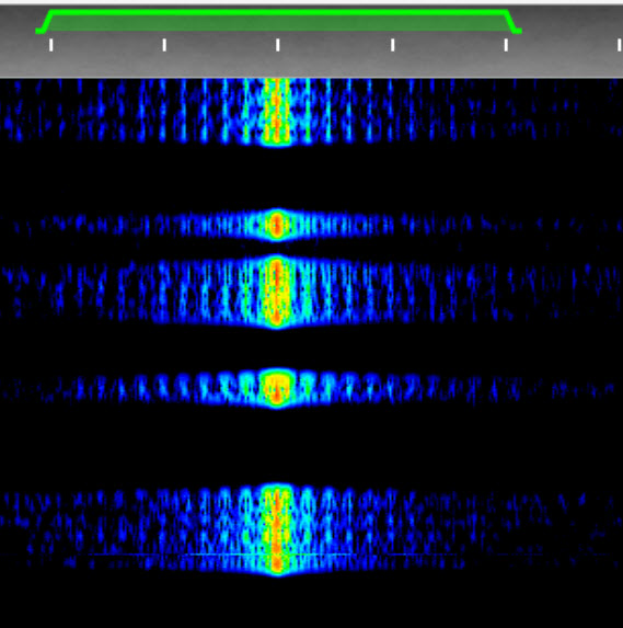

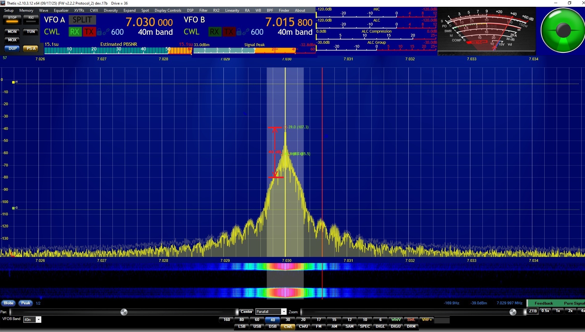

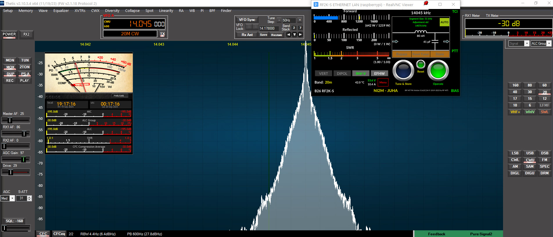

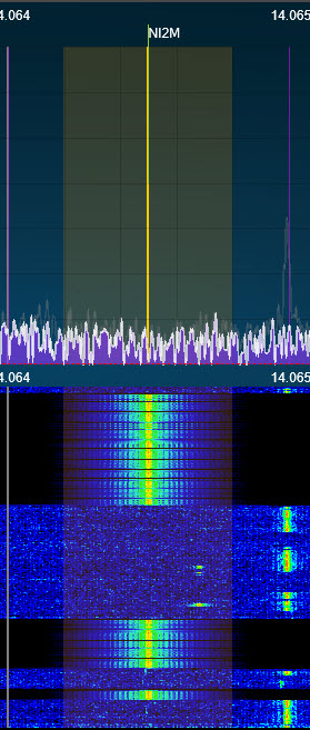

For the first time ever, someone told me that I generated awful key-clicks on CW. Also, I was told that it seemed like there were more than 1 CW signal at the same time. The station I worked told me afterwards that I was "clean" on his end. I have embedded some images below.
Even barefoot, with amp, the CW looked about the same into a dummy load. It is flakey so I don't want to have the amp in line when putting RF from amp into it.
Any ideas?
Any ideas?
- CW at 1200W in Waterfall.jpg (105.5 KiB) Viewed 2654 times
- CW at 40W in Waterfall.jpg (13.91 KiB) Viewed 2654 times
- CW at 40W in Panadapter.jpg (15.91 KiB) Viewed 2654 times

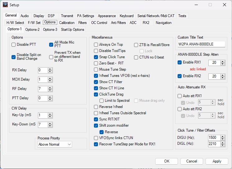

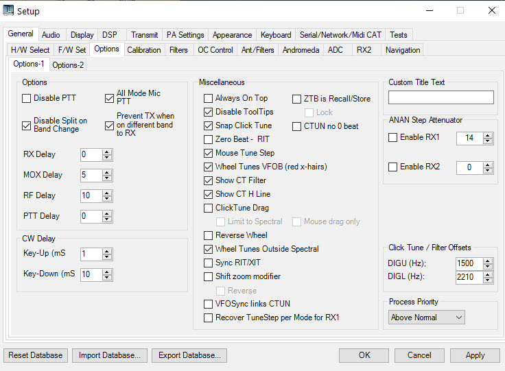

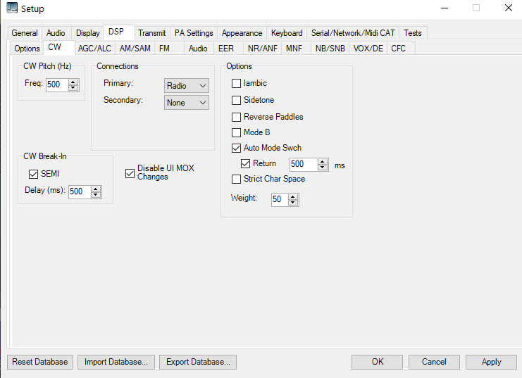

Juha,
I'm not seeing anything wrong with the settings you posted, except maybe your MOX delay is high. See my settings below - my CW sig has always been click free. Also, it's difficult to completely judge your panadapter photo without its vertical scale.
Are you really running Thetis v2.10.3.4? If so, why not upgrade - the current test version is v2.10.3.12.
- CWSettingsW2PA.jpg (135.08 KiB) Viewed 2556 times
Chris, W2PA

Re: Key clicks on CW
Hi Chris!
Vertical scale:
Max -20
Min -100
Will try to play with MOX.
The only reason for me using a very old version is that on SSB, any version that features cmASIO (I don't need to use Voicemeeterpotato as I don't need/want to) is that when I have Digital Audio Workstation (DAW) in the audio chain, latency increases.......Truth be told, I haven't actually tried it as the current ("antique") version has worked well
for years. I have also taken part in CW contests and have never been made aware of any "clicks."
I assume the latest "test version" can be had on github?
George,
I appreciate your suggestion, too.
Vertical scale:
Max -20
Min -100
George,

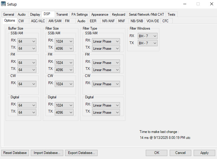

Under General>F/W Set, try reducing Rx1 Sample to 192K to first see if that has any effect on the problem.
Hi Chris,
RX1 sample size is already 192k. Reduced it by a notch. No appreciable difference. Will also see if changing MOX setting makes a difference. Tried and no joy.

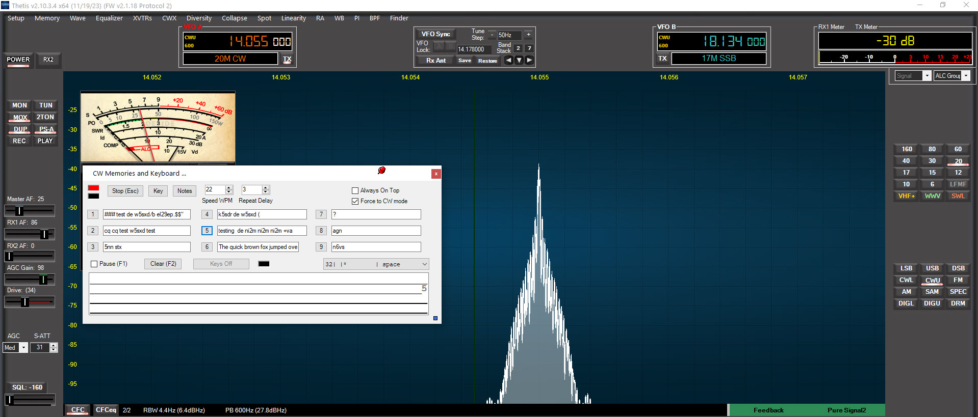

Hi Richie and Laurence!

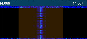

Tried CWX form and don't see much difference. See embedded images below. About 40 W out and 1300W.
NOTE: The scale used to display the X axis is 4x!
Amplifier is a German RF2K-S full-legal limit and it is keyed with a PTT line between the ANAN and the amp. The RX/TX switching in the amp is via a PIN diode and according to the specs, the time from RX to TX is <1ms.
I have provided images from some of the CW settings that I am using using currently above, in this thread! Would be wonderful is someone who also uses an RF2K-S amp would take a look at my settings.
The reported CW clicks are likely due to poor CW settings in Thetis!
I will REALLY appreciate pointers!!

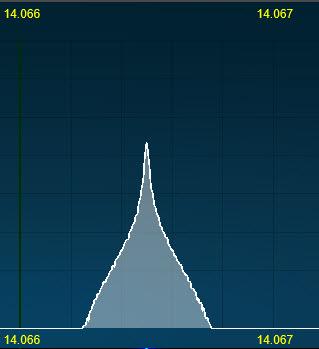

Juha,
What's being missed here is that you're hyper-zoomed-in on the CW waveform spectra -- and it looks worse than it is. You've expanded each horizontal division to 200 Hz. At 200 Hz from Fc, your keying sidebands are approximately -40 dBc.
I conducted the same test, 200 Hz/div. using an Rx1 Sample of 384K, and 40W into a Bird Termaline load. I also measure -40 dBc relative to 200 Hz from Fc (see attached image below). The waterfall image shows bandwidth mostly held to +/- 200 Hz (i.e., red coloring). A break can be seen between two bandwidth samples.
The spectra is a string of dots at 20 WPM. Bandwidth doesn't change with keying speed. It's the slope and contour of the rise/fall waveform that determines bandwidth, notwithstanding issues like ALC envelope control, for example. In that case, ALC can have an effect on bandwidth as keying speed changes, but that's not at all evident in the Apache Labs SDR transceiver designs.
The station complaining of clicks may have had a noise blanker engaged. Did you ask?
I rarely look at spectrum when assessing things like RF hot-switching, a common cause of key clicks. I'd rather look at the time domain. Just my opinion, but all of us should own an oscilloscope for various transmission measurements. We think nothing of spending nearly $1K on a fancy wattmeter with needless high-precision accuracy, then neglect something truly useful like a scope.
By the way, there have been discussions between the ARRL and transceiver manufacturers to comply with a proposed RF bandwidth mask. For CW, it's a modified Gaussian curve, not a strict raised-cosine shape. I've no idea how far along commitments have come from manufacturers.
- W9AC CW Keying Bandwidth.jpg (497.77 KiB) Viewed 2171 times

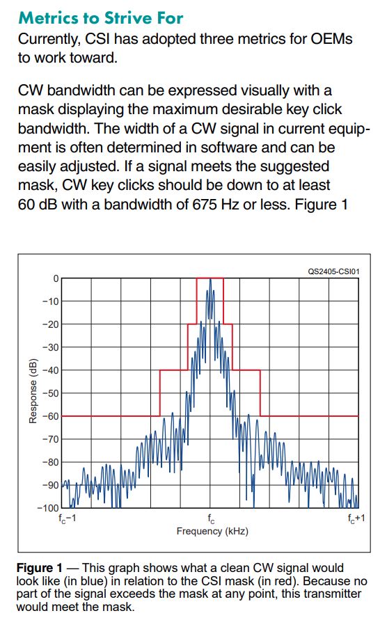

Warren Pratt has been working closely with the ARRL on the ARRL's "Clean Signal Initiative".
https://www.arrl.org/arrl-clean-signal-initiative
As a result, he has proposed a further optimization of the shaping of the CW leading and trailing edges for openHPSDR radios. Note that shaping is already hard-coded into the software and firmware that substantially meets the ARRL goals. I'm not sure/can't remember what the status of this is, but I will endeavor to find out and report back.
Here is a snippet from the QST May 2024 article (worth a read, see the link at the URL posted above):
Now compare the proposed RF mask with my measured spectrum. At 200 Hz from Fc, the current raised-cosine shape from my 7000DLE with Thetis *just* fits under the stepped curve. But at -60 dB, it just barely falls short. It's so far down, that it has a de minimis effect.
From G3OTK's article at https://www.ivarc.org.uk/uploads/1/2/3/ ... sion_1.pdf
Referring to Figure 5:
"The part of the Gaussian response between the amplitude 0.1 and 0.9 is a close approximation to the raised cosine with a maximum slope equivalent to the 5ms ramp but with an additional delay of about 1.2ms. The initial rate of change is less and the so required bandwidth is less. This Gaussian response is particularly attractive because it has almost no overshoot."
This is the League's new target.
