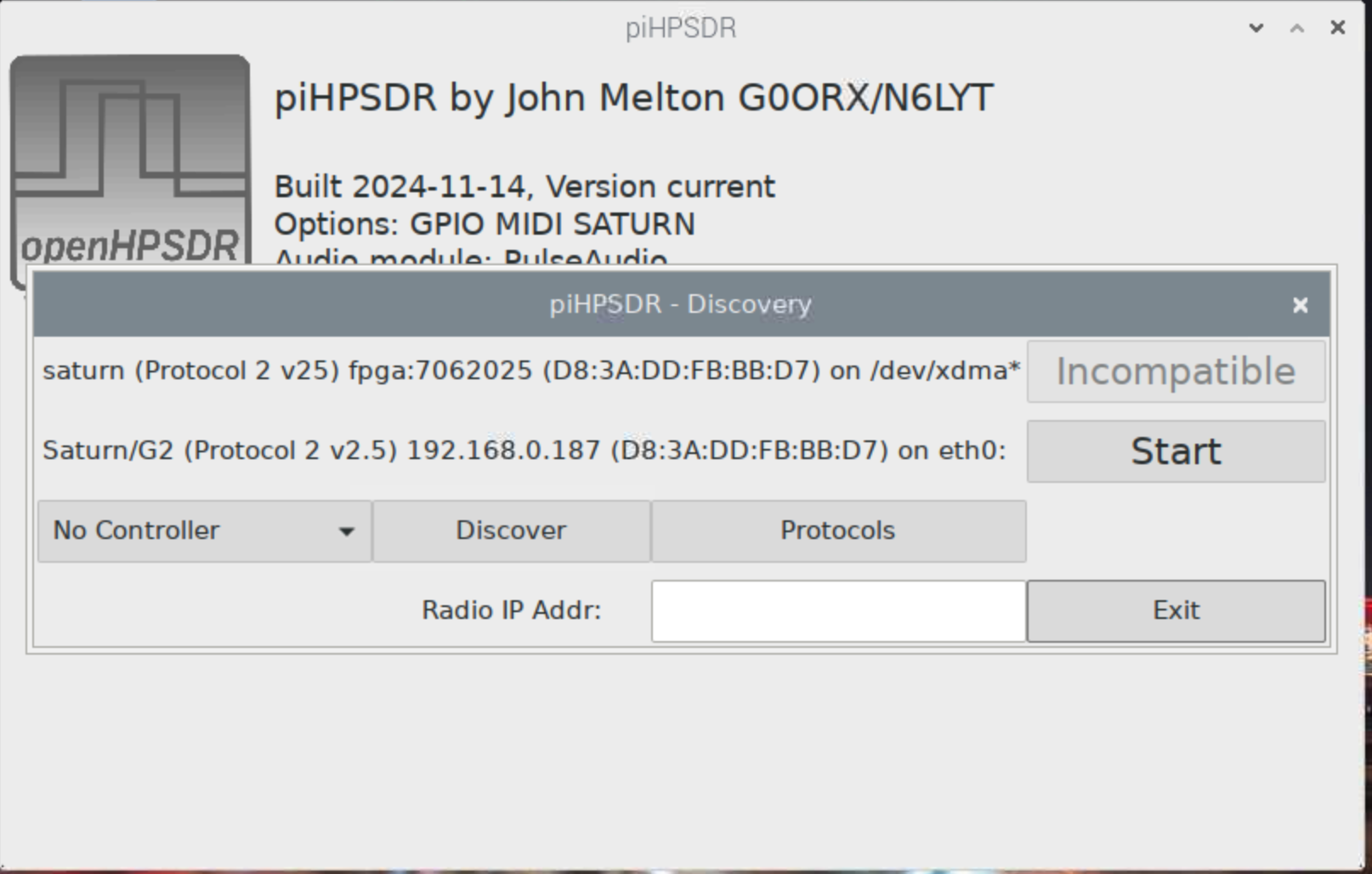

The radio seems to work ok from Thetis. When I bring up piHPSDR in a terminal session that also works. I am a bit concerned about the error message below during the discovery process that says "Incompatible" for Protocol 2 v25. Any thoughts on what that might be about?

Most likely is because you are not running the latest version of PiHPSDR. I ran into the same thing and had to download and build the latest version to get it to work.

I ran into the same problem a while back. You need a fairly recent version of PiHPSDR. Look for dl1ycf's Github repository (https://github.com/dl1ycf/pihpsdr). Download the manual and follow the instructions to build it (Appendix J).
Note that the software is updated regularly.

It's kind of strange, as using the second line (START) on eth0 it runs. I'm not really sure what I'm looking at there though. Perhaps time to start a new thread and learn.

I would look at the desktop shortcut path and see why it's showing two different radios. You may need to do some editing to make the radio discovery show only the listed connection by the Start button.
