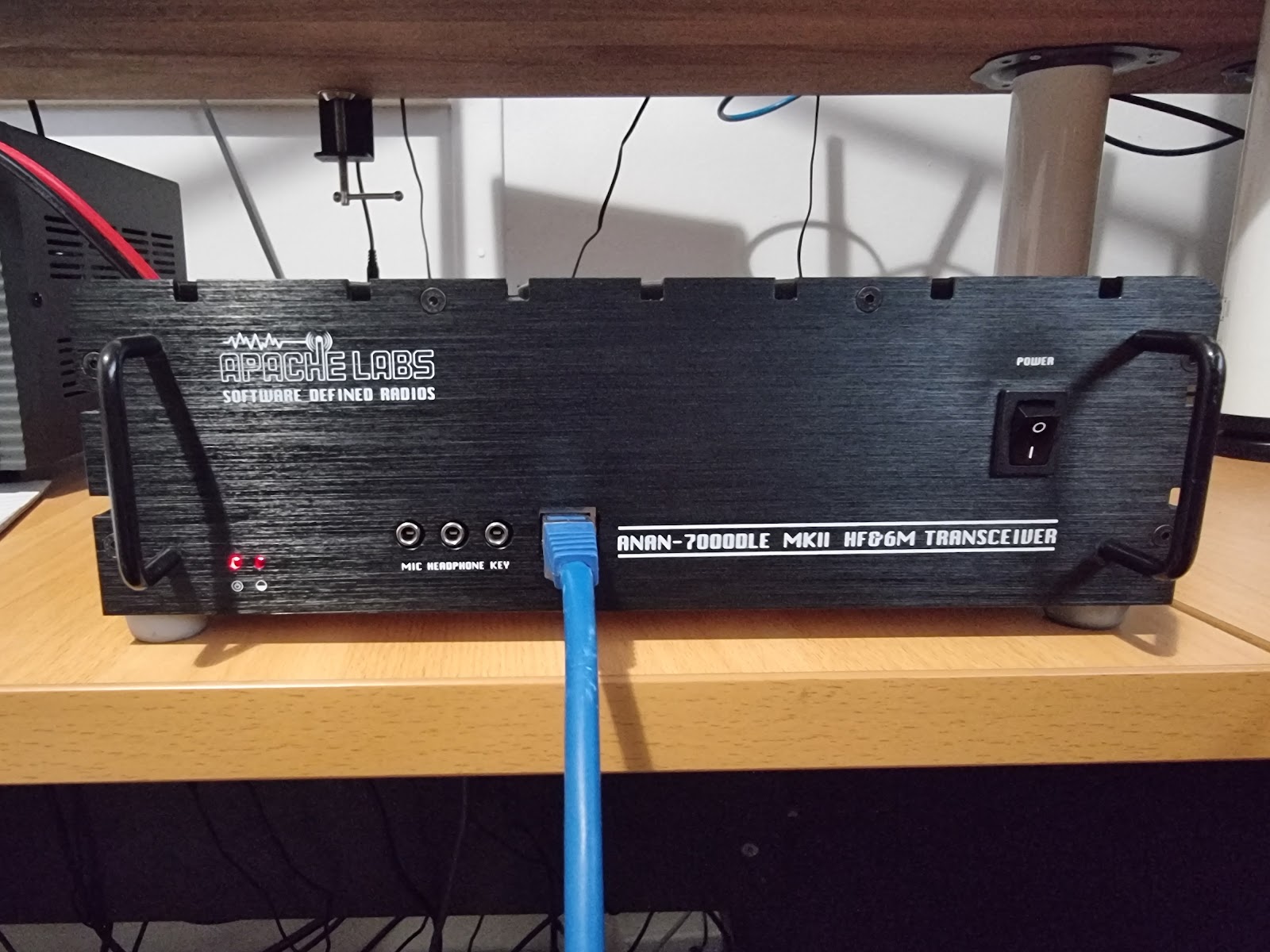

2wks and counting I have been unable to use my Anan 7000 DLE MKII
I’ve recently run into an issue where I can no longer connect to my ANAN-7000DLE MKII.
For several months the setup worked flawlessly:
Starlink providing internet
Starlink Ethernet → unmanaged 5-port switch
One Ethernet from the switch to the PC NIC
One Ethernet from the switch directly to the ANAN
The ANAN was always discovered instantly by Thetis and operated normally.
At some point (no hardware changes that I’m aware of), the ANAN stopped being discoverable and I can no longer connect to it.
What I’ve tried since:
  • Removing the switch and connecting the ANAN directly to the PC NIC
  • Resetting Windows network settings
  • Assigning static IPs on both the PC and ANAN (same subnet)
  • Disabling Wi-Fi and firewall for testing
  • Trying multiple Ethernet cables
Current behaviour:
  • PC NIC works normally (can ping its own IP)
  • Ethernet link lights are present on both the PC and ANAN
  • ping to the ANAN IP fails (destination host unreachable)
Thetis does not discover the radio
When placed into bootloader mode, the ANAN shows green LEDs and the Ethernet link comes up, suggesting the Ethernet hardware itself is OK

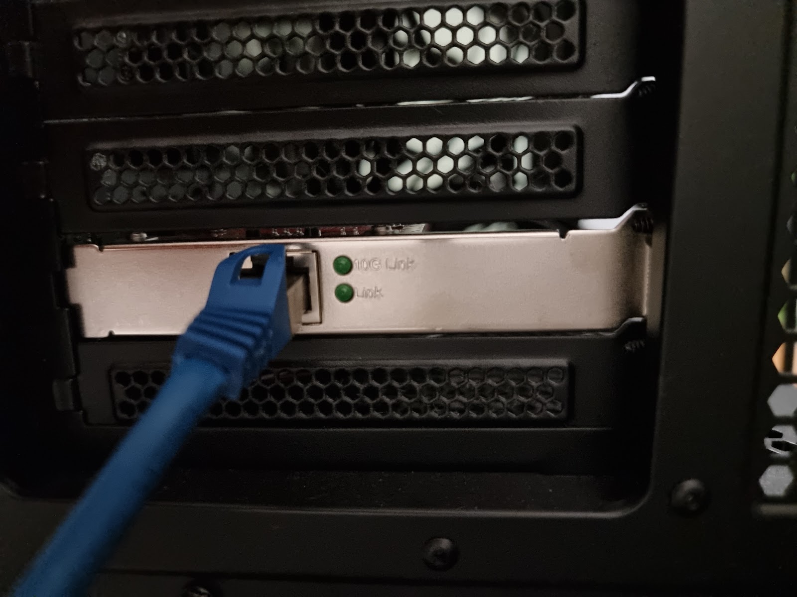

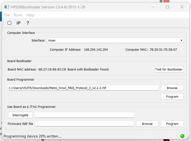

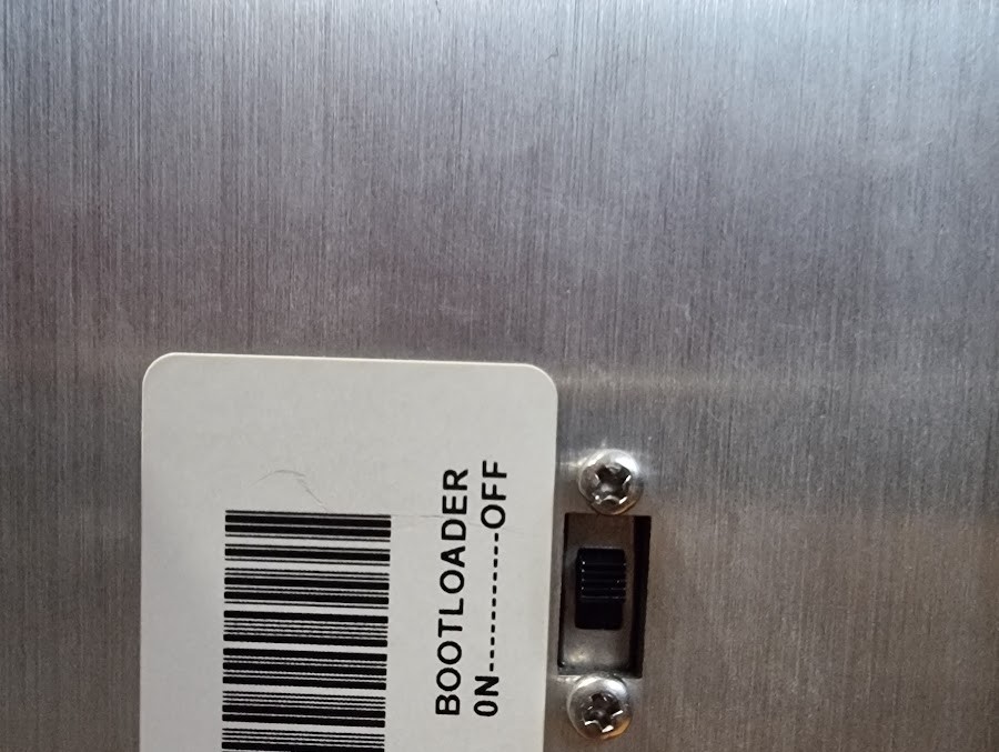

Bootloader switch works as far as I can tell, when switched off using HPSDR Bootloader (v2.0.4.4) I'm unable to read nor write to the 7000. 2 red lights on the front are static, and no link lights at all at the ethernet port, only when I'm in bootloader mode is there ethernet link lights.
When bootloader switch is in the on position I'm able to read current IP and it recognises that there is bootloader on the board.
Bootloader on my unit is already labelled on and off see pics.
2. Make certain you power cycle the ANAN after and every time you move the Bootloader switch. Put it in Bootloader position--power cycle. Put it in normal position--power cycle.
Have done this almost certainly every time.
3. Test the Ethernet cables. It is possible to have a cable that appears to be working but has a single broken pin. This will cause the link to go to 100BASE-T (100Mb/s) mode, or half duplex GigE mode. You want full duplex GigE and that requires all pins and wires on the cable to be good. To test all the cables, connect them between your switch and the PC one at a time. Make sure the Windows network control panel reports a full-duplex, GigE connection, and that the color of the LEDs on the switch report the same thing. Bootloader firmware runs at 100BASE-T only, so it can be successful with a partially broken cable. P2 firmware runs at GigE only. There is no automatic speed or duplex negotiation in any openHPSDR firmware.
Have tested multiple cables, I purchased a TP-Link Nic recently as pictured so that the Anan has its own seperate Nic.
4. If all the cables test good, visually inspect the Ethernet connectors on the 7000 and the switch and make certain they are in good repair.
Both the Anan and the Nic Ethernet connectors appear to both be in good repair. No bent pins etc.
5. Put the original P2 firmware back into place. What version were you using, do you remember? It's super-important to have the right version because of the three different FPGAs that have been used across the family of 7000's. See this topic: viewtopic.php?t=4462 If you are unsure of what P2 firmware to use then you can either a) try all three versions or, b) peek inside and identify the FPGA part number.
I have loaded or what HPSDR Bootloader is telling me I have loaded without failure is Metis_Orion_MkII_Protocol_2_v2.2.2.rbf. My unit is a Anan 7000 DLE MK II and according to the firmware and my serial number I fall in this category. ANAN-7000DLE MKII, no serial number or serial number lower than DX8300497A
6. Change the IP addressing on both the PC and ANAN back to DHCP (for now) in order to avoid any sort of IP address conflicts or other misconfigurations on your network. In the ANAN that means use Bootloader to set the IP to 0.0.0.0.
Have set the new Nic card to DHCP & also the Anan to 0.0.0.0 as above.
7. Assuming all of the above has been done correctly and no problems are found, when you power up the 7000 with the correct P2 firmware and a good Ethernet cable and connectors, check the LED indications on the switch to see if it has obtained a GigE link with the 7000.
There is no link lights when powering up the Anan 7000 on the Nic card after checking connectors, loading the correct P2 firmware (unless I'm confused and not loaded the correct firmware).
If you can report back on the above steps and tests it will help to either fix, or at least narrow down, the problem.

Posts: 6109
Re: Anan 7000 DLE MKII Sudden Connection Issues
Strong work, Jordan! This is narrowing things down.
Unfortunately it appears you changed more than one thing between the last configuration and this one. Some things need to be clarified.
It now appears that you have two NICs in your PC, is that correct? And that you are using a direct connection between the PC using the 10Gb NIC and the ANAN? If that is the case, then there are several concerns.
- This configuration will default to APIPA addressing, hence the 169.x.x.x address you see on the new NIC. This ought not to be a problem, but I just wanted to point it out. The NIC, and the ANAN, will not obtain DHCP and both should ultimately negotiate their own APIPA address. This can take tens of seconds, sometimes.
- The new NIC may or may not be a problem (as opposed to "the" problem).
For now, I recommend going back to your original config. which is the original NIC, the Starlink router, and the switch. This will let you monitor link lights at the switch for proper connection and speeds, and the Starlink router will provide DHCP. Ultimately, however, a dedicated NIC is the best way to go. But best to figure things out, first.
Even if the Windows firewall is interrupting things, the 7000 should form a good Ethernet link with the switch.
Assuming you get the same behavior going back to the original configuration, i.e. no link at all, then there is only one thing left to do, and that is to try the three versions of firmware for the three different FPGA types, in the hope that there's simply been a mistake made in loading the right firmware. This will not take long. I see you are using the versions from this link, which is fine, viewtopic.php?t=4972
Note that Bootloader will happily load any firmware into the 7000, right or wrong. So after trying all three variants of 2.2.2, if nothing works, then I'm going to suggest that the PHY chip on the Orion MKII board has died. This is U13. This is not a difficult chip to replace if you are skilled in surface mount rework. Doug can and has replaced many of these.
It's unfortunate that a serial console port was never integrated into any Apache board design or the openHPSDR firmware. Something like that would go a long way to confirming problems like this.
