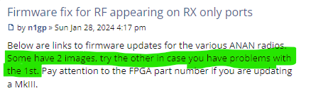

Below are links to firmware updates for the various ANAN radios.
Some have 2 or more images, try the others in case you have problems with
the 1st. Pay attention to the FPGA part number if you are updating
a MkIII.
