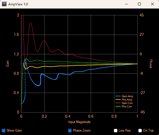

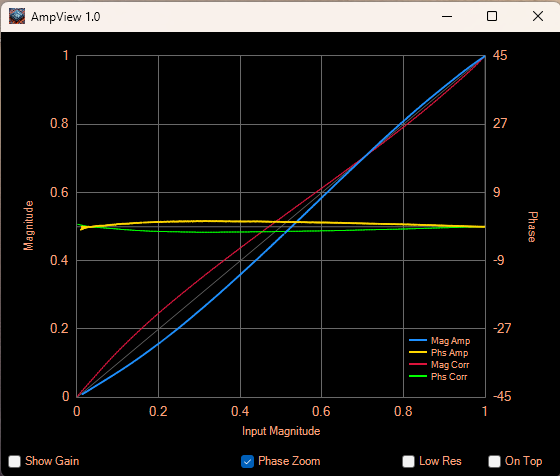

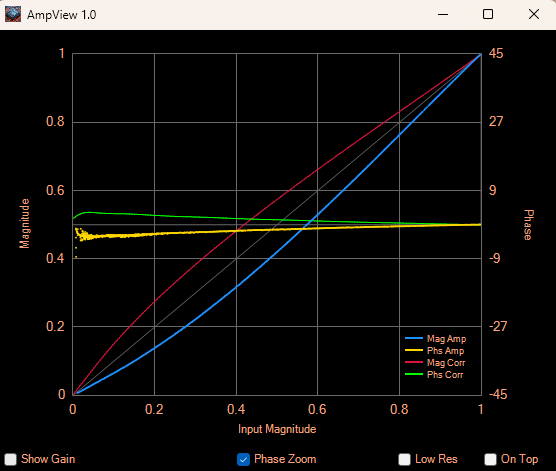

On occasion, my 7000 MKIII experiences an odd looking Amp View when doing a two tone P.S. calibration. I have seen other examples of this sort of Amp View by others but always with a different twist than I am seeing. Here's my normal Amp View on 80 meters, external (or internal) coupler at 50 watts out, dummy load, no external amplifier:
80 meters 50 watts normal.png (36.15 KiB) Viewed 200 times

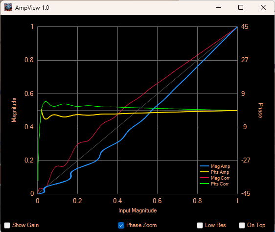

Here's what an abnormal Amp View looks like. All conditions are the same:
80 meters 50 watts abnormal.png (40.45 KiB) Viewed 200 times
What's really weird about this is the condition comes and goes if I power the radio off and then back on. It will start up in either of the two conditions, affects all bands and no amount of fiddling with Thetis changes it and believe me, I've fiddled. Yesterday it was squirrely and tonight it started out normal and I tested for about two hours. Everything was looking just fine and I didn't know what had happened to "fix" the problem but all seemed ok. I then shifted my attention to a slightly loud radio fan. I "turned off the radio switch" in Thetis and then flipped off the radio power. Fan noise went away so I confirmed the noise wasn't coming from a different piece of gear. Powered the radio back on, fan noise returned, turned the "power button" back on in Thetis and everything looked normal. I then did a two-tone calibration and Amp View had turned ugly. Through lots of trial and error, this scenario is very repeatable. I don't do anything in Thetis other than turn the radio "power button" off, I then switch off physical radio power, wait maybe 10 seconds, switch power back on, turn the Thetis "power button" back on and do a calibration. Sometimes, the curves return to normal if they are ugly and sometimes they turn to ugly if they were good. So far, once they are bad, I've been able to return to good although it might take 4 or 5 cycles of turning the radio off and then back on. Going from good to ugly seems to take far fewer cycles - like one!
Of course, the fan has nothing to do with the problem but it is what prompted me to cycle power on the radio and I discovered doing that may either fix or discombobulate my two-tone Amp View calibration and I assume my Pure Signal operation.
The amount of squiggle in my curves after a power cycle does vary from looking great to a little wavy to even more wavy than the screen shot shown above. When really wavy, P.S. cannot find a solution and does not correct. Oddly though, if I change even one of the tones just slightly, P.S. may start to correct.

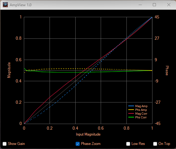

While changing tone frequencies, I've discovered something maybe everyone else always knows but here's my "normal" curves at 700/1900:
Normal Amp View at 700&1900.png (35.07 KiB) Viewed 200 times

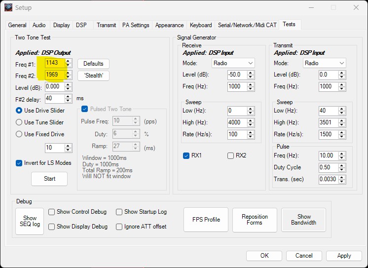

Notice blue and yellow traces are dotted. The "normal" plot at the beginning of this post was at 701/1900. Probably not important but still interesting. May have something to do with my computer if others do not see this same behavior. 800/1800 are also dotted but not if either tone is changed by even 1 Hz, up or down. I've settled on oddball numbers like 803/1811 or 709/1137. Always smooth plot curves.

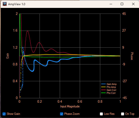

One last set of plots. Here are the gain curves when things look normal vs squiggly:
Normal gain.png (27.85 KiB) Viewed 200 times
Squiggly gain.png (37.37 KiB) Viewed 200 times
To quote Tooter Turtle, "Help, Mr. Wizard"! Any ideas on what's wrong with my radio? Thetis is at Ver 2.10.3.11 and firmware version is 2.2.2.

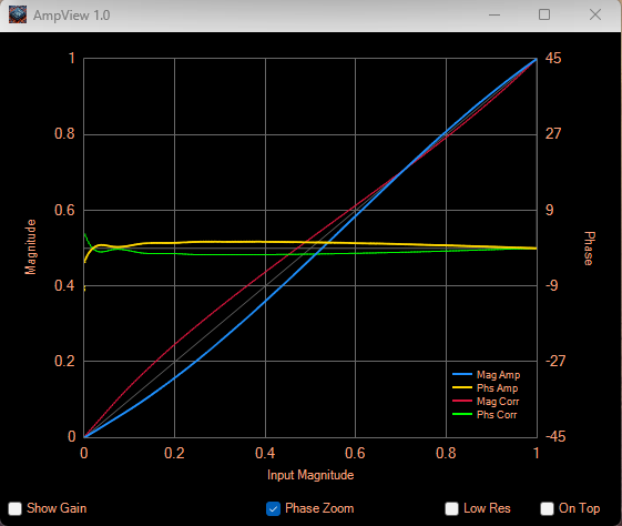

Great idea! I was so fixated on the changing two-tone graphs. Here's 75 meters voice at 54 watts peak:
75 meters voice 54 watts peak.png (37.36 KiB) Viewed 154 times
Here's 15 meters voice 44 watts peak output with gain curve followed by two-tone test with gain curve:
15 meters voice 44 watts peak.png (36.66 KiB) Viewed 154 times
15 meters voice gain.png (27.91 KiB) Viewed 154 times
15 meters two-tone.png (38.87 KiB) Viewed 154 times
15 meters two tone gain.png (32.54 KiB) Viewed 154 times
Maybe an issue of sorts with two-tone? Voice plots look ok to me. The results are essentially the same on 160 - 10 (didn't test 6). 15 is extremely good, settling in between -60 and -61 dBc for two-tone third order IMD even with the weird squiggly plots.

I asked about the voice calibration because I had read somewhere in this forum that some amps don't like some combinations of two-tone frequencies. Your 15 meter curves suggest you're using frequencies your amp doesn't like.
One nice thing about PureSignal is that it will calibrate perfectly fine to any combination of tones, so I decided early on that I'd just let PS use my voice for calibration, and consequently haven't used two-tone in years.

The "squiggly" waveforms are generally indicative of either a hardware issue (cable, amp, etc.), or bad data, which again would be due to a hardware issue (cable, coupler, etc.).
It's very unlikely the versions of Thetis and firmware you are running have anything to do with this. Also, without having an external amplifier, we can dismiss tone selection as having any bearing on the problem. The standard 700 and 1900 Hz tone pair should be fine.
Before looking for "zebras" (something rare and unusual) try looking for "horses" (boring and mundane). VSWR is obviously not a core issue, since this problem occurs into a dummy load. But are all your cables healthy? Any loose RF connectors on the back of the 7000? What do your station's grounding and bonding provisions look like?

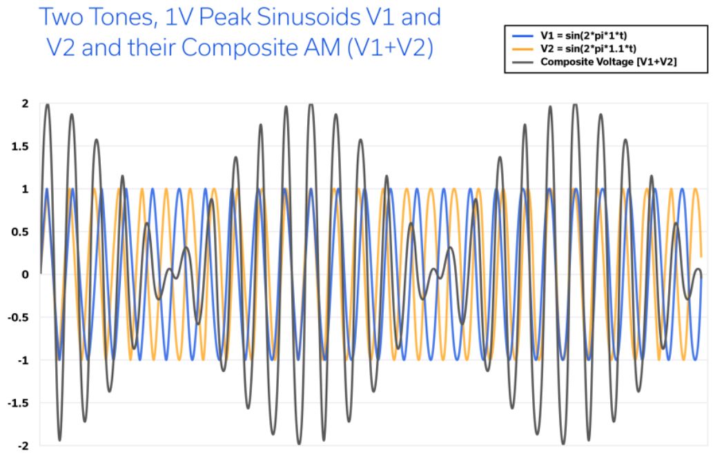

Finally, the dotted or dashed characteristic of the lines is not a problem and need not be addressed. It is typical of a any two-tone waveform. When two tones are combined, particularly non-harmonically related ones as is the standard for two-tone measurements, the two waveforms will combine such that there is an AM modulation imposed per the mathematical relationship as shown in the following figure below. This causes the dotted characteristic as shown on the ampview display.

Finally, and not really relevant, but fun to discuss, is how to modify two-tone settings so that you get the same behavior and benefits without "singing the song of our people". :D You will find that a tone combination of 70 and 190 Hz is useful for all of the above except formal testing and sounds quite subtle on the air compared to the standard 700 and 1900 Hz tone pair.
