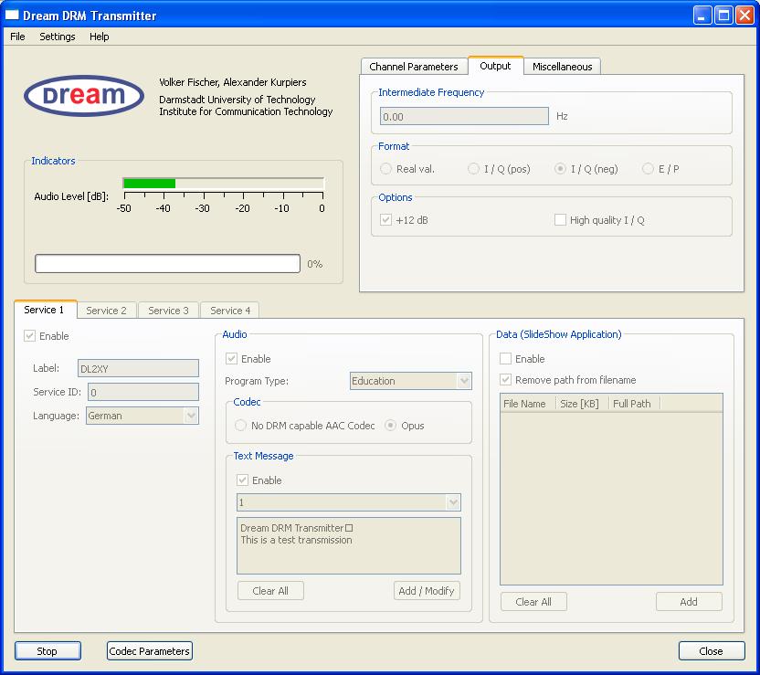

Re: What form is IQ VAC?
Scott,w-u-2-o wrote: AFAIK, MultiPSK and Dream only receive IQ, they do not transmit it.
I'm not sure about IQ-tx in Multipsk (IQ-rx is supported) , but Dream definitly can.
Just start it "dream -t" to get in tx-mode.

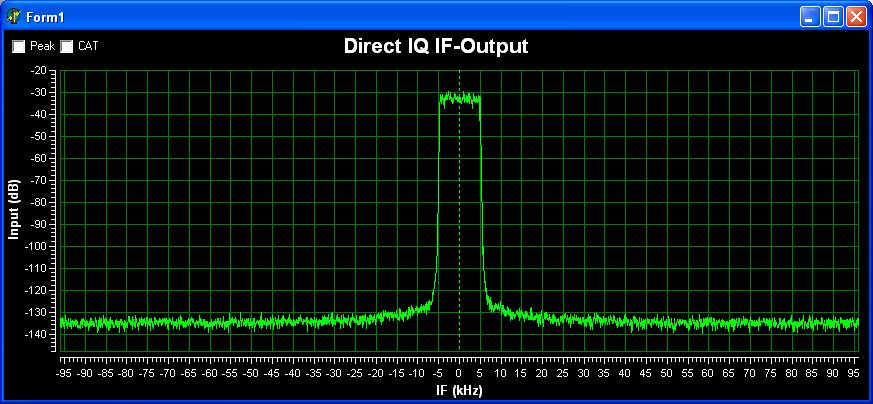

This is a 10kHz wide DRM signal output by Dream displayed with one of my diy-tools via VAC.
By the way, this ist a hard test for Puresignal, the 20kHz version is nearly impossible to transmitt with reasonably low IMD.
