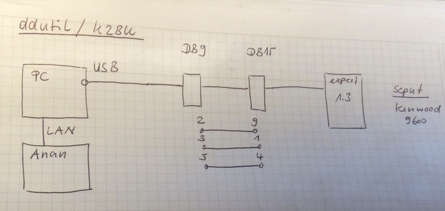

Hi folks,
got a problem connecting the Expert 1k3 to the Anan 200d. Wiring is like the chart.
Expert cat config:
Kenwood, 9k6, Input 1
Vspe:
Com7 connector
Com7 com 17 Splitter 9k6, Stp bit 1
Emulations on
Hpsdr cat Catcontrol :
Enable hacken,
Port com 7
9k6
Sop bit 1
ID as power SDR
Ddutil:
Setup Features:
Legacy com 17
Setup Amps:
Spe, 1k3,com 4, enabled
PC :
ATEN usb to serial bridge com 4 in Windows
Any suggestions why ddutil can not connect to the amp?
73 Chris
Anan 200d => ddutil => Expert 1k3

I didn't check the pinouts, but the block diagram looks correct.
