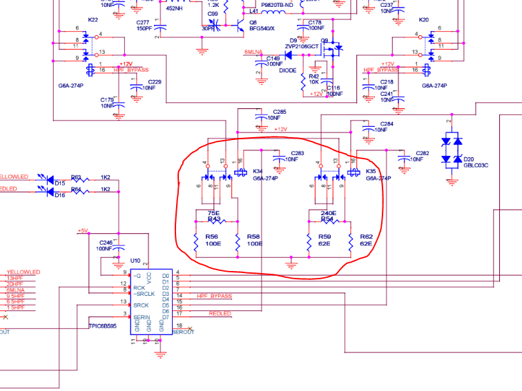

Hi All
I have a Anan-100d and when I look at the schematic on the PA & LPF I can see 2 fixed attenuator (se picture) but how / where can I control this attenuator ???? in Powersdr ???

If I remember correctly, it's been a while since I looked at this, this attenuator is used for Ext2/3 input. I believe it is 20db, if memory serves. I used to connect my low band Rx antenna to Ext2 until I found that this attenuator is switched in and there is no way I found to switch it out. I now use Ant 3 input for my Rx antenna which is not attenuated. Much better for a low signal Rx antenna.

Posts: 6109
Re: how to controll this 2 attenuator ???
This is controlled from the main console via the ATT control. 10dB selects the 10dB pad, 20dB selects the 20dB pad, and 30dB selects both. If you select more than that the software starts to add in attenuation from the step attenuator IC on the SDR board itself.
If you want finer grain control than that, simple double click ATT and it will change to S-ATT. Then you are using the step attenuator, which will provide between 0 and 31dB of attenuation in 1dB steps.

Scott is, of course, correct. My mind is just not right.
