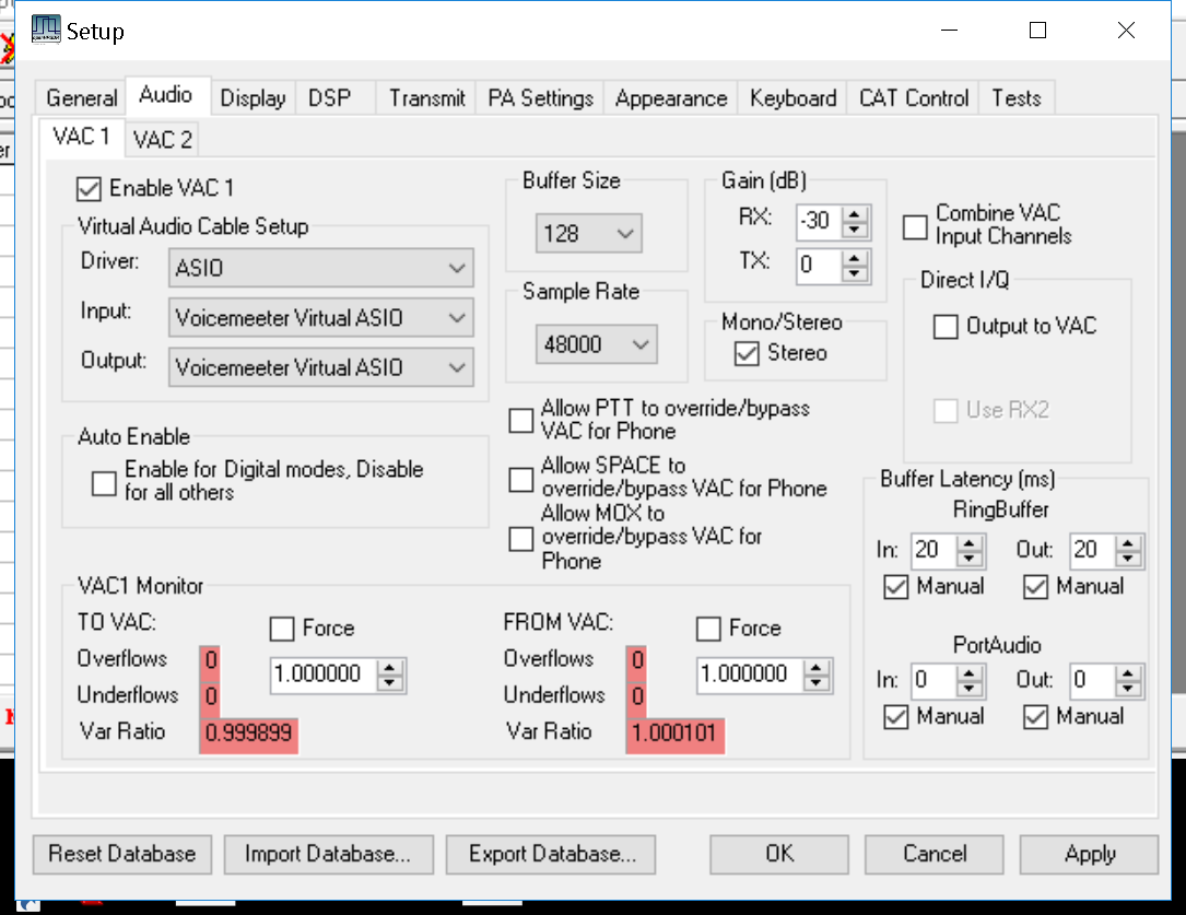

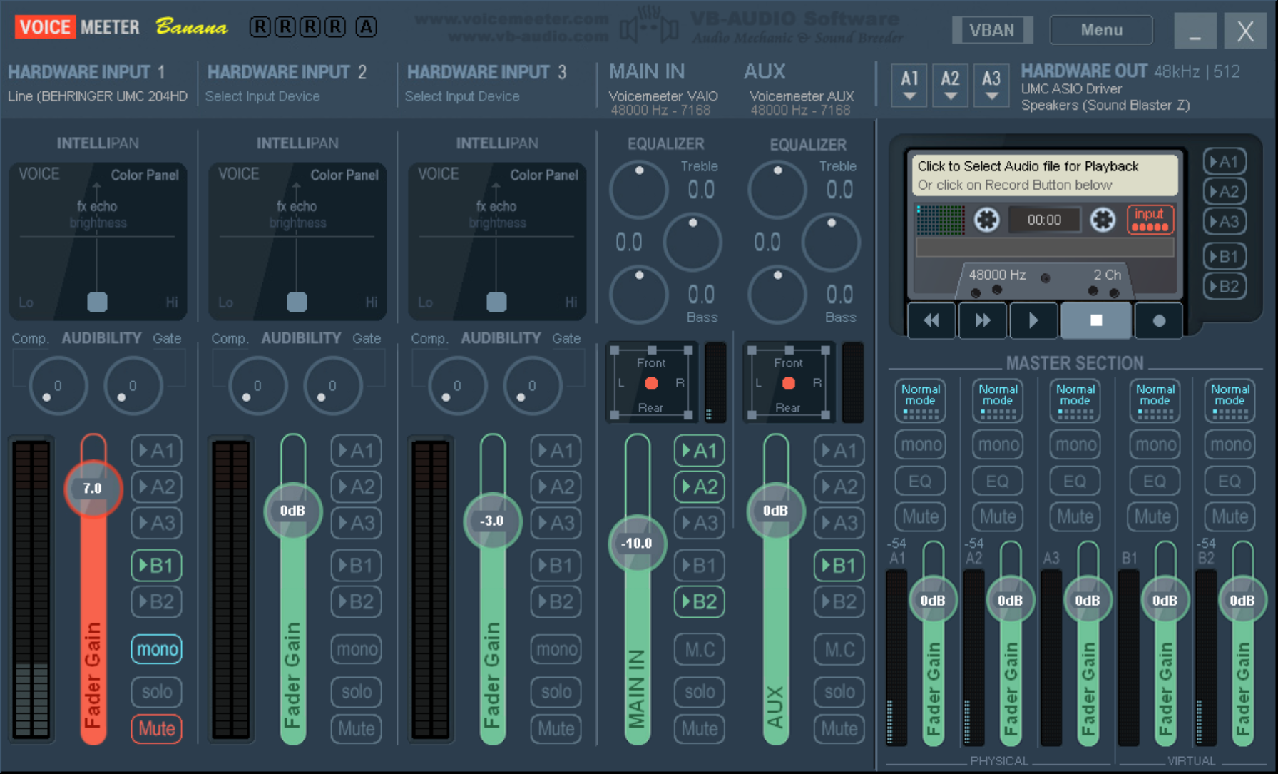

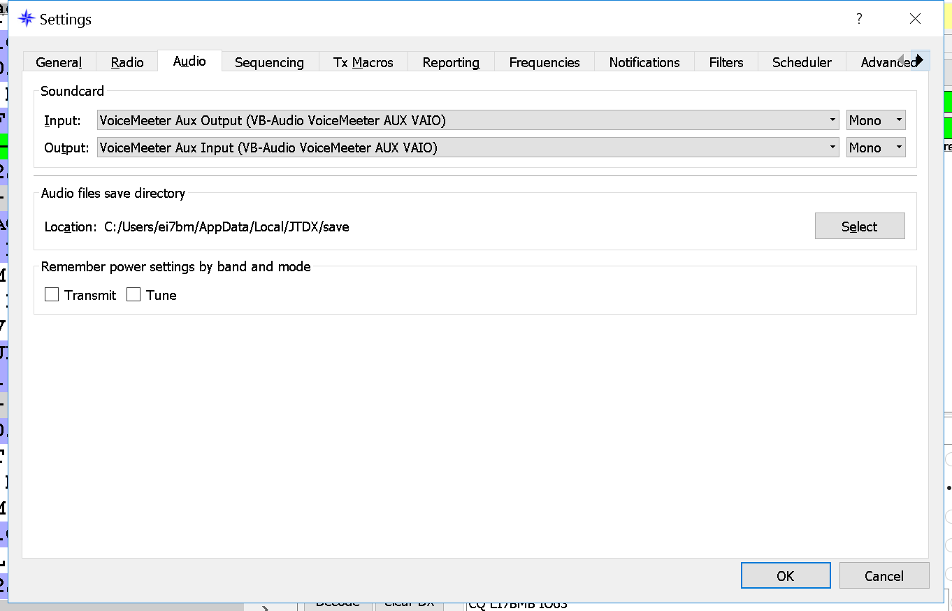

Re: Best AGC for digital modes?
Hi Scott , please see attachments on this and the next post, limited to 3 per post it seems.
- Voicemeeter UI.png (468 KiB) Viewed 31636 times
- VAC Audio set up.png (126.42 KiB) Viewed 31636 times
- JTDX Audio set up.png (19.62 KiB) Viewed 31636 times

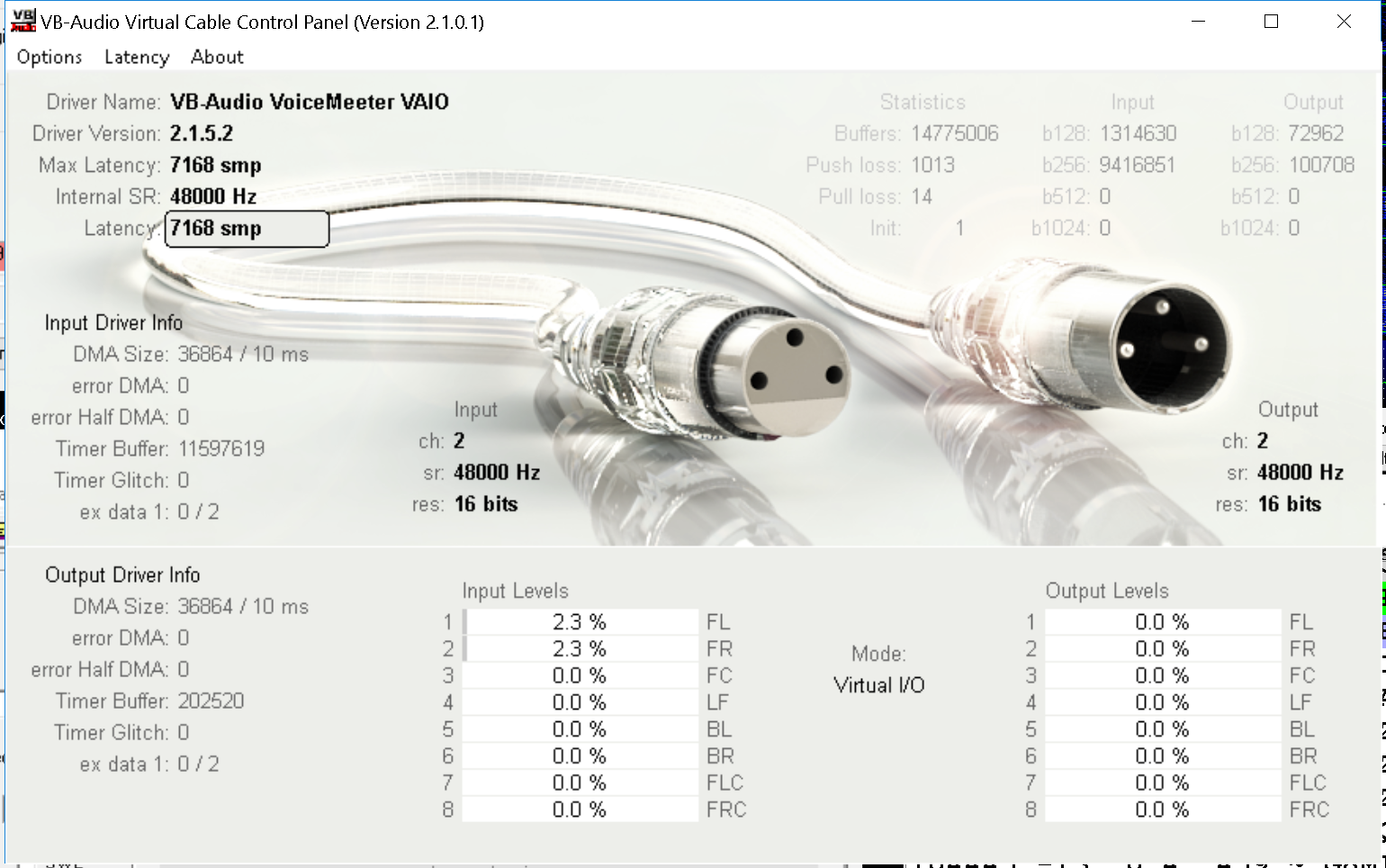

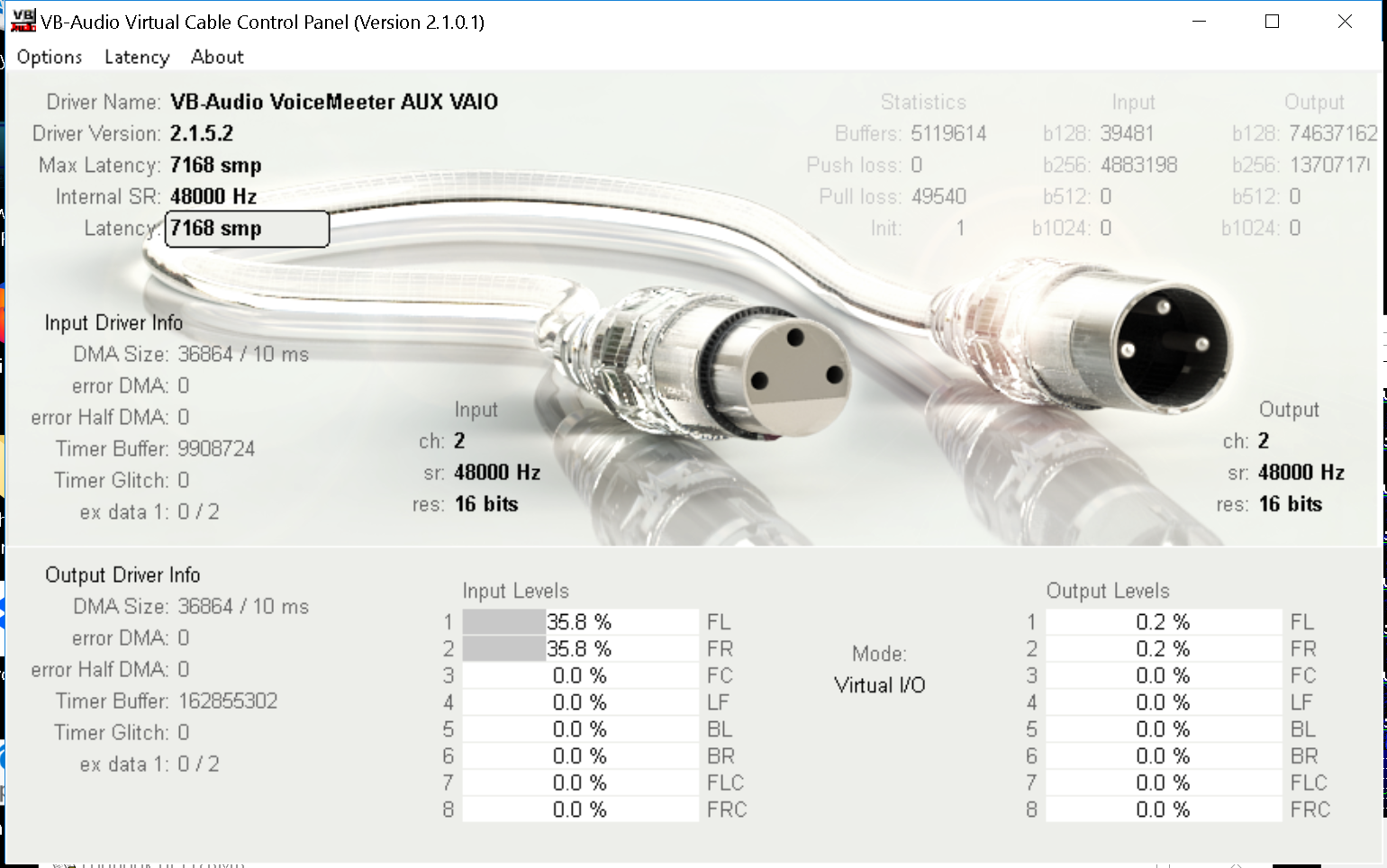

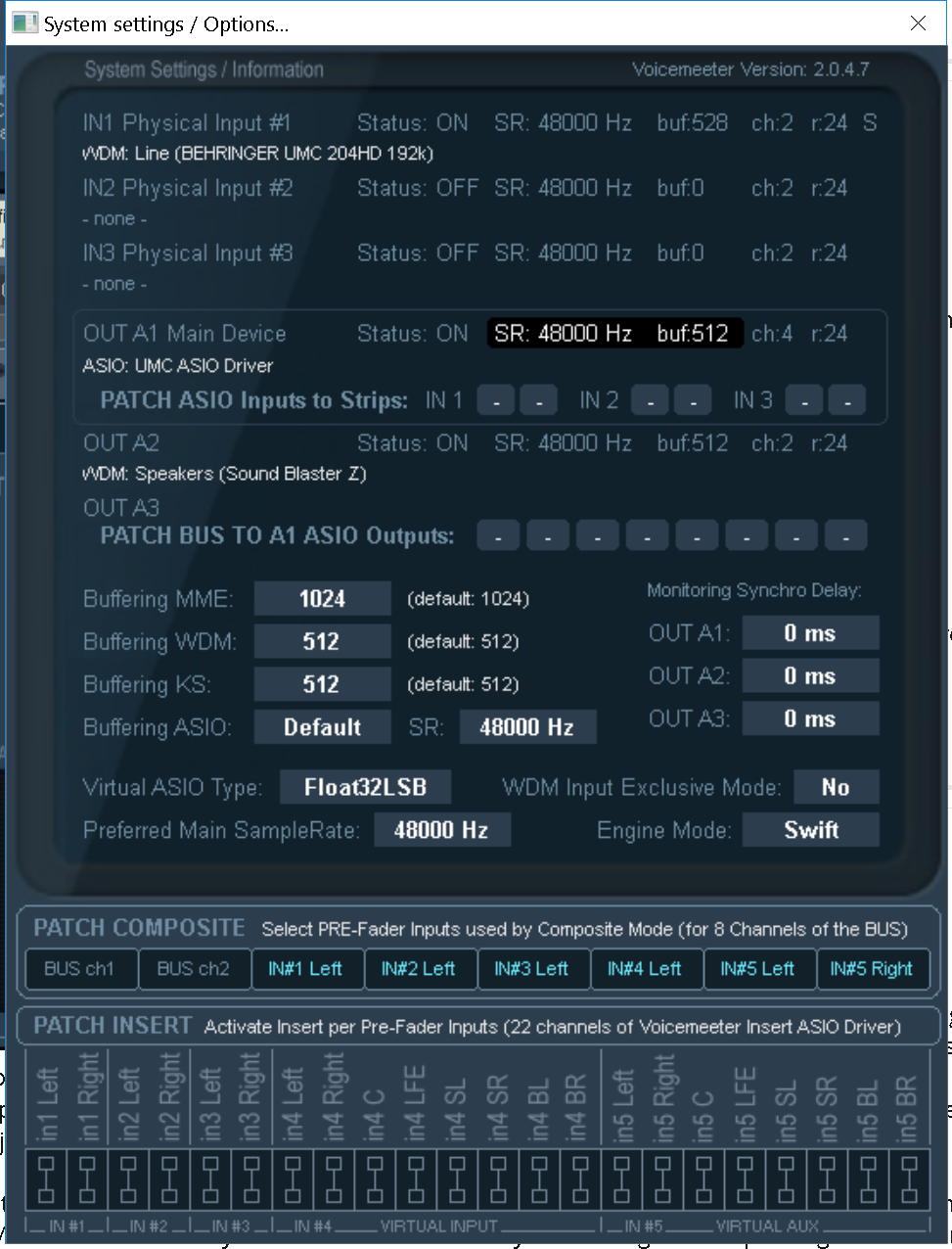

Second attachments post
- Virtual IO control panel.png (623.17 KiB) Viewed 31636 times
- Virtual AUX control panel.png (625.56 KiB) Viewed 31636 times
- Voicemeeter set up.png (312.03 KiB) Viewed 31636 times
Tony,
Your settings look perfect.
Did you check the level settings in the Windows Sound control panel?

3. Set the AGC Gain to maximum (green line will be below noise floor).
4. In VMB look at the metering on the Virtual Master channels. You should not see any red segments lit. Push up the gain slider on the master until you just barely see red (the first red bar is +1dB). You should only need a dB or two to get that. That shows you that the level coming out of Thetis is just a hair under 0dB under these conditions. If you get these readings everything is OK. If you don't then something is wrong somewhere. Look also at the numerical peak readings just above the meter. Again, they should be right around 0dB.
5. Now select a strong SSB voice signal. Set AGC Gain to a few dB above the noise floor (green line just above the noise floor).
6. Repeat step 4. You should get the same results. Again, if not, then something is wrong between Thetis and VMB.

Hi Scott., windows sound panel set to 100. On quiet part of band with AGC at max I need to increase slider to 2.6 to get the first red bar to show . I can then go to a strong signal and get the red to appear again with AGC just above the noise so perhaps I'm making progress ?
If that is with RX1 AF set to 100 and VAC RX gain set to 0, then that sounds pretty normal.Tony EI7BMB wrote:Hi Scott., windows sound panel set to 100. On quiet part of band with AGC at max I need to increase slider to 2.6 to get the first red bar to show . I can then go to a strong signal and get the red to appear again with AGC just above the noise so perhaps I'm making progress ?
What happens if you put a noise floor into JTDX with all VMB sliders at 0, RX1 AF set to 100, VAC RX gain set to -30dB, and AGC gain set so the green line is 20dB above the displayed noise floor? What audio level do you get in JTDX?
Scott in that scenario JTDX reads 54db on the audio level indicator
Interesting. I don't have JTDX (and have no interest in installing it). Using WSJT-X, under the same conditions I get 39dB into WSJT-X, which 15dB different than you.
At this point I am at a loss to explain where that 15dB difference is coming from.

David MM0HVU on the JTDX mailing list has confirmed there is indeed a difference in how JTDX measures
"Indeed the difference shouldbe around that or 12 ish, JTDX measyres input at Peak signal level, WSJT-x is measuring RMS level which will show around this difference"
"also anywhere in the range (colour coded) from around 40-80ish is fine for input as this will leave enough headromm for strong signals I would think, and using AGCc and AGC on radio will also assist and cannot be shown to have any negative side effects form using AGC."

I think I might have this sorted out.w-u-2-o wrote:Interesting. I don't have JTDX (and have no interest in installing it). Using WSJT-X, under the same conditions I get 39dB into WSJT-X, which 15dB different than you.
The peak-to-average-power ratio (PAPR, or "crest factor") of atmospheric noise is not an exact science, as it will vary depending upon atmospheric conditions. However, the rule of thumb on this is a factor of 8, or 9dB (10log(8)).
I am also going to take a wild guess and say that the JTDX audio implementation sums a stereo input. When you sum a stereo input consisting of two identical mono signals, the signal level will increase by 6dB.
6dB + 9dB = 15dB.
Try switching your feed to JTDX to mono, either by switching to mono in PowerSDR VAC, or perhaps by fussing with your settings in Voicemeeter. You might easily get back that 6dB.
Scott mono/stereo makes no difference
OK, so now it's a 6dB mystery. But I bet that mono is still being converted to stereo somewhere. Maybe even in JTDX.
Yeah quite possibly although David above did mention that it measures differently than WSJT X. With the set up I have now Ft8 seems to work really well , even got a new DXCC on 6m yesterday from Iraq
