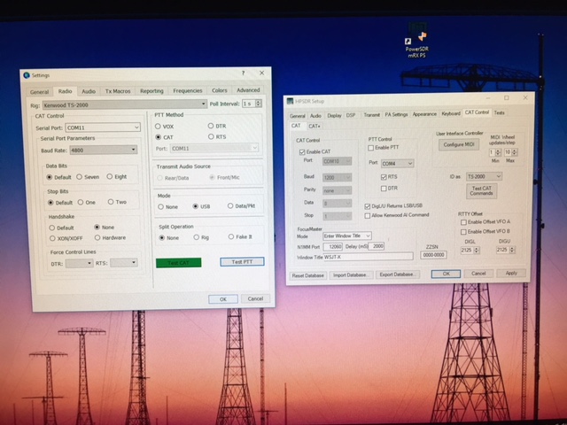

I must have done a few dozen of these configs with no problem. Here, attached, is my current config for WSJT-x. I have almost complete rig control. I say almost because I can't get PTT to work for some reason. I can change frequency using WSJT and, of course, I am decoding. What am I missing here? Also, the same problem with FL Digi which is no PTT. I also have band control and decoding capability for that software.

What do you have for PTT Control in the CAT Control tab in PowerSDR?
Enable PTT should be off.

Enable PTT is off in the CAT Control Tab. I am using virtual cables from VSPMgr which I have used for about 3 years now.

huh? Its been a long while since I first set it up but I don't quite get why you both say/agree that Enable PTT should be OFF! It has to be on - or at least it IS on for my situation and it is configured from within WSJT to use it as a (separate) com port.

I do believe you only turn that option on when you have PTT on a separate COM port.

"Enable PTT" in the PowerSDR CAT setup is only necessary if you are using serial port PTT. Since you are using CAT PTT this doesn't matter, on or off.
"ID as" in the PowerSDR CAT setup also should not matter, it should work set to TS-2000 or PowerSDR.
What version of WSJT-X are you running? I'm running 1.8.0-rc3. My radio setup tab does not look like yours. I do not have a "default" setting for data bits, stop bits or handshake.
I would suggest you change your baud rates to match (even though it's not supposed to matter on virtual cables), and explicitly set data bits to 8, stop bits to 1, parity to none and handshake to none in both programs (where possible).

I did change those settings, as noted, and it worked! Thanks again.

Mark...could you do me a favor and change WSJT-X back to using "default" where you can select it?
It should still work.
If not then something else is wrong.

Thanks your help. It is working correctly now. I have been using WSJT-x since I had my FLEX 3000 4 years ago and just couldn't figure what I was doing wrong.
