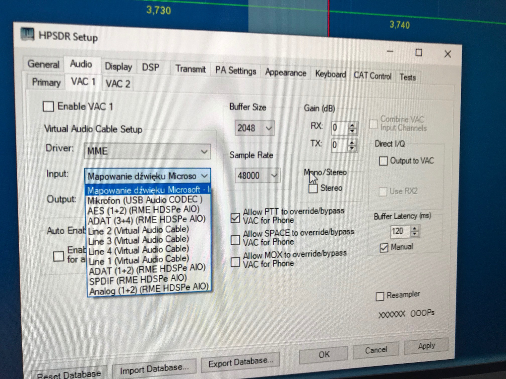

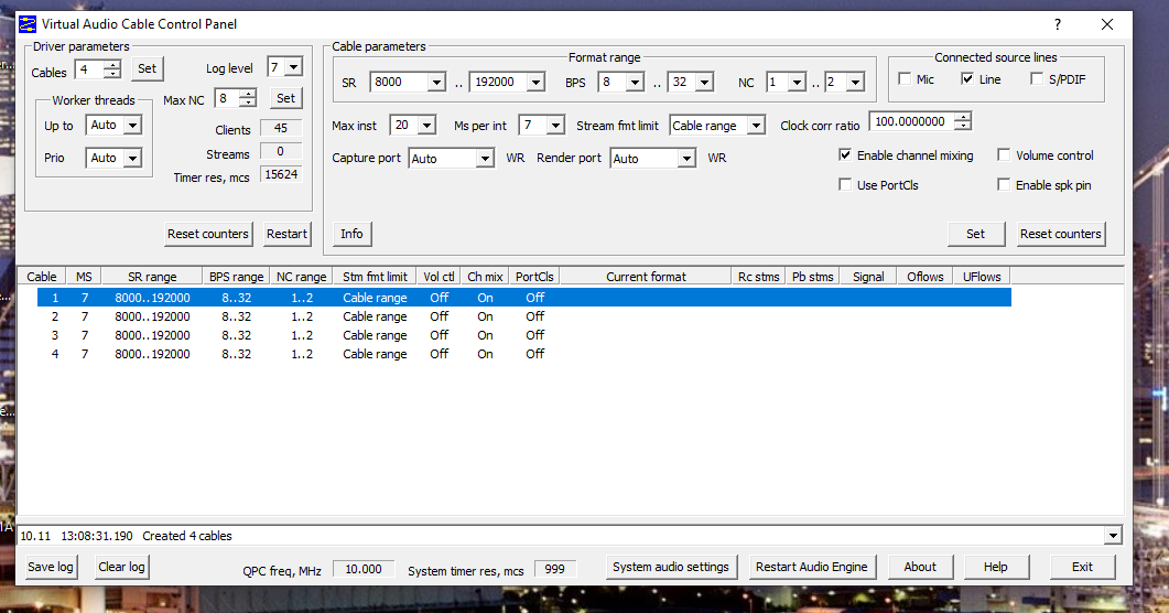

Hi,I installed 4 Virtual Audio Cable-Muzychenko. In the Power SDR - audio-VAC setup I choose the MME driver. The input is only Line 3 and line 4 (VAC). The output is VAC 1, VAC 3 and VAC 4 (VAC). This is probably not correct. Which ports should I choose in input and ouput VAC1 audio setup in HPSDR?

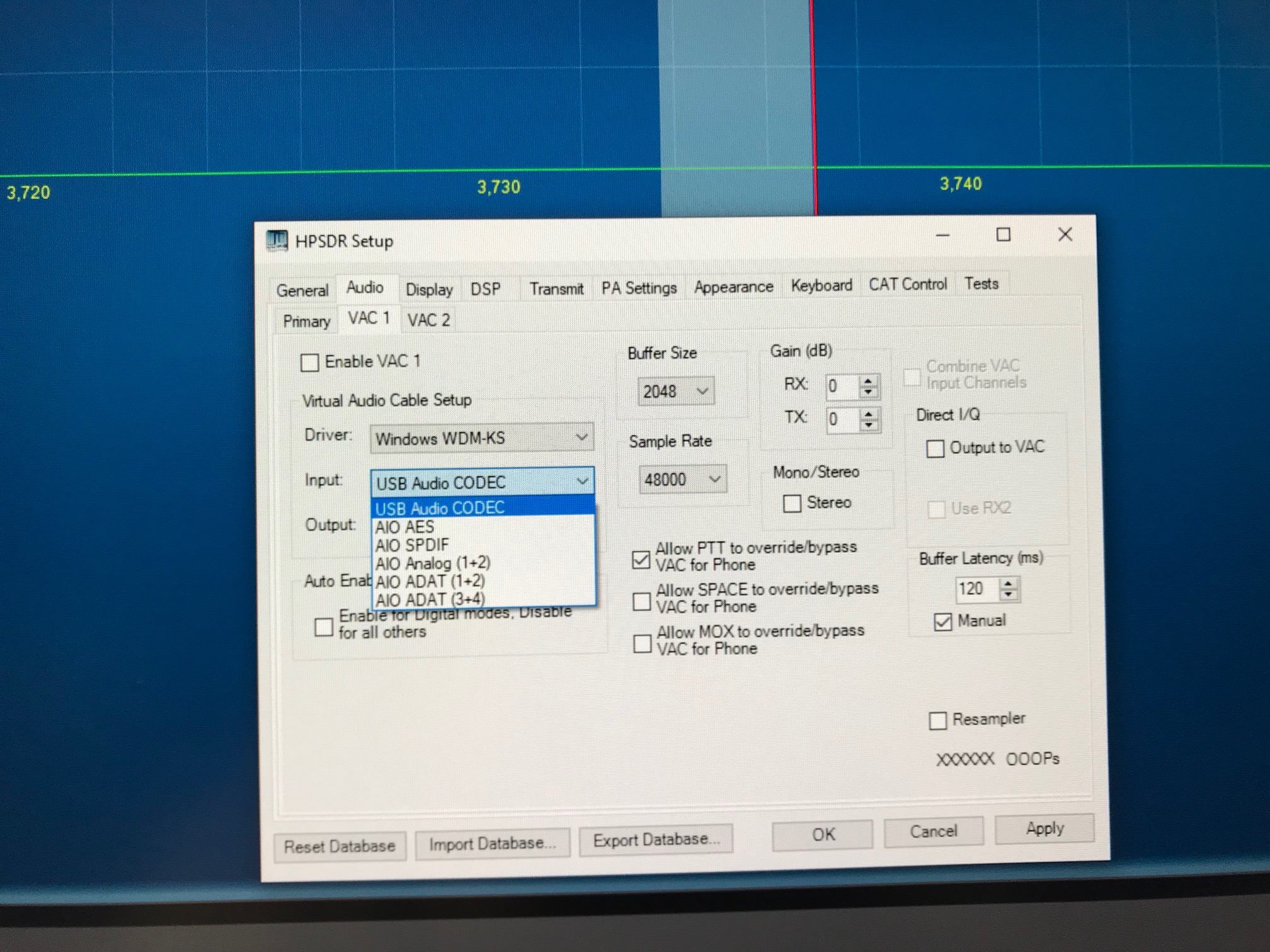

thank you for your answer. I have partially solved the problem. Audio drivers after the WIn 10 update did not work properly. I can already see 4 virtual cables in the HPSDR setup. But only you can see them when the MME driver is enabled. When I turn on the Windows WDM-KS driver, there is no VAC in the input and output window. Maybe this is a problem of the Muse VAC program. WDM-KS is also in the older version. I send screenshots.

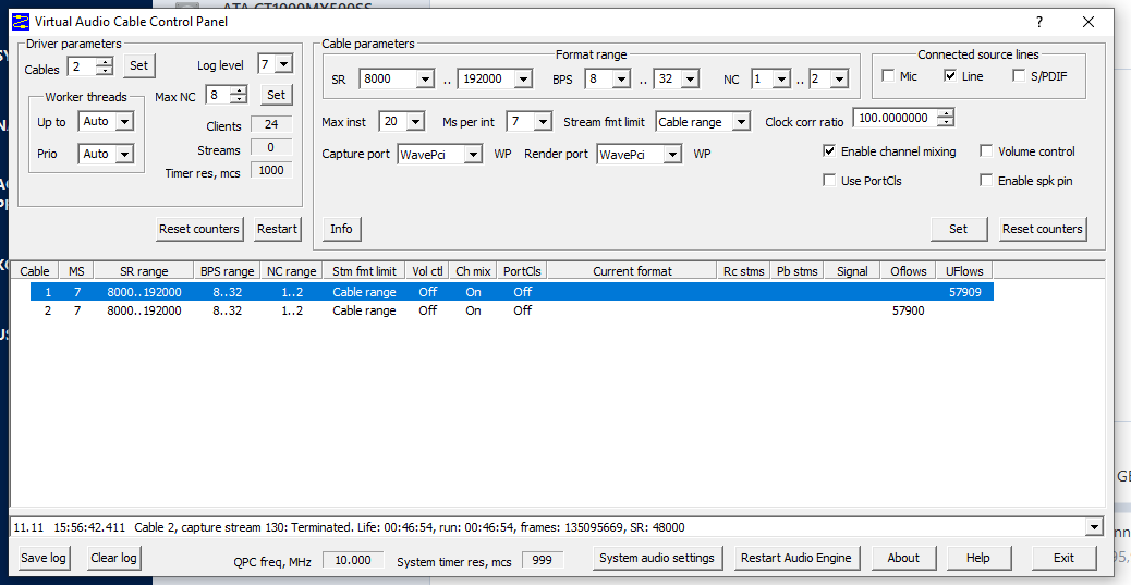

Hi Scott,problem solved. By default, the new version of VAC Capture port and Render port is turned on "auto" I changed to Wave PCi and now everything works ok. In the Window WDM-KS driver in the input and output tab virtual cables are visible. Everything works ok.
Thank you for the advice. Best wishes.

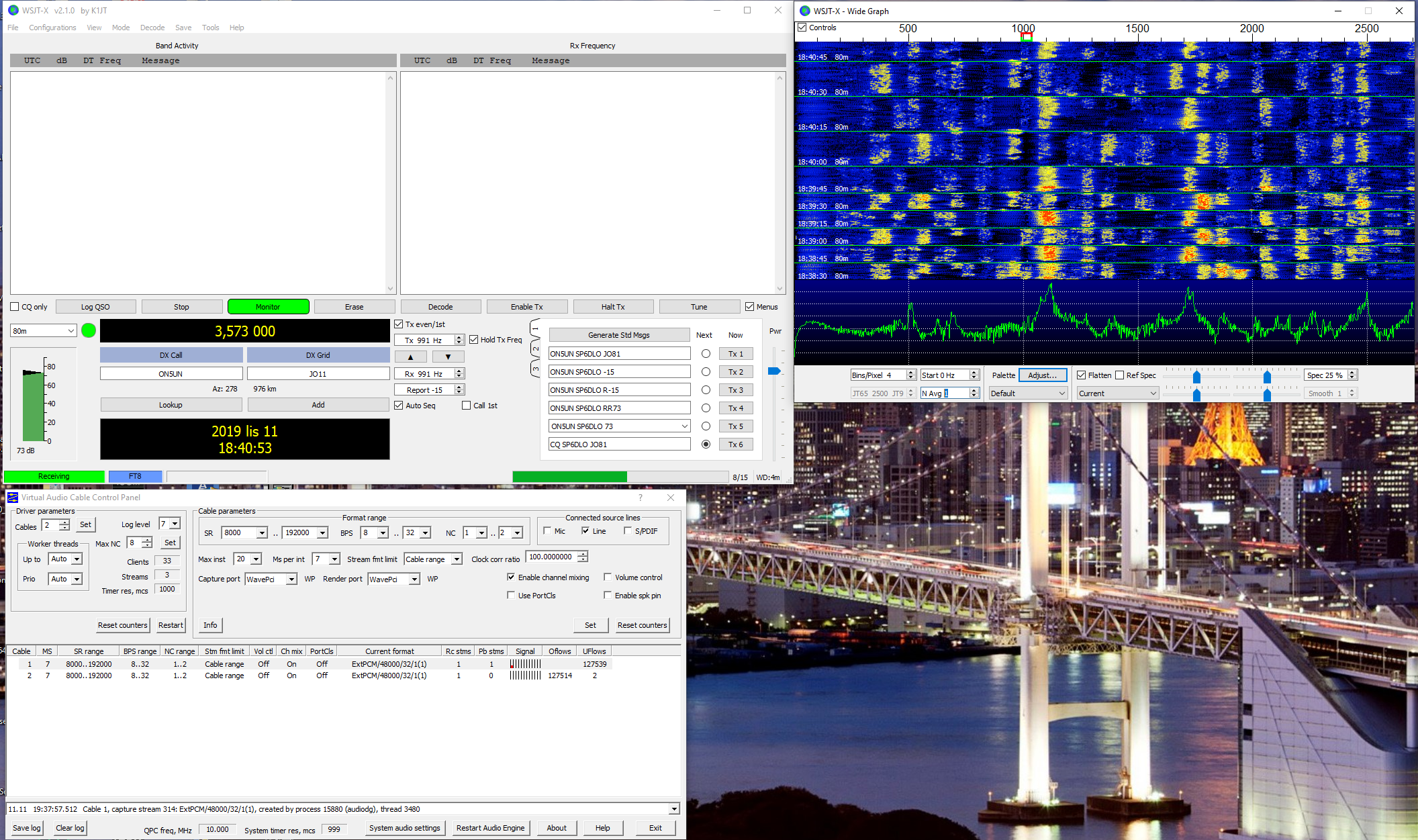

after VAC configuration I turned on WSJT-X. The Wide Graph shows working stations, the reception level in the Ban Acitivity window is about 70% and there are no working stations. I have enabled CQ and correspondence can see my sign. A few people called me but I didn't see them in the window. I don't know what I did wrong in HPSDR or WSJT-X configuration. What can I check and change to correctly receive stations and work on FT8?
Slawomir

Hi, I solved the problem. I had to change Driver WDM-KS to MME and everything started to work properly. I don't know why WDM-KS doesn't work. Various configurations are shown on Youtube. Only MME works for me and I will leave it that way.
