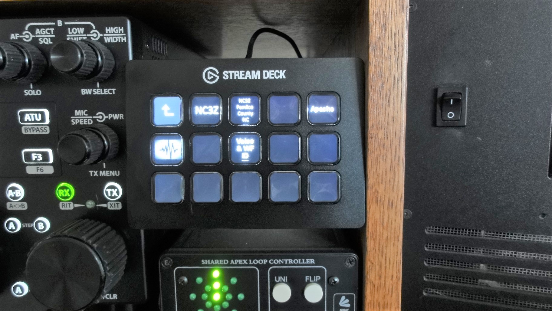

Been playing around with the StreamDeck 15 I had been using with my Flex 6600M and now using it with Thetis to send canned voice ID's and waterfall ID's with a single button press.
Using a combo of SerialSend command line and SoundDeck commands in StreamDeck to key my 7000DLE, play a wav file via a designated Audio Device (VAC), and then unkey the 7000.

Ha! It was just more that I wanted to see what I could use it for that had wished was there. The WF ID is just fluff but kind of cool. just have to cobble a few things together but the Stream Deck is pretty handy to do this.

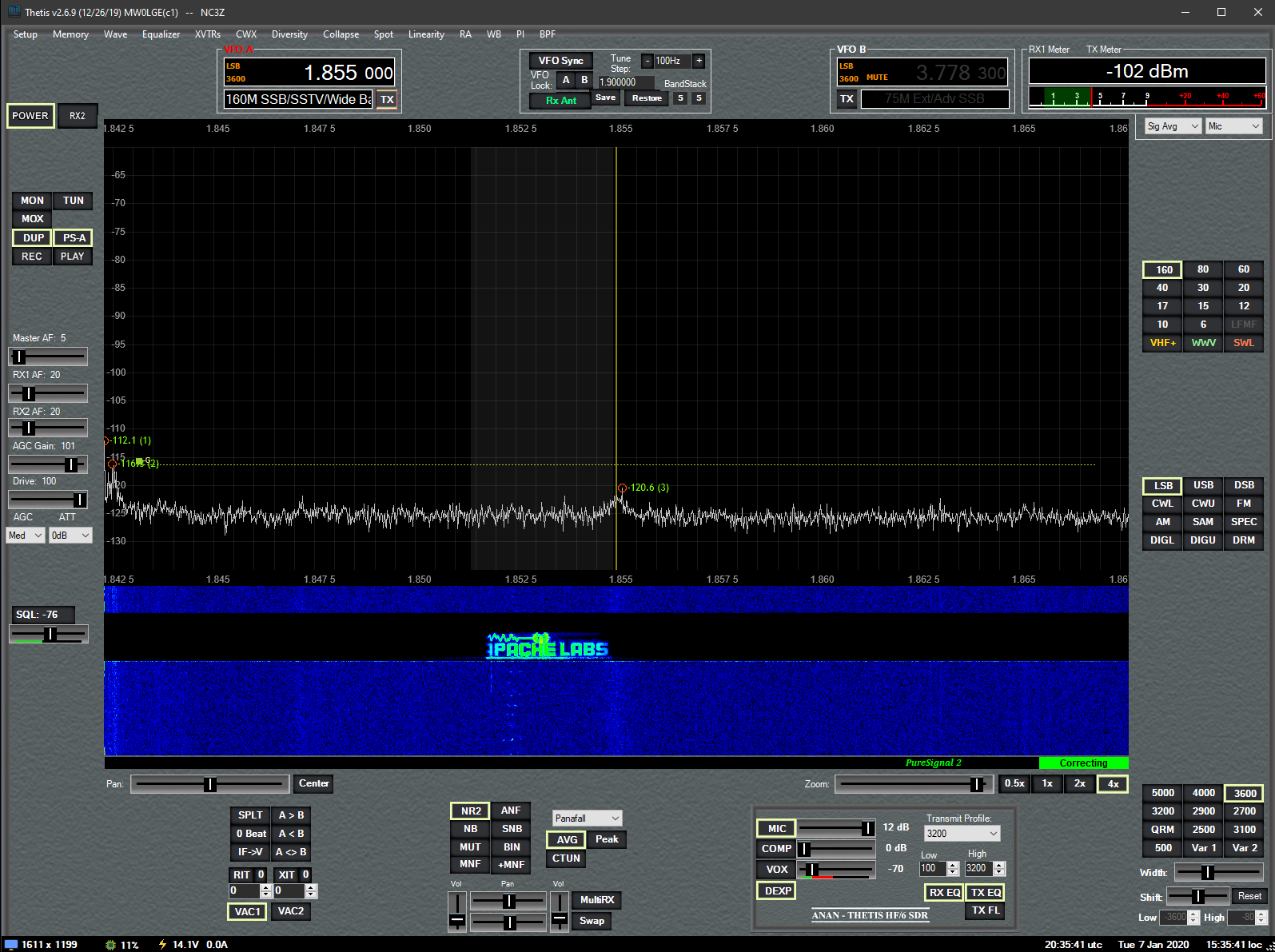

That is a really slick implementation Gary. This screenshot is from yesterday's chat. Hard to miss that in the waterfall! Congrats on hearing (in spite of the splatter from the QSO down below us) and working EI9O last night!
