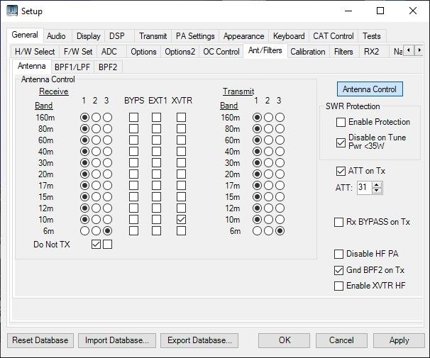

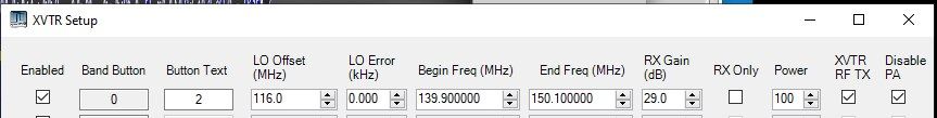

I use a ANAN-7000DLE with a Kuhne TR144-PRO, IF 28 MHz. Two IF-cables connecting XVTR (out, SMA connector) with IF-in on the xvtr and XVTR IN (BNC connector) with IF-out on the xvtr.
Settings are as shown on the screenshots.
No problems here! PA is switched of. I used the LT2S xvtr with my old ANAN-200D, but I don't know if I tried procotol 2 with this combo.
