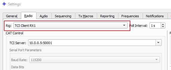

With help from Richie and Ernst I now have JTDX running for CAT and PTT. Thanks guys

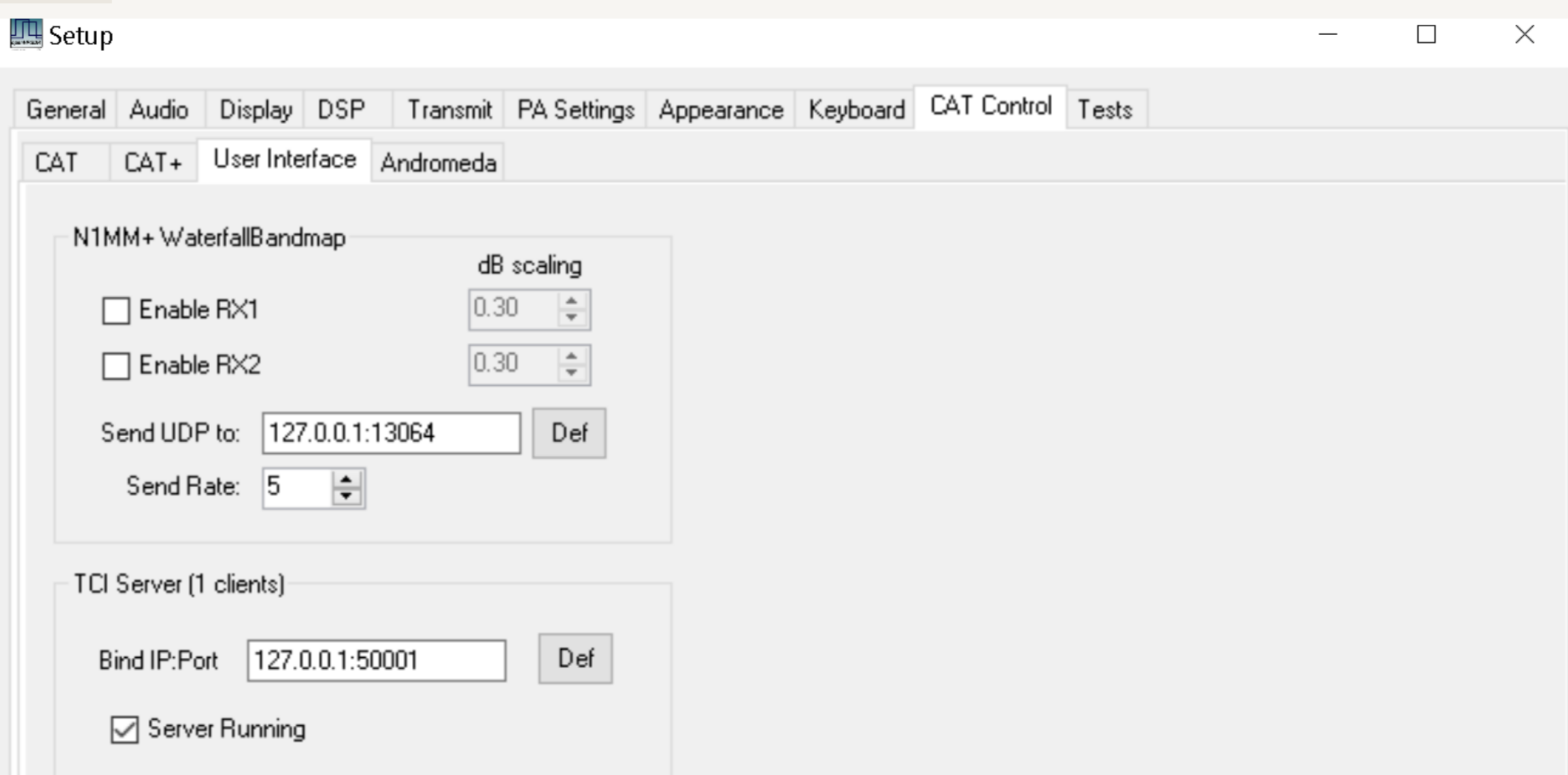

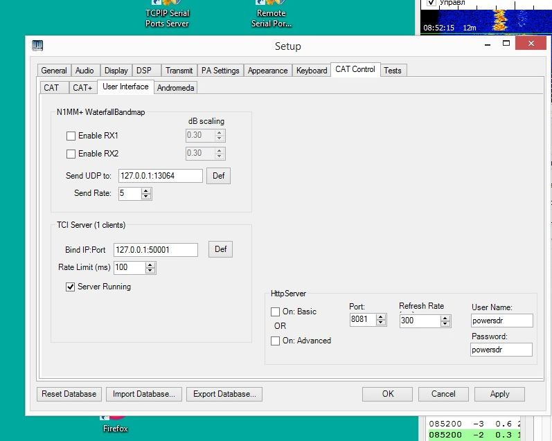

In the same place here on K9 pre 8w2ner wrote:Screen Shot 2022-02-15 at 10.47.05 AM.pngRichie
Did you move the TCI settings off the user interface tab?

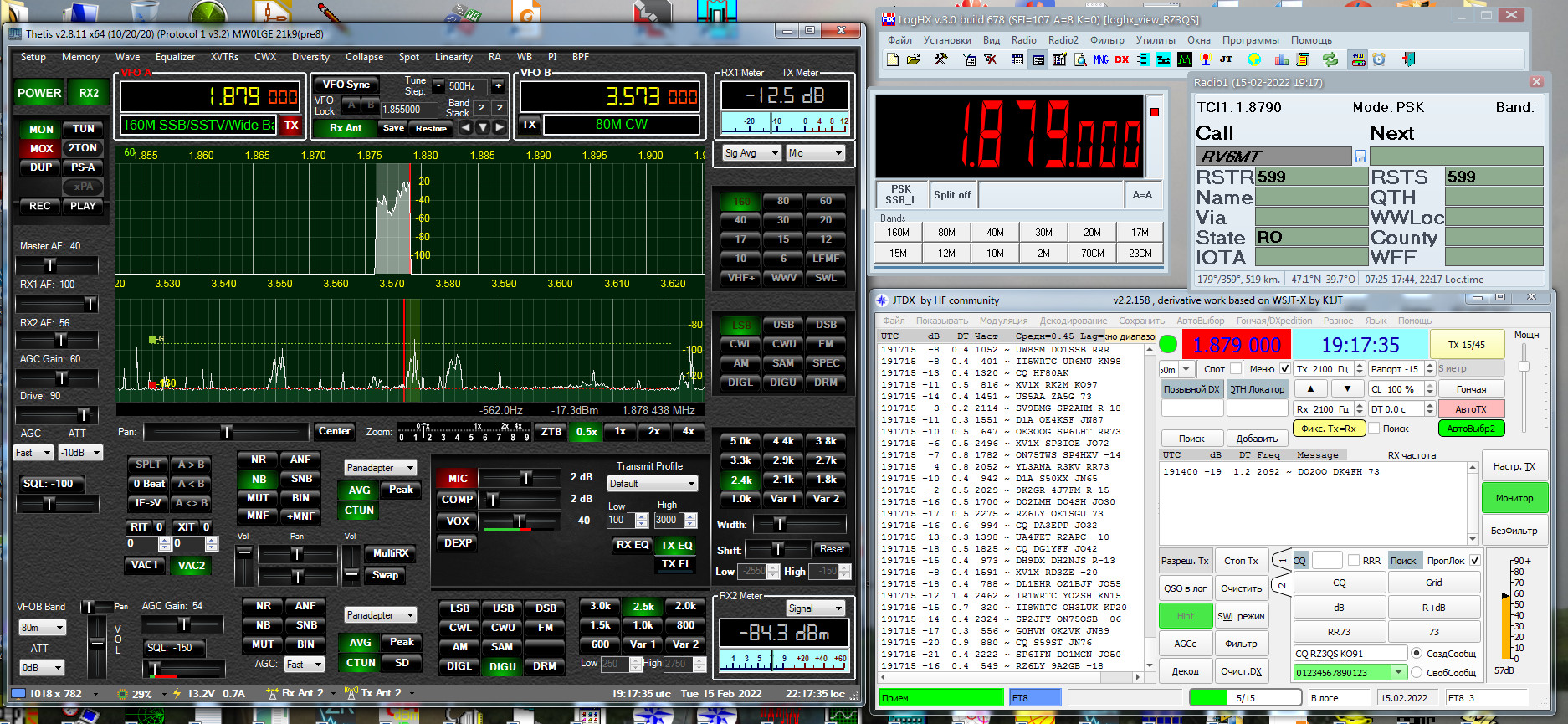

Now I am working on 160 SSB. At this time, reception is on 80 m FT8, even at the time of my transmission on 160 m.
The communication log and the JTDX program are connected to Thetis via TCI.
Again, I may have made mistakes in this matter.

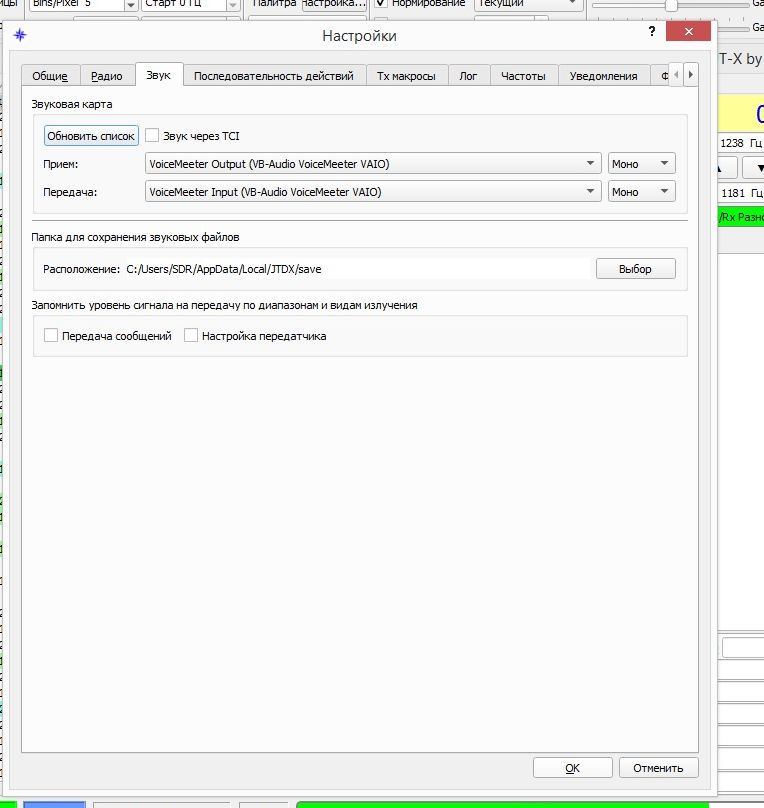

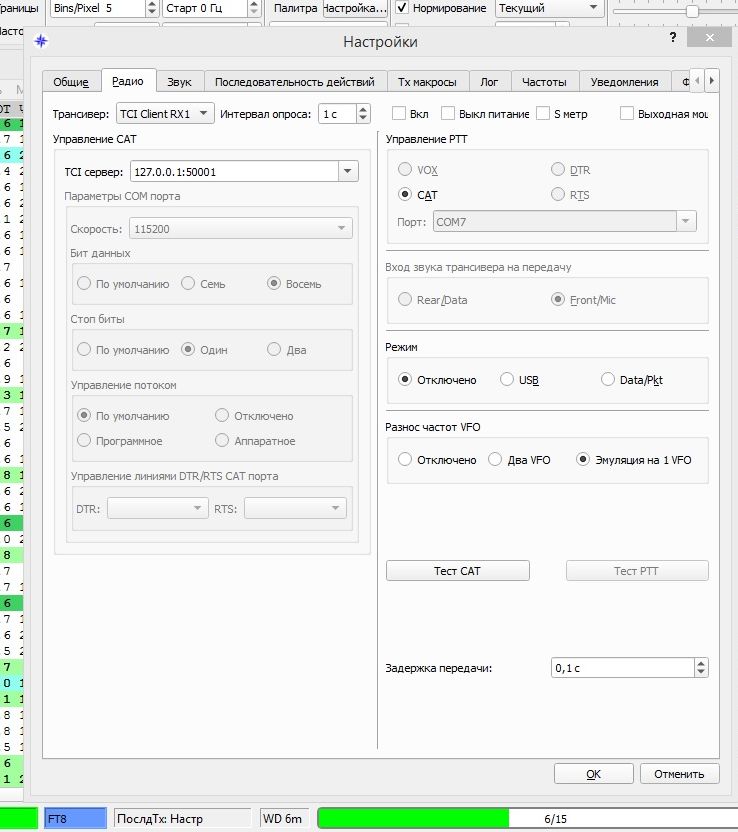

Problem. When communicating with TCI, JTDX does not work for transmission through VAC. Reception is working. When the settings are changed to CAT, transmission via VAC is resumed.

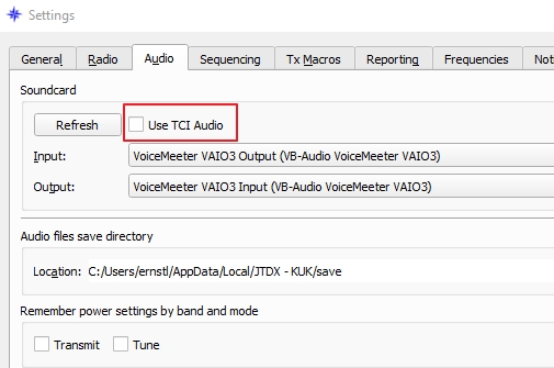

Do you have TCI-Audio enabled? That would not work. TCI-Audio is not implemented yet.RU6AI wrote:Problem. When communicating with TCI, JTDX does not work for transmission through VAC. Reception is working. When the settings are changed to CAT, transmission via VAC is resumed.
Activating TCI as transceiver interface (instead of OmniRig or hamlib) has no influence on the audio in/output.
https://www.oe3ide.com
No... Everything is the same.
- 111111.jpg (49.11 KiB) Viewed 24764 times
When I switch the transceiver control to TPI, the audio signal for transmission disappears. Everything is fine with the reception. As soon as I switch back to CAT, everything returns to normal. I don't change the AUDIO settings
yep make sure use tci audio is checked off, and you hit refresh to get the audio devices listed, then select suitable ones
That's exactly what I did .. I did not connect AUDIO TCI and did not change anything ..
vac is set correctly in Thetis? Mute the vac? gain level? rx1 af level ? Line 1 + Line 2 set the correct way around to match the in/outs?
Yes..When switching to CAT everything works fine.
cant explain it, works fine here. TCI audio off in JTDX, and audio devices set to match those in Thetis.RU6AI wrote:Yes..When switching to CAT everything works fine.
Ok. Most likely something local .. I have.
latest JTDX?RU6AI wrote:Ok. Most likely something local .. I have.
JTDX 2.2.158

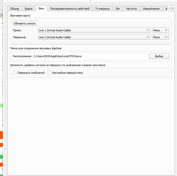

Changed the VAC program. Did not help.
- 64.jpg (67 KiB) Viewed 24564 times
- 5.jpg (85.75 KiB) Viewed 24564 times
- 4.jpg (69.65 KiB) Viewed 24564 times

@RU6AI - I cant explain it. If you set the vac device in Thetis to headset/speakers do you hear ft8 signals? If all else fails. RX levels are up, mute is off, AGC level is ok etc etc, then back your database up and try a fresh one. Stranger things have happened.
just some ideas:TDX 2.2.158
* maybe you have enabled mute? (mute works now also on VAC)
* is it only rx or also tx
* do you get audio (power out) when pressing "Tune" in JTDX
* do you "see" audio going out in Voicemeeter when pressing "Tune" in JTDX
Yes .. The same is not clear. It shouldn't be, but for some reason it is. On a regular CAT, everything works properly. I will sort this out. Thank you.
