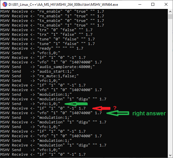

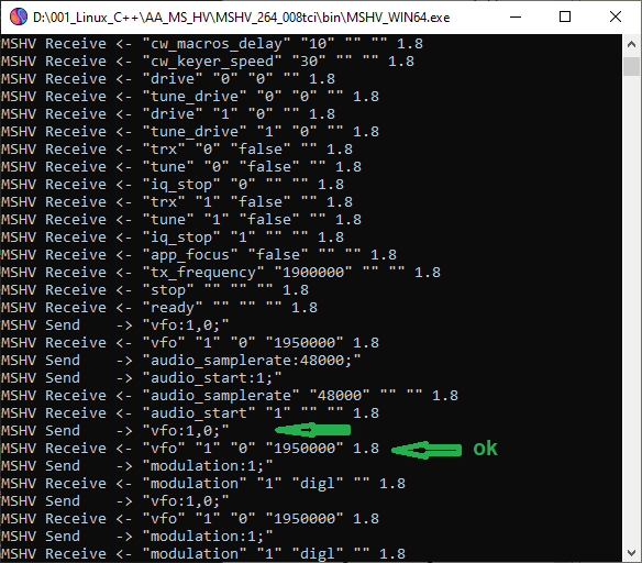

My name is Christo Developer of MSHV software.
To Developers of Thetis v2.8.11 rc4b, for TCI protocol problems.
LZ2HV Christo.

Hi Christo,
The IF message will not be returned from a VFO message query reply from 219krc5 onwards, and should be available sometime over the weekend.
Thanks for the report.

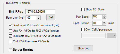

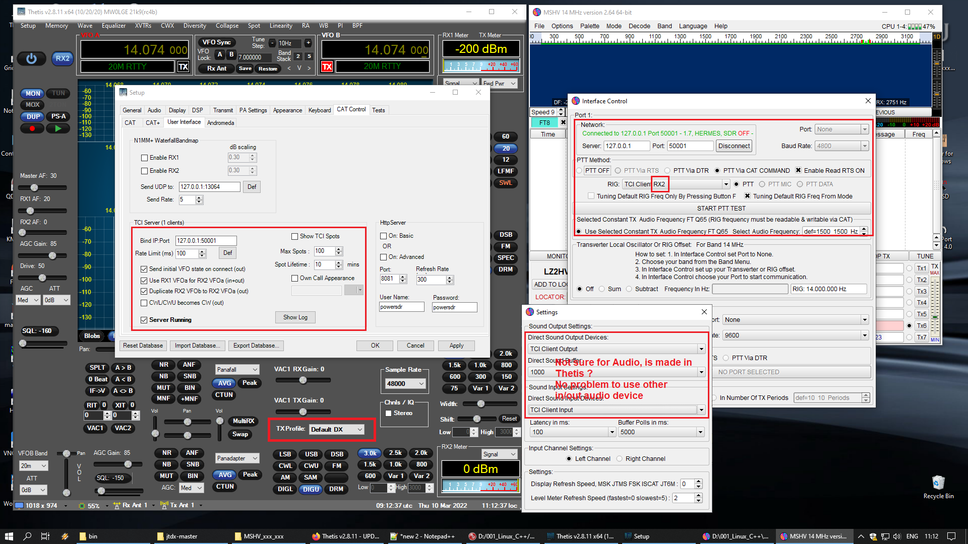

HI
Problems for the moment, in TCI connection Thetis v2.8.11 rc4b and MSHV are, see pic Settings_2.png
MSHV TCI RX1 I ask for RX1 id=0 <-> Thetis return RX1 id=-1 <- wrong RX1 need to be id=0
MSHV TCI RX2 I ask for RX2 id=1 <-> Thetis return RX2 id=0 <- wrong RX2 need to be id=1
Only working this settings in MSHV and Thetis via TCI are:
LZ2HV Christo.
Posts: 1588
yes the -1 issue is fixed, and will be in rc5 over the weekend. Remember that there is no vfoA for RX2 in Thetis at the moment, so some or a combination of those options need to be used. I will make a video of it running with MSHV 2.63 x64 around the time of rc5 release. There is no audio over TCI in Thetis.

@Christo
here is MHSV working with Thetis 21k9(rc5-test2) : https://youtu.be/ZIfI4m6G1Ao
21k9rc5 will be out over the weekend hopefully
