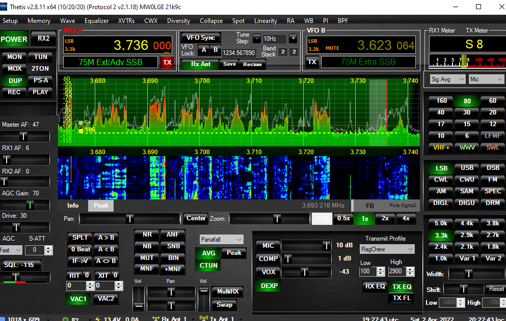

Thanks for the update Richie. Skin W2NBC scope mesh (customised) got messed up with the panadapter background colour so I'll stay with K9b for now.
Posts: 1587
Tony EI7BMB wrote:Thanks for the update Richie. Skin W2NBC scope mesh (customised) got messed up with the panadapter background colour so I'll stay with K9b for now.
Do you have an alpha set on the background colour to make it 'see through' so you can see the skin as the background gets drawn over the top of the skin background.
