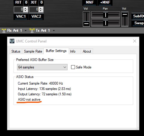

If you se in cmASIO2 picture i have set the buffer + sample rate to 4800 /64 but the ASIO do not run !!! i can only get the ASIO to run if I use the VAC (look in cmASIO3 picture...and when I start VAC it change the samplerate to 2048 ??? why ???
the cmASIO4 show the driver version
I started to run v2.10.3.5 but upgraded to v2.10.3.6 but still no sign of the "cmASIO" on the bare

- Behringer UMC info
- cmASIO4.jpg (22.61 KiB) Viewed 36482 times
- cmASIO3
- cmASIO3.jpg (42.15 KiB) Viewed 36482 times
- cmASIO2
- cmASIO2.jpg (43.57 KiB) Viewed 36482 times

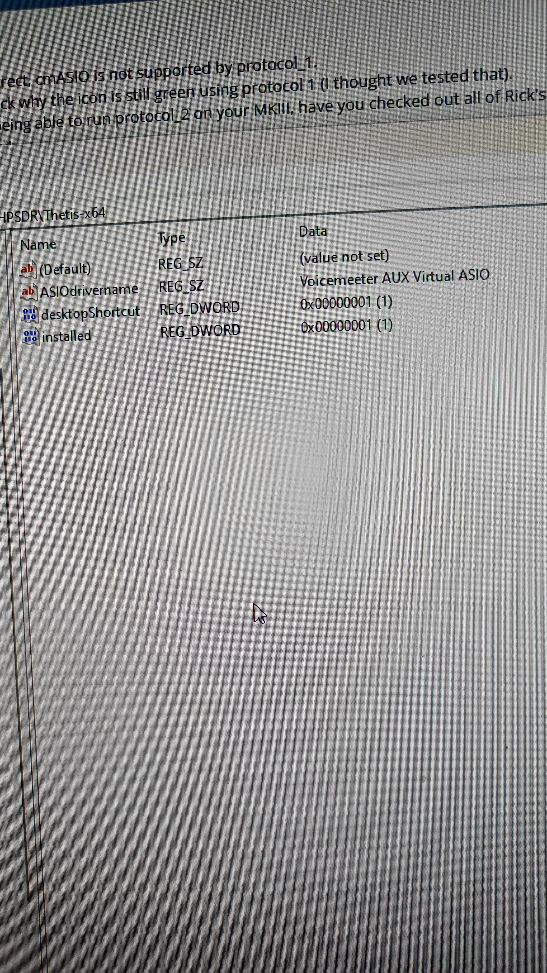

Can cmASIO be used over the internet using remote desktop software?
I have been trying to use TeamViewer and Anydesk to listen to my 7000MKII. I have been unsuccessful getting any audio via cmASIO.
Interface is UM202HD. The UMC control panel displays the correct sample rate, buffer size and ASIO as active.
UMC202HD is no longer displayed as an option under VAC
In Thetis a green cm symbol is displayed in the lower ribbon.
In sound volume mixer Thetis and TeamViewer have the output device designation "OUT 1-2 (BEHRINGER UMC 202HD 192K)"
I do have audio as soon as I select VAC1 which is set to use MME.

I've been trying to get this cmASIO working without any success. I ran hostsample and It comes up with 3 Asio drivers
driverCount = 3
Voicemeeter AUX Virtual ASIO
Voicemeeter Insert Virtual ASIO
Voicemeeter Virtual ASIO
I've tried all 3 in the registry still no green cm at the bottom of Thetis, any suggestions ?
driverCount = 3
Re: cmASIO feature in Thetis
Can you post a screenshot of your registry entry ?
K2MWC wrote:I've been trying to get this cmASIO working without any success. I ran hostsample and It comes up with 3 Asio drivers
driverCount = 3
Tony EI7BMB wrote:Can you post a screenshot of your registry entry ?K2MWC wrote:I've been trying to get this cmASIO working without any success. I ran hostsample and It comes up with 3 Asio drivers
driverCount = 3
Thanks , I have Voicemeeter Virtual ASIO set . Is voicemeeter set to INT32 LSB and 48000 ? Your sound output device should also be set to 64 /48 k .
Yes it's set to INT32LSB 48000....i don't have any external sound devices other then external speakers that I use VAC1 to connect them.Tony EI7BMB wrote:Thanks , I have Voicemeeter Virtual ASIO set . Is voicemeeter set to INT32 LSB and 48000 ? Your sound output device should also be set to 64 /48 k .
Does voicemeeter show Hardware Out as 48/64 ?
48/1024 which is my Speaker , trying to find the setting to change 1024 to 64Tony EI7BMB wrote:Does voicemeeter show Hardware Out as 48/64 ?
