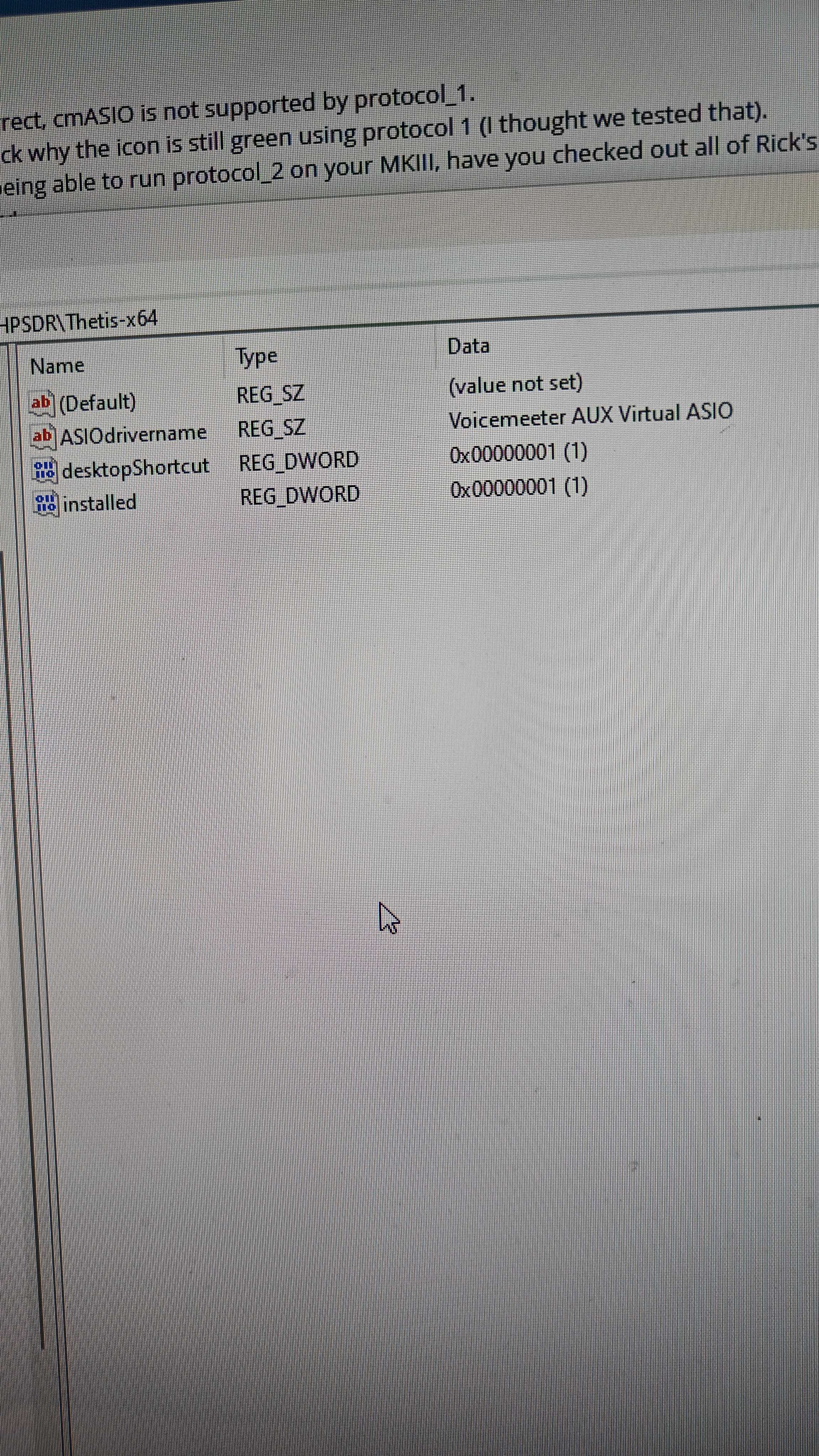

Re: cmASIO feature in Thetis
Posted: Sat Jan 13, 2024 4:35 pm
by K2MWC
I've been trying to get this cmASIO working without any success. I ran hostsample and It comes up with 3 Asio drivers
driverCount = 3
Voicemeeter AUX Virtual ASIO
Voicemeeter Insert Virtual ASIO
Voicemeeter Virtual ASIO
I've tried all 3 in the registry still no green cm at the bottom of Thetis, any suggestions ?
Posted: Sat Jan 13, 2024 4:37 pm
by Tony EI7BMB
Can you post a screenshot of your registry entry ?
Posted: Sat Jan 13, 2024 4:53 pm
by K2MWC
Tony EI7BMB wrote:Can you post a screenshot of your registry entry ?
K2MWC wrote:I've been trying to get this cmASIO working without any success. I ran hostsample and It comes up with 3 Asio drivers
driverCount = 3
Posted: Sat Jan 13, 2024 5:03 pm
by Tony EI7BMB
Thanks , I have Voicemeeter Virtual ASIO set . Is voicemeeter set to INT32 LSB and 48000 ? Your sound output device should also be set to 64 /48 k .
