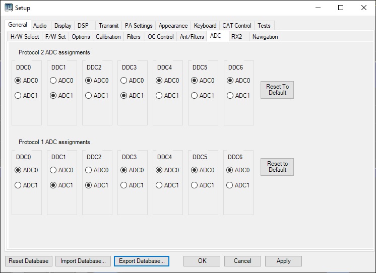

ANAN-100D Protocol 1 Thetis 2.8.11 64 bit
I noticed that RX2 was NOT connected to the RX2 jack with Thetis 2.8.9 so I upgraded to Thetis 2.8.11.
RX2 is still connected to ANT1 just like the main receiver.
FWIW PI shows RX2 connected to the RX2 jack.
According to the release notes this should have been fixed.
PowerSDR works correctly.
Roger

Re: Thetis 2.8.11 Released!
Are you able to fix the problem by manually selecting the ADC assignment in setup?
Did you try a fresh database?
The upgrade from 2.8.9 to 2.8.11 does a database refresh. I did another after upgrading and neither fixed the problem.
I started trying all the possible selections on the ADC screen to get the desired behavior.
On PowerSDR, DDC0 is connected to ADC0 and DDC1 is connected to ADC1. The Thetis default is the same. I am running Protocol 1 on my ANAN-100D.
However changing DDC2 to be connected to ADC1 looks like I am getting the desired result. See the attached screenshot.
With two antennas, testing shows signals on the ANT1 connector appear only on the main RX display and signals on the RX2 connector only appear on the RX2 display.

Posts: 6135
The DDC assignments in Thetis have always been different than in PowerSDR. Glad you got it sorted.
