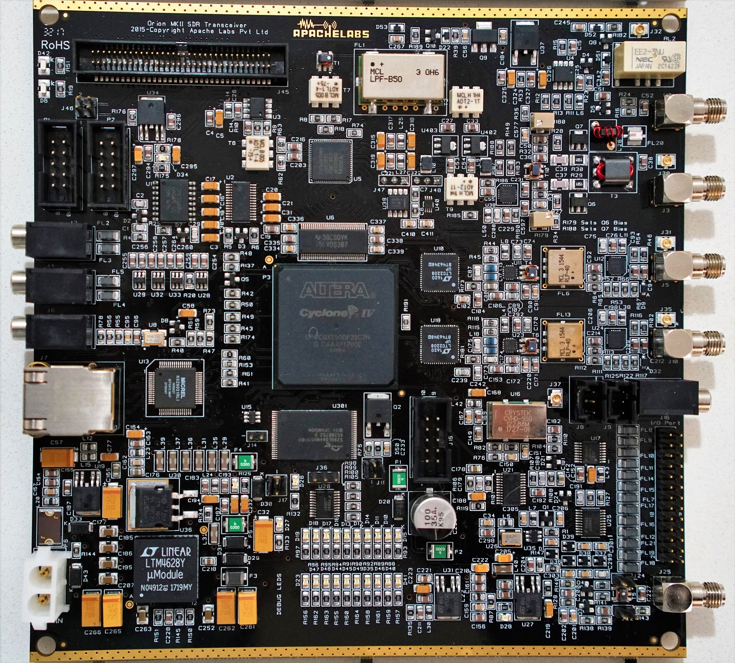

Tony (Apache Labs AU) was kind enough to send me schematics, but no component locator diagram/drawing.
I was able to determine that I want R145, but not where it is, I was hoping to able to tell in advance if the component density was low enough where the resistor is on the board to be able to replace it safely. I'd rather not tear the rig down unless I know there's a reason to.
I sent an email back, we'll see what happens. I already had a copy of the Orion MkII schematic, but no drawing or silk screen + solder mask image.
Jim N7CXI
Re: Unstable, wide, nasty spur
Posted: Wed Jan 19, 2022 6:39 pm
I got this image right off of the Apache website. Easy day, right on the edge of the board.
1059_1069_1050_1035_Orion MKII REV5.2 small2.jpg (1.05 MiB) Viewed 44551 times
Posted: Wed Jan 19, 2022 7:29 pm
by N7CXI
Hmm. Didn't think of that, obviously. :-)
Thanks, Scott. Looks like a walk in the park!
I'll report back with results when I have them. I need to get a resistor here, (don't have a 140K precision on hand) and coordinate with the OM that owns the rig.
Jim N7CXI
Posted: Tue Jan 25, 2022 4:28 am
by N7CXI
So here we are - it worked.
I replaced R145 on the Orion MkII board with a 140K 0.1% resistor and all is well.
I'm not sure what kind of solder Apache Labs or their CM used on the PCA, but I had to crank the hot air tool up to 400C before it would melt.
Opening that radio was indeed just as much fun as I remembered, too.
Jim N7CXI

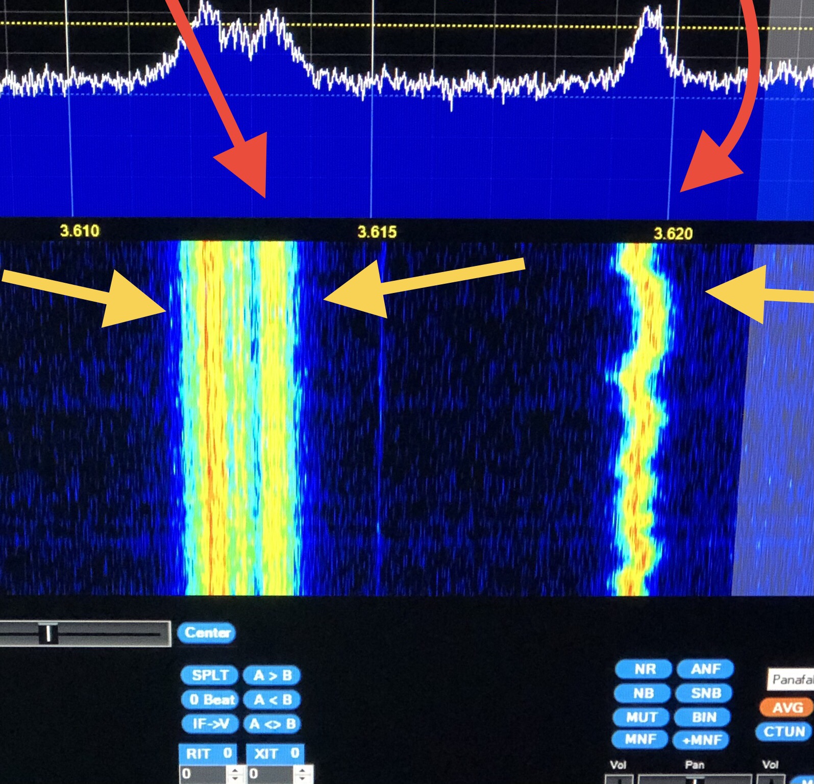

by WR4N
I’ve named mine: “Double Humper” and “Drunken Sailor.” The Drunken Sailor moves around, but generally within 2 kHz either side of 3.620 MHz. The Double Humper appears every 65 kHz all across 75 meters. After 3 months, I believe I finally tracked down the source for the DH: I used my ICOM 705 to locate a trickle charger. Home owner’s neighbor gave me owners cell # and I called her. She’s suppose to disconnect when she gets home from work. Fingers crossed! I think that will take care of DH ... but my Drunken Sailor is identical to what is seen in other posted pictures (blue color after rain, bright, multicolor at other times).
