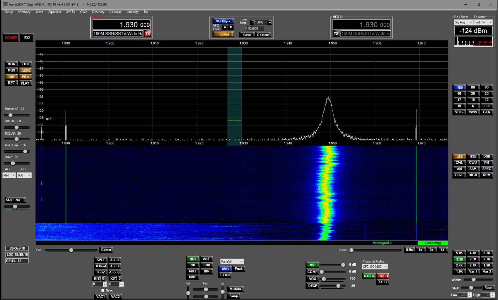

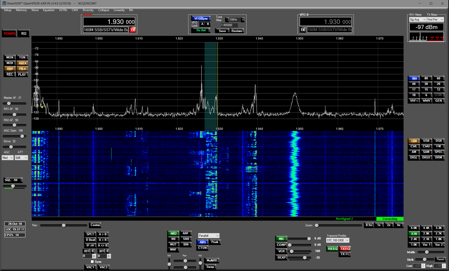

On my 7000 I have noticed for a while a nasty spur on 160M. Even with the antenna in terminated it is there. I do run all unused connections into terminators. Here are some screen shots on alive ant and on a terminated antenna.
BTW, the RX antenna is split to another radio and it does not hear/see this. And RX2 also has this spur.

I should of noted that the PSU was also eliminated. Besides running linear supplies only I did run the 7000 directly off a AGM battery and same thing.
Cold start of the radio the spur is about 1.925 MHz and after a bit settles around 1.945 MHz.

Joe, you mean the narrow spurs around 1890 and 1970? Interesting you also see that big fat ugly one.
Re: Unstable, wide, nasty spur
Hi Gary,
Yes, I see both of them at the same frequency and those and the gnarly one are the only ones I see in that bandwidth. Interestingly, these smaller width spurs do not change frequency as the radio warms up. The Gnarly one does change frequency. It goes from 2.004mhz to 2.023mhz after warm-up. It is also moving around a little as you watch it like yours. It is about 4 khz. wide as yours appears to be from the picture.
I also have small width spurs at 1.811 and 2.025. I wonder if you have those too? Starting at 1.811 that spur is reading about -120dbm. The 1.890 spur reads about -122dbm. The 1.970 spur reads about -124dbm and the gnarly one reads about -104dbm. All of these readings were taken in CWU mode and 500hz bandwidth and the meter is set to "signal" mode. Looking and listening to the gnarly spur with mode set to USB and bandwidth of 3.8khz, it reads about -100dbm and sounds something like a shrill hiss. I can record what I hear and send it to you if you like.
Joe W4WT
Joe W4WT
I have one on 1811 @ -120dB, but other than the other 2 noted my next one is 2048 @ -120dB. But these spurs are not a real issue like the big fat one.

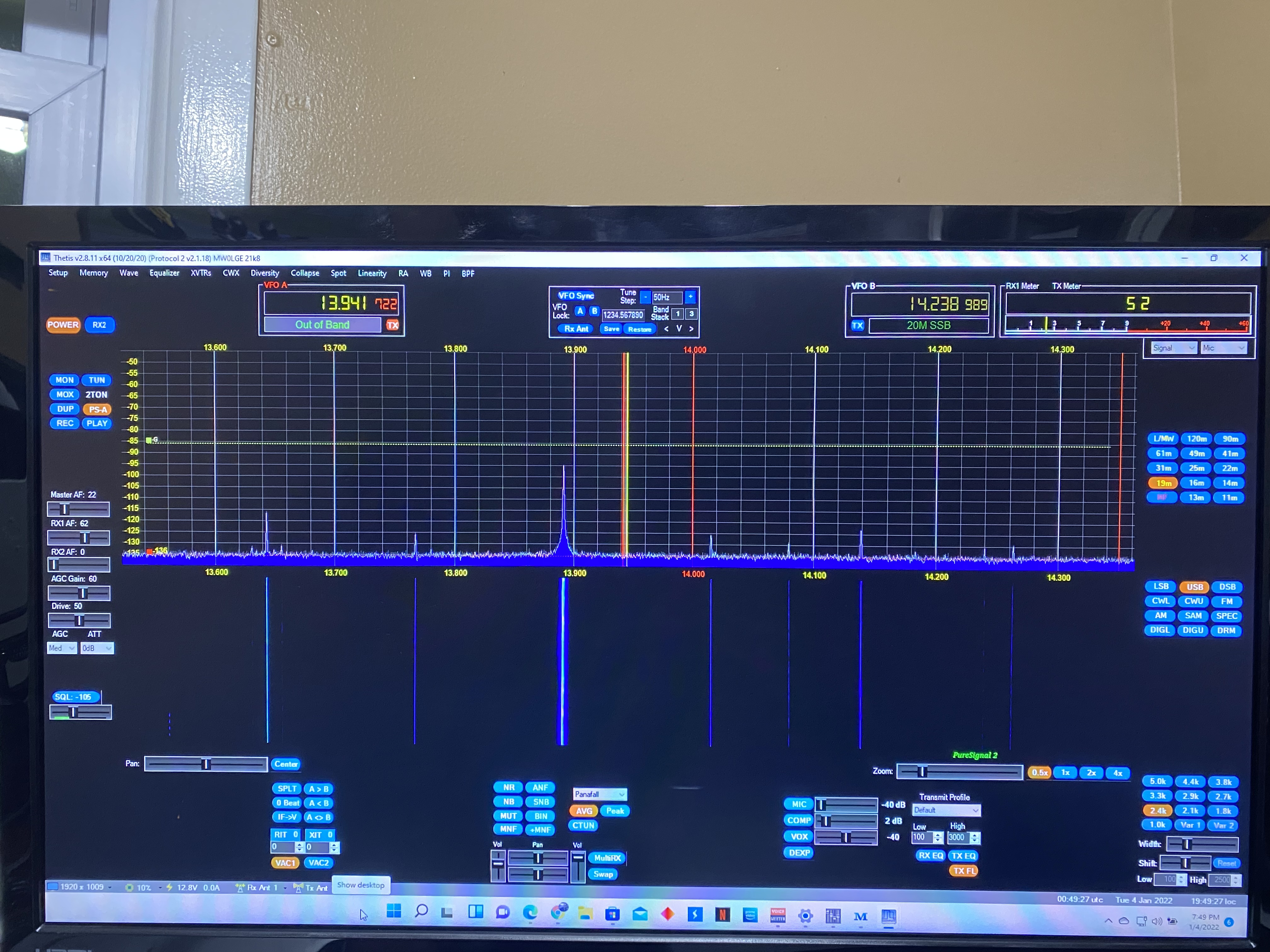

Having the same issue
- 10F6DD72-34D9-419A-A4F3-365A9E7CEEF2.jpeg (3.34 MiB) Viewed 43694 times
Just remember, until you terminate all your inputs on the back of the ANAN, don't be too quick to blame a spur on an internal source.
Its on order! Will report back!... Also long ethernet cable to get it away from my other equipment.w-u-2-o wrote:Just remember, until you terminate all your inputs on the back of the ANAN, don't be too quick to blame a spur on an internal source.
Thank you for the support!
