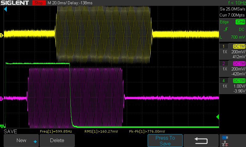

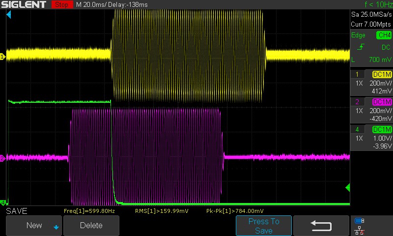

With some time to kill this afternoon, I measured CW latency of the CW side-tone in Thetis' new QSK mode. In the screen captures below, the first set is linear phase, 64/2048. The second capture set is low-latency, same buffer and filter size.w-u-2-o wrote:You save at least 10ms in both TX and RX directions when using a low latency filter of any size compared to a linear phase filter of length 2048.
The yellow trace represents side-tone audio from the ANAN 7000DLE's headphone jack. The lavender trace is sampled directly from the Studio 192's headphone jack. Horizontal division = 20 ms.
The green trace is a keyed pulse from a modified WinKeyerUSB. This output is used to trigger the scope.
Recall that when the new QSK mode is used, the internal side-tone is bypassed and the side-tone is derived from the receiver. I wasn't expecting this outcome at all. The ASIO driver's are operating faster than the Orion's DAC audio stage. Obviously, there's a lot common in Orion's signal processing path, but the on-board DAC path is slower than the VAC path with ASIO drivers.
Look at the side-tone delivered from the Studio 192's headphone jack when Thetis' filter type is set to low latency. That's 30 ms after key closure. The ANAN headphone jack delivers it in about 70 ms. Now, 30 ms may seem unimpressive, but remember this is the total delay in the transmitter and receiver.
By contrast, the linear phase filter type delays audio by 50 ms and 90 ms respectively. To Scott's point, the low latency filter delivers audio about 20 ms faster than the linear phase type.

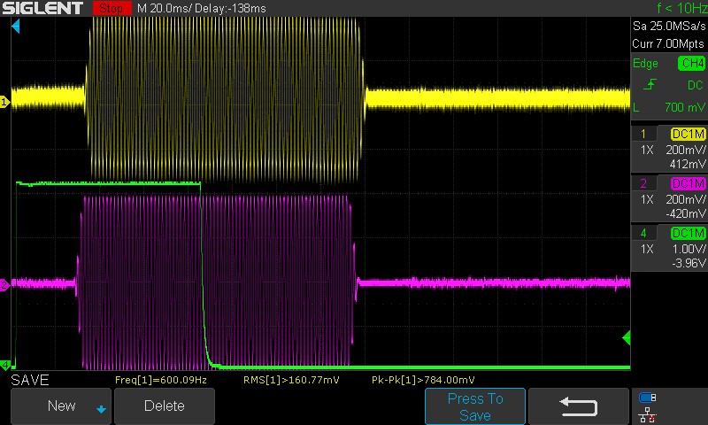

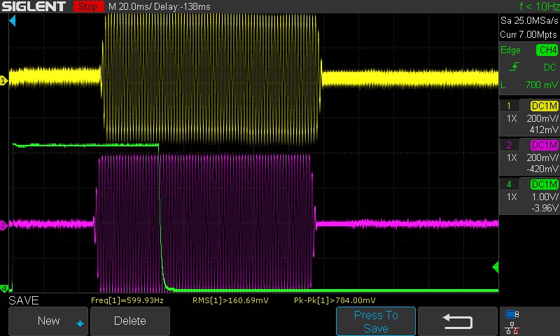

Well, I rebooted Thetis and now the ANAN 7000DLE and Studio 192 headphone jacks show nearly the same response time. Not sure what that was all about. Captures below. Top capture is linear phase; bottom is low latency.

That's great data, Paul, thank you!
Delay is only a single "PARIS" dot at 40WPM, or half a dot at 20WPM.
The important take-away from this is that, with an properly tuned ASIO sound interface, virtualized CW operation is possible with no degradation of QSK performance or sidetone in QSK mode. In fact it's at least a few milliseconds better than using a connection to the hardware unit.
