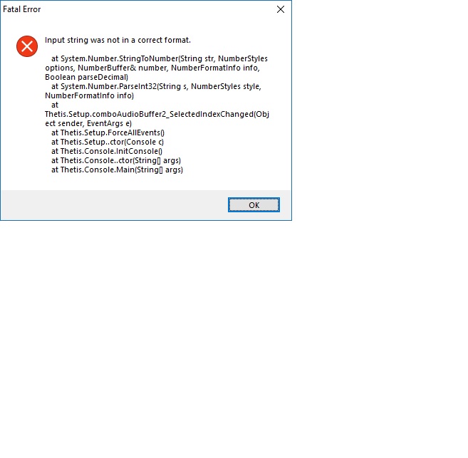

Well, after switching between audio drivers, I now get the error message below. I tried rebooting both the PC and ANAN 7000. No luck. I then removed Thetis from Win10 and tried to re-stall. Still get the fatal audio error message at start-up and Thetis won't load. So, how to clear this fatal error at start-up?

That fixed it. Thanks for the link.

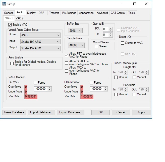

Bryan, attached below. I am not convinced the Var Ratio should be 1.0 when using a common clock in this case. Because of the large frequency disparity between 10 MHz and 48 kHz, coaxial cable length will affect pulse timing between the two outputs. However, that timing error should remain constant from a common source.

Hi Paul,
It’s perfectly normal for the Var Ratio to “hunt” around a bit when referencing your radio and sound device from a common clock. Mine sure does.
Even if you check the Force box, which stops the matching loop from steering the variable resampler, the matching loop is still trying to measure the ratio of the two clock domains, and is being perturbed by the staggering, drunken Windows thread scheduler.
The next step for you would be to check the Force boxes and prove to yourself that the radio and the Presonus are indeed synced (evidenced by the over/underflow counters staying at zero indefinitely).

Yes, I can confirm that counters remain at zero when "force" is checked or unchecked.Bryan W4WMT wrote: The next step for you would be to check the Force boxes and prove to yourself that the radio and the Presonus are indeed synced (evidenced by the over/underflow counters staying at zero indefinitely).

I note that the Studio 192 Block Size remains at 2048 even if I select a lower Buffer Size in Thetis.

That’s too bad about the Studio 192 block size not following changes in VAC1 buffer size. PortAudio tries to take care of that for you, but it’s up to the Presonus ASIO driver to comply (or not).
It’s important to make sure the VAC1 buffer size and the ASIO block size are in agreement, otherwise PortAudio has to adapt between the two, typically by introducing another layer of buffering (which nobody wants),
Maybe there’s a setting in the Presonus’ ASIO control panel that enables it to accept block size changes from the host application? Failing that, can you manually set the block size in the ASIO control panel?

Unfortunately, no. The Presonus control panel has no manual override. There's a pull-down menu for buffer size, but with the Presonus ASIO driver, it keeps switching to 2048 as soon as VAC is enabled in Thetis. So, a handshake is occurring, but it's not allowing for any other buffer size. The Presonus ASIO driver has no option either -- at least when Iooking at it in Windows Control Panel.Bryan W4WMT wrote: Maybe there’s a setting in the Presonus’ ASIO control panel that enables it to accept block size changes from the host application? Failing that, can you manually set the block size in the ASIO control panel?

PortAudio may be requesting a larger ASIO block size because you have your latency settings configured for automatic. Try checking all four Manual checkboxes and setting all four spinners to zero. See if that allows ASIO to operate at smaller block sizes when VAC1 buffer size is set accordingly.

That works and now the Buffer Size moves lock-step between the Studio 192 and Thetis. However, I tried setting all four wheels to zero but got Over/Under counter overflows.
Next, I left Port Audio at zero, but put the Ring Buffer on Auto (i.e., boxes unchecked). See below. Var Ratio stays VERY close to 1.0 and is unaffected when the "Force" check boxes are selected.

You are on the right track! As Bryan has explained before, the Portaudio settings are meaningless for ASIO and should be set to zero when using ASIO. The next and last order of business is to see how small you can get the buffer latency settings. I have mine set to In 5 and Out 3.
Also, I was able to get my VAC buffer down to 128, and I manually set the Presonus driver to 128.

I have the Buffer Size down to 128 and it's automatically handshaking with the Studio 192. Looks like my Buffer Latency limit is 10/10 ms. before overflows occur. I should probably be happy with the result.
