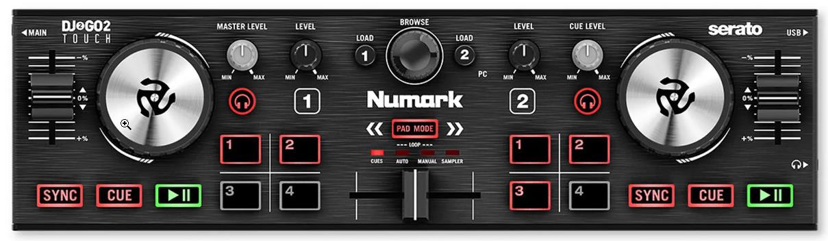

A quick search in the forum would have provided the answer. Yes, its working with the latest Thetis-Version.
i.e. here: viewtopic.php?f=9&t=4870&p=27454&hilit=starlight#p27454
Also working: Numark DJ2GO2 Touch
But not tested every function. But a quick setup looks promising. Will do a full config for my HL2 setup.

Yesterday I configured a Numark DJ2Go2 Touch.
Some oddities, but overall works great!
* main knob in the center (top) is not a knob, its only a switch (values 1 or 127)
* left and right slider are "reversed", so 0 is on top, 127 is on buttom (Richie has already added a fix, will be in some future releases)
* headphone-buttons (located right from left-wheel and left from right wheel) are currently acting in a strange way... still investigating....

Do the wheels work when you place your finger on the "bezel" ? Talking about the Numark DJ2Go2 Touch Midi Controller that you have working with "some oddities." I assume that when you do the programming you can rotate the wheels by placing your finger on the bezel. I prefer that over needing to keep your finger on the touch sensitive portion of the 2 wheels on my Hercules DJController Starlight. The tactile feel isn't really solid or "reassuring" when using those wheels.

Hi Juha,
I have the Numark on my 2nd QTH where I am using my local Hermes Lite 2 via remote. Will be there on thursday. I will test it and report it here.

Just tested my Numark DJ2GO touch on my remote site. Left & right wheels are working perfect.

I have the compact and the numark.
The compact is better quality (rubber buttons, backlit, ...)
