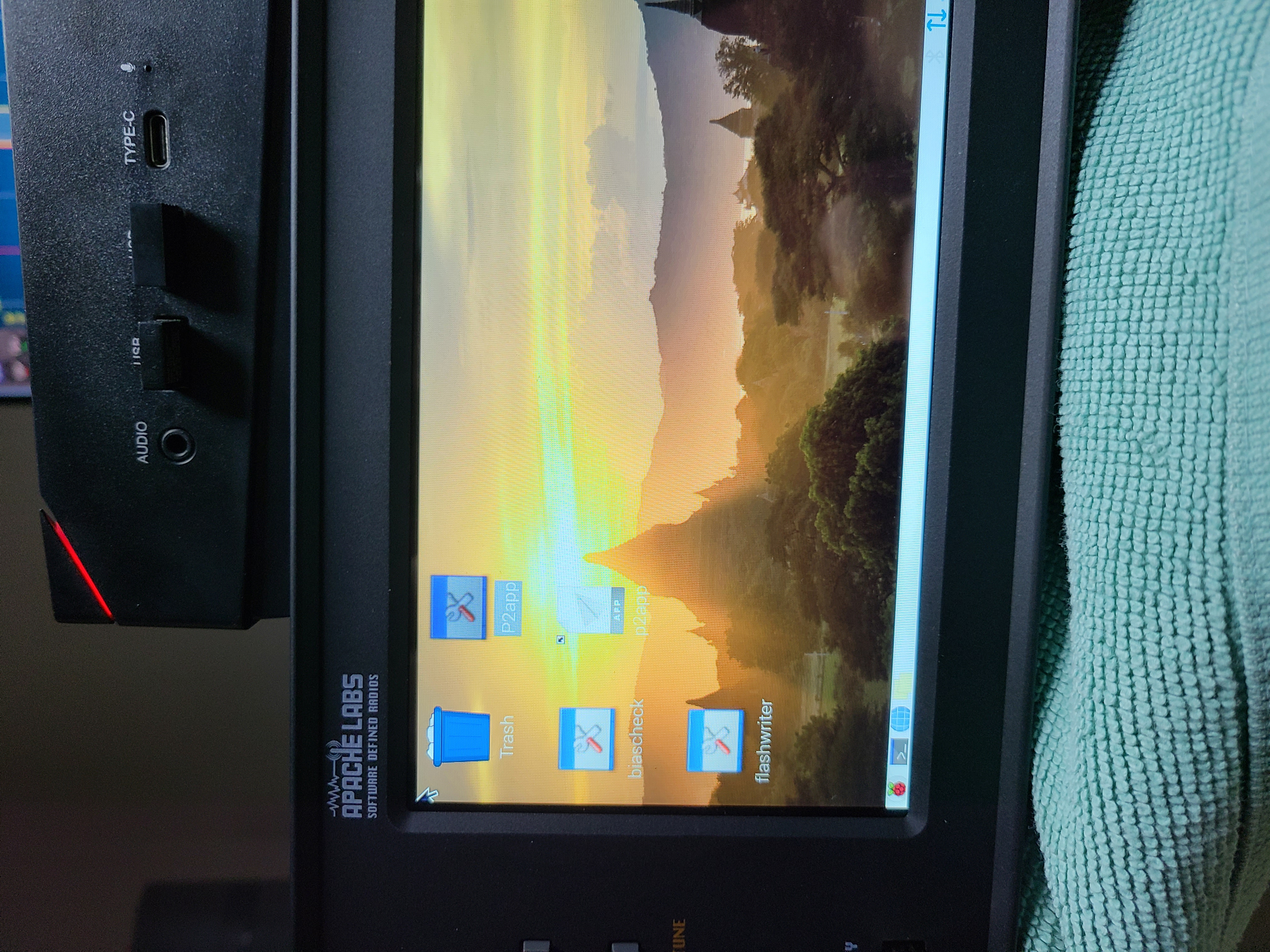

i exit out of thetis these are the icons i see,
i click on P2 App a then on Thetis Program i can not connect thetis to computer.
i dont see a Icon to start Pihdsdr as well

Re: How do i configure my microphone Hardware on my g-2
this is what I see when i double click on p2app icon.
- double clikc.jpg (4.54 MiB) Viewed 24912 times

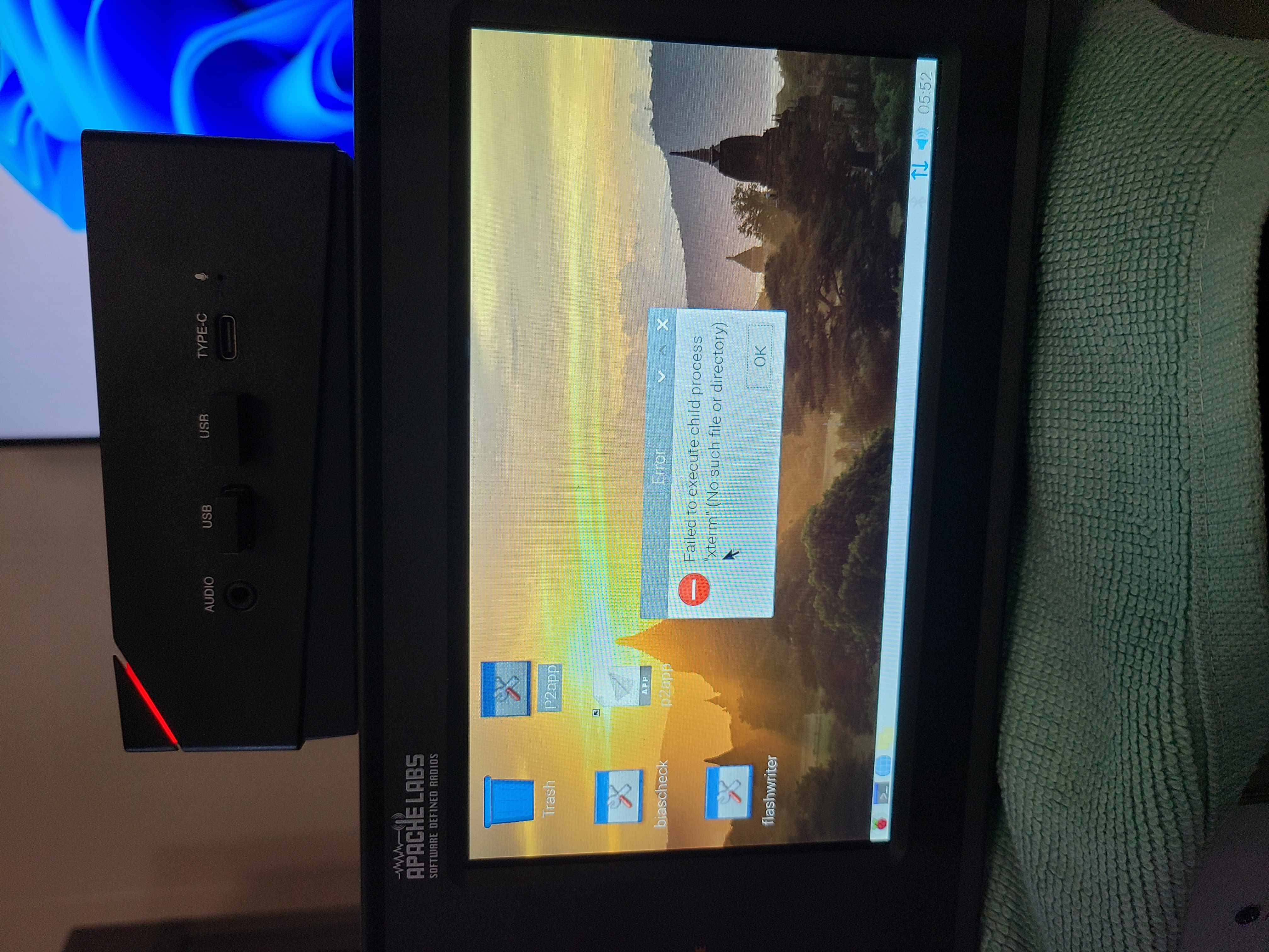

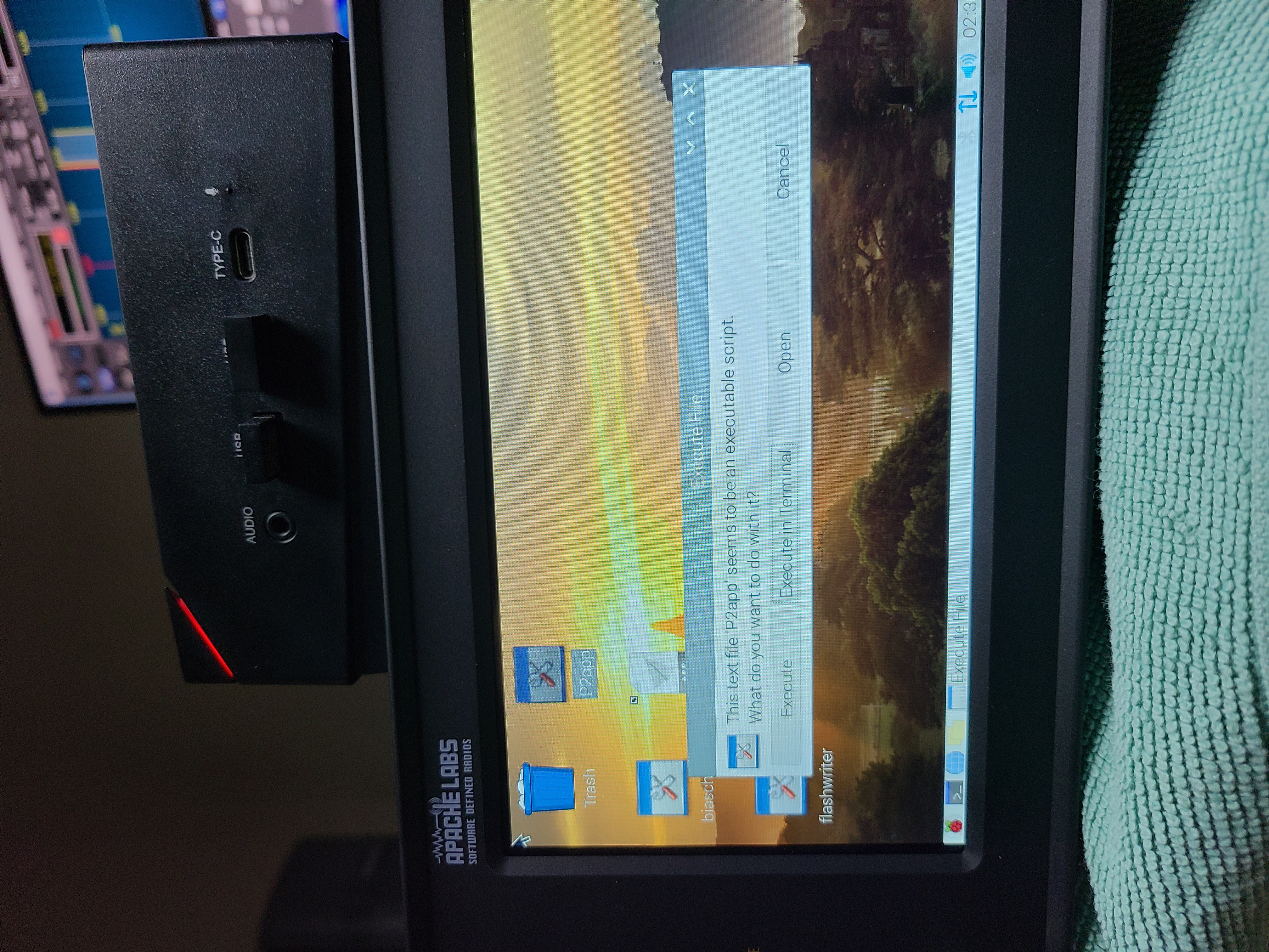

Thetis Application I close Pihdsdr and go to Desk top
After I double click on P2aap and open it I get this banner of execute file
Then I proceed ton tic on execute and the the error message
seems like my application is lost.
Any ideas?
Fm Ed rodriguez
Kk4x
Any ideas?

If you get a message "p2app seems to be an executable script...."
select "execute in terminal" to get some confidence that something happens.
It is possible to disable that message, but I can't remember how.
We do have more changes coming that will make some of this easier, but the code isn't tested yet.
