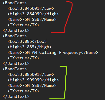

I have a question Richie, since I think Clint and I are trying to do something similar here. How come on 80 meters, it has 3.885 mhz as the AM calling frequency, and when you go outside of that, it doesnt say out of band, it says 80m or what not. But on 11 meters, if I want to name, say, 27.025 mhz "The Superbowl", you cant without deleting the 11m BandText information and the rest of 11m will be "Out Of Band"?
I tried doing that exact thing, I went and read how the 80m BandText is setup and written, did it the same way, and the added info gets deleted after Thetis starts up?
Maybe im missing something thats already been covered.

It is because either side of the spot 3.885 it has the 75m SSB entries. The same could be done with the 11m spot frequencies, but there would be a lot of fillers to rebuild the 11m areas, 41 one of them in Clint's case.
Cheers.

Thanks Rich for an Awesome explanation!!
The above couple of posts Should be made into a separate new thread to be search easy on!
Great info!! Would not have figured this out!
Cheers.
Dude, I didnt even notice that..
Thanks so much. I would have been pulling my hair out for hours.
Thanks again for the work.

probably related to your band stack config. A band stack entry will be recovered on startup and if that was not updatable on close down, then it will recover with the mode associate with that pre-existed on that stack entry. May also be related to the bandstack return to last used/specific/or frequency mode. Changing mode using the mode form, shutting down and restarting works fine here.
