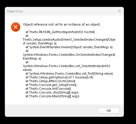

Fatal Error when installing 2.10.3. Win 11 Pro. WIn 11 update 23H2 _11/1/23.
12th Gen i7-12700K,3600Mhz. 12 Core(s).
Please see attached.
tnx ..OXT
tnx ..OXT
- Screenshot 2023-11-02 181902.png (17.98 KiB) Viewed 36516 times
Re: Thetis v2.10.3 released
try the following :
uninstall, reboot pc, re-install. Give that a try. Looks like PA19.dll did not get replaced with the new one for whatever reason

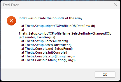

1. FATAL ERROR After install of Thetis v2.10.3. Tried uninstall and reboot. No Luck.
2. Then saw you released v2.10.3.1 so uninstalled v2.10.3 and rebooted. Then installed v2.10.3.1 and rebooted. No luck. Identical Fatal Error.
N3CAL
N3CAL
@N3CAL issue with 3 band EQ, bug. Will address in 2.10.3.2 in half an hour ... 2.10.3.1 was short lived. Next time we will do pre-release. Not enough testing/testers.
