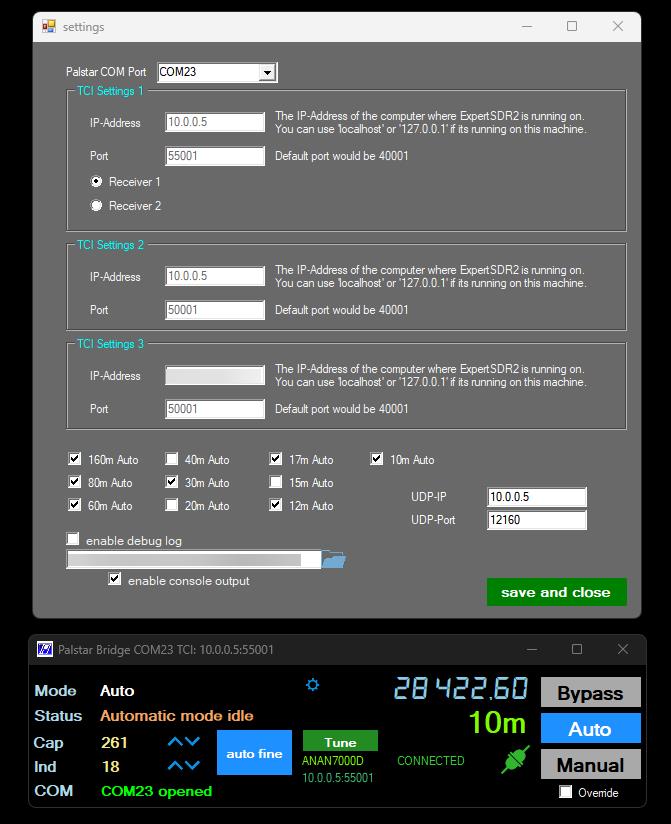

I've written my own software for fully automatic control of my Palstar AT-Auto (the old one "Kessler").
It does auto-switch Bypass/Auto/Manual and auto tuning.
73 de Ernst, OE3IDE

https://www.oe3ide.com/sdm_downloads/palstarbridge/
(clean on VirusTotal)
Its not an official release... may contain bugs ;-)
73 de Ernst, OE3IDE

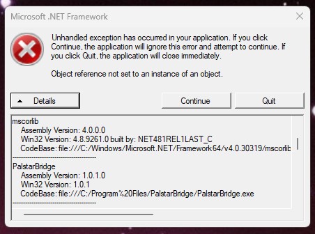

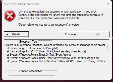

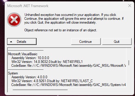

Bridge installs OK, but on startup I get a .net Unhandled exception error, on clicking continue it constantly pops up before I can input my com port and TCI port (COM8 and TCI 50001)
Screenshots attached.. System Win 11, com port via FTDI usb-serial adapter TCI running in thetis
palstar bridge 1.jpg (52.1 KiB) Viewed 10234 times
Palstar bridge 2.jpg (47.71 KiB) Viewed 10234 times
palstar bridge 3.jpg (49.23 KiB) Viewed 10234 times
palstarbridge 4.jpg (47.68 KiB) Viewed 10234 times

Yeah, quick & dirty thrown together *lol*
Was not intended to be used other then by me.
Will go through and add a proper error-handling... maybe this or next week.
73 de Ernst

After trying to get it to work, It seems that my Palstar is not the same as yours, hopefully you can come up with a version that suits all HF-Auto tunes
73, Charlie GI4FUE
