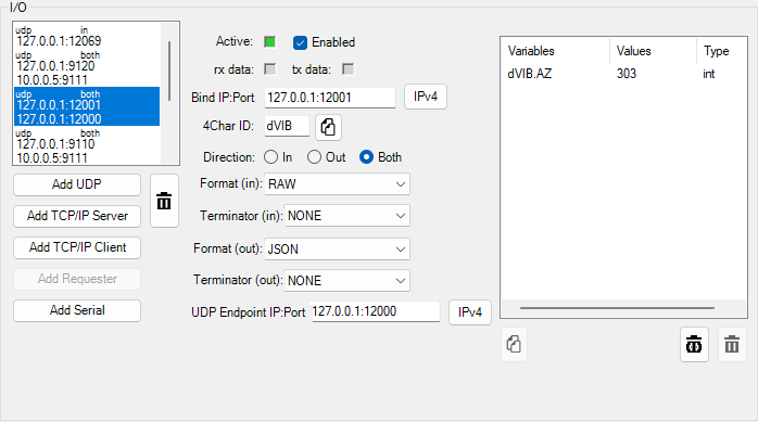

I followed the YouTube suggestions of Richie to setup the rotator control but I am not able to receive any packet from PST Rotator on Thetis Multi I/O.
I suspect this is due to my PC ethernet configuration as I use the laptop internal network device connected directly to Anan 7000 and the external dock station ethernet device to LAN.
On my Windows11 the internal eth is listed as Ethernet and the dock station eth is listed as Ethernet2.
Is it possible that packets of my LAN and of my terminal (127.0.0.1) are routeed only on first eth device, in my case the one connected to Anan 7000?
I tried to use putty to see the packets flowing around my IP and ports programmed on Thetis but I don't see anything and after about 10-20 seconds putty closes itself with a generic network error.
Any suggestion? ;)
P.S. I tried to set interface metric of eth card connected to LAN to 5 and eth card connected to Anan to 25, in order to prioritize tha LAN card, but the issue remains.
Re: Meters - next level
if you run Thetis and PST-Rotator on the same PC then the configuration should be straight forward. It doesn't matter which IP-Range the Anan7000 is using to "talk" with Thetis.
See screenshots:
73 de Ernst, OE3IDE
Thanks for the screenshots Ernst, a picture is worth a thousand words :)
