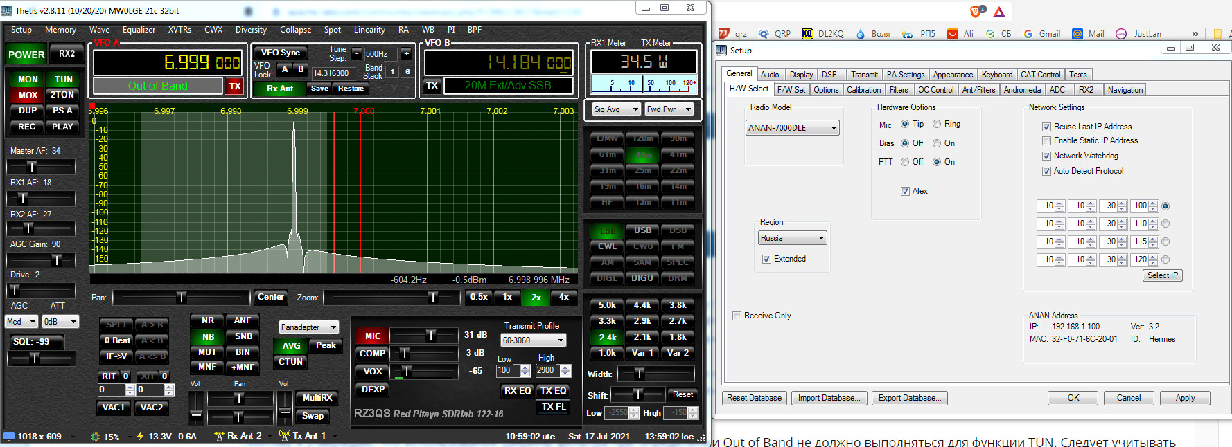

W1JA wrote:TUN button won't tx close to the band edge
The tune function errors out ("Transmit Error: Out of Band") when it would generate a signal closer to the band edge than the SSB (or AM, or DIGx) filter width. For example, if my VFO is set to 7.001 MHz and mode is CWL, I have to move to 7.003 to be able to tune, because my SSB filter width is set to 2.9 kHz.
Of course it makes no sense to use an SSB filter width when in CW mode. But it makes even less sense in any mode, because tuning transmits a continuous carrier. A continuous carrier has a bandwidth of zero, so I can legally transmit right on top of the band edges, in my U.S. case on 40m, 7.000 and 7.300 MHz.
Therefore I submit that using filter width when determining Out of Band should not be done for the TUN function. Only national band edges should be considered.
This issue has be present since I started with PowerSDR a few years ago. I find it to be quite an annoyance.

I activate the checkbox "Extended" and the "TUN" button works at any frequency. Normal decision.

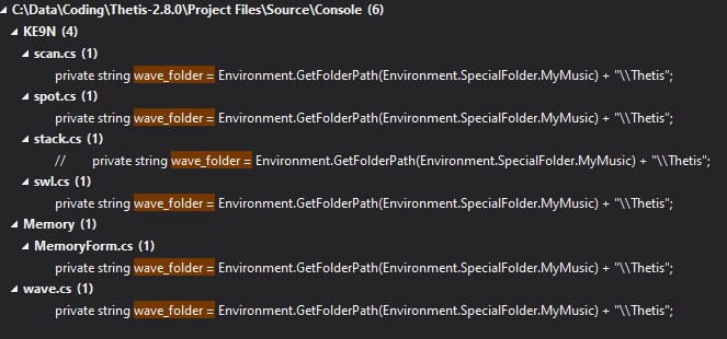

Also, why does Thetis create a Thetis subdirectory in my Music folder? I delete it every time I notice it (it's always empty), and Thetis recreates it when it next starts up.
rbduck
Posts: 350
Post by rbduck »
W1JA wrote:Also, why does Thetis create a Thetis subdirectory in my Music folder? I delete it every time I notice it (it's always empty), and Thetis recreates it when it next starts up.
Recordings made by Thetis are stored there.
Posts: 1596
yep, it makes that to store recordings in afaik. Coded to do it blindly no doubt, making recordings or not. Still working this ADC problem.... it is something I didn''t really want to spend 2 days on at this stage >.<

Yevgeni wrote:I activate the checkbox "Extended" and the "TUN" button works at any frequency. Normal decision.
But I would like to retain the protection against accidentally transmitting out of band limits.
I have used the REC function from time to time, and Thetis (and I'm pretty sure PowerSDR before Thetis) doesn't put recordings in \Music\Thetis. I just made a test recording to be sure, and Thetis put the SDRQuickAudio.wav file in \Users\John\AppData\Roaming\OpenHPSDR\Thetis-x64. (I named the Thetis folder Thetis-x64 during the install.) I don't understand why my Thetis doesn't use \Music\Thetis as yours does, Ruben.
Anyway, this is a good time to mention how primitive and cumbersome this REC function behavior is, no matter where it saves the file. Ideally when each recording ends, the standard Windows dialog would appear, allowing the user to name the file (so the previous recording is not overwritten) and store it in a location of choice. So, I suppose this is not a bug report, but a feature request.
Yevgeni
Posts: 58
Post by Yevgeni »
W1JA wrote: But I would like to retain the protection against accidentally transmitting out of band limits.
Button CWU and everything is fine with TUN.
Posts: 1596
W1JA wrote:
Inside Memory.cs constructor
if (!Directory.Exists(wave_folder))
// create PowerSDR audio folder if it does not exist
Directory.CreateDirectory(wave_folder);
Inside Wave.cs constructor
What is wave_folder we ask ousrselves....
and what gets placed in there? This....

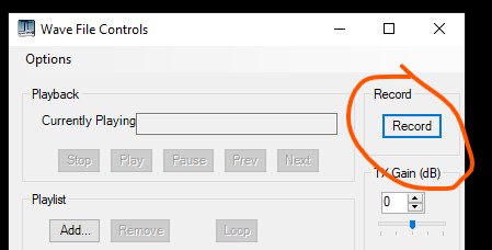

W1JA wrote:
rbduck wrote: Recordings made by Thetis are stored there.
Now my curiosity is peaked. I did two tests. One recording from the quick recording function and one from the record button under the "wave" tab.
The recording from the record button under the wave tab went to my Music folder.
The recording "quick record" went to the Thetis folder.
Huh?? I'm sure there was a very good reason.
Posts: 1596
That random beat of a butterfly wings in some rainforest caused chaos theory to determine that it should be implemented with another folder, instead of just adding _QR (quick record) or some such onto the dated filename.
In other words, your guess is as good as mine :)
