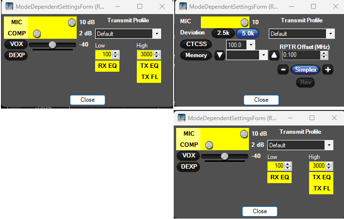

va7qi wrote:Sorry, I guess I was not clear. It is the ModeDependentSettingsForm that is not saved.
73 de va7qi, ....Erik.
Some of the settings in the ModeDependentSettingForm are stored against TX profile, so if you change the settings you need to save the TX profile, or you need to turn on one of the TX profile autosave options. There is a bug that if the main console window is resized then that mode settings form is cleared out, this will be fixed in 2.10.3.4

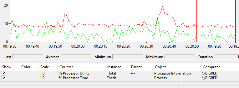

Re: Thetis v2.10.3.3 released
Post by k6avp »
Been using v2.10.3.3 for a couple days now and have not noticed any problems running my ANAN-100B, except that the bottom of screen CPU Usage meter does not update and reads 100% at all times in either Thetis or System. I think the Usage meter actually stopped updating when I updated to v2.10.0. Thetis start seems faster and some parts of screen a bit sharper.
Running Win10 x64 and IK3VIG Special skin. Screen update set at 15FPS. panadapter. Task manager says Thetis CPU use is about 35%, System about 60% and network about 50MB/s via GB connection. Memory is about 64% overall with Thetis at 95MB. Other normally running programs are: with WSJTx+, JTalert, MS Edge browser and NEMEAtime 2+GPS puck. My radio is running P2 v3.1, which I believe is up to date for my 100B.
Posts: 1588
k6avp wrote:Been using v2.10.3.3 for a couple days now and have not noticed any problems running my ANAN-100B, except that the bottom of screen CPU Usage meter does not update and reads 100% at all times in either Thetis or System. I think the Usage meter actually stopped updating when I updated to v2.10.0. Thetis start seems faster and some parts of screen a bit sharper.
To show 100%, then it must have at one point obtained that value, and for whatever reason has stopped updating. You can check you are getting results by using PerfMon and setting them up as below.

va7qi
Posts: 144
Location: Quadra Island, BC
Post by va7qi »
The mode form is still not saved.
Yes, auto-save is on.
Yes, save on change is on.
Yes, I uninstalled first.
Posts: 1588
va7qi wrote:The mode form is still not saved.
the mode form has never been saved, It just shows what mode you are in and as long as the band stack config allows the mode to be updated into a stack entry, it will return with that mode/stack entry.
Parts of the mode specific from are saved in a tx profile and restored from a tx profile. You provide nothing to help diagnose a problem, if indeed one exists. Make a video or something that shows what is happening because as it stands your report is about as useful as a chocolate tea pot.
va7qi
Posts: 144
Post by va7qi »
I suppose one could argue that a chocolate teapot could hold cold tea, but the taste may be a bit strange.
I am simply using the mode dependent settings form to enable compression and the TX equalizer, The settings are not saved - at least they are not showing up when Thetis is re-started.
UPDATE: After opening the Equalizer tab and saving, the form now shows correctly.
