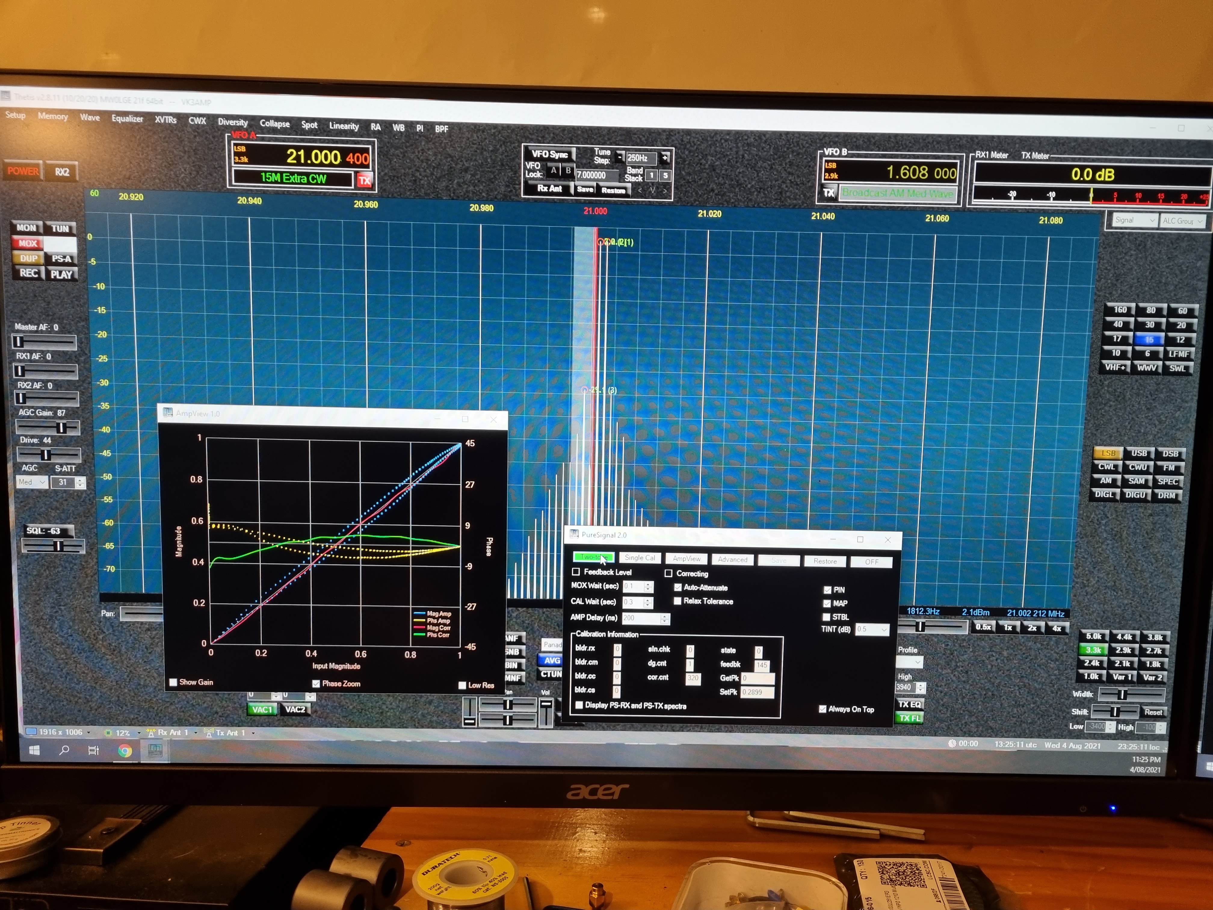

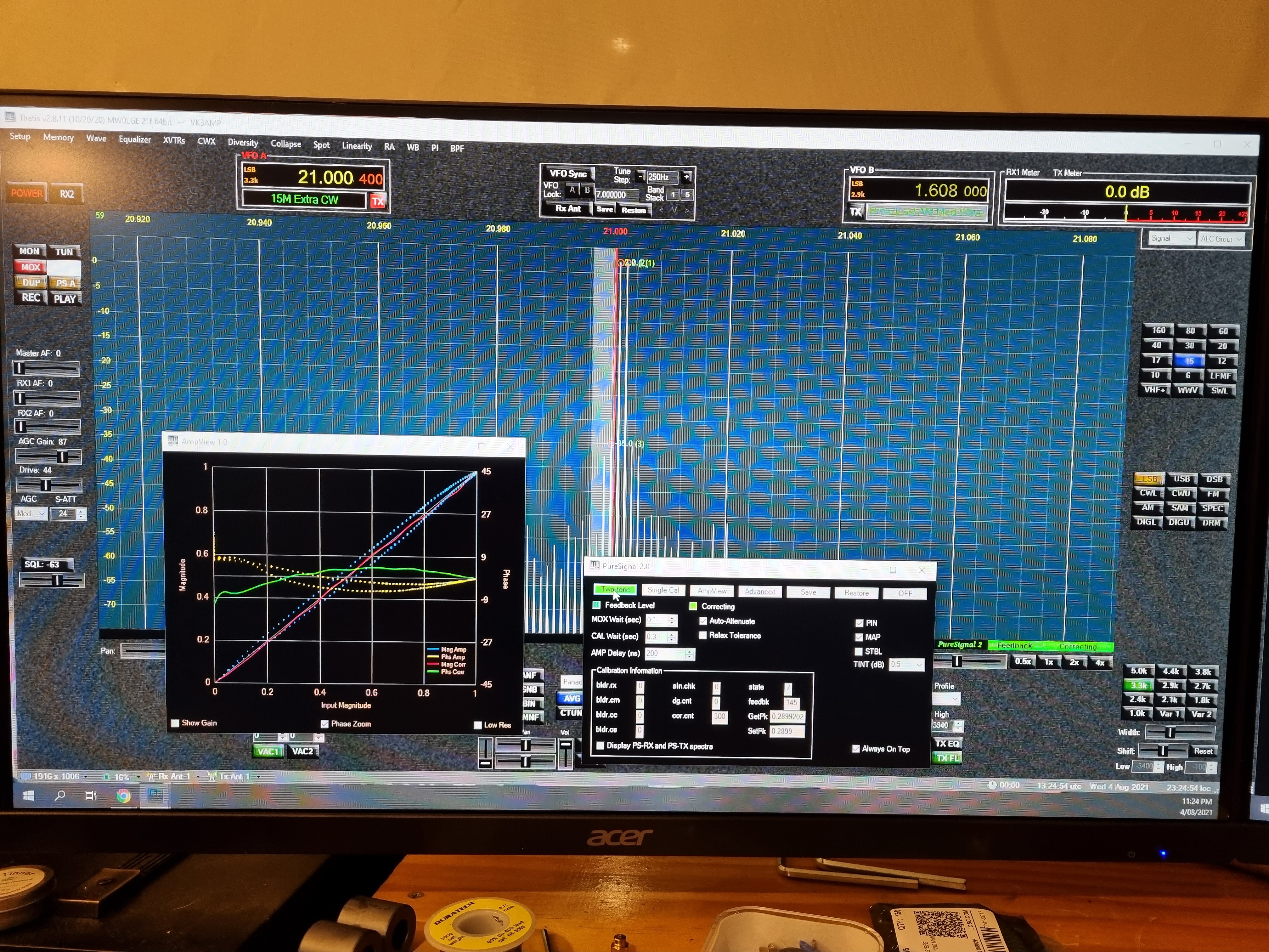

Re: New -10/-100 16-BIT Hermes Protocol 2 Firmware Topic
My setup.
Anan 10. 10.8pre20
Thetis 2.8.11 21f
1.5kw ldmos amplifier.
-55db coupler.
İ seem to be having an issue getting pure signal to work with this setup. Turning on or off pre distortion only makes a marginal improvement to the Imd please see the photos.
One thing I did notice is that there are 2 blue lines in the amp view. İs this normal.? No matter what settings I try or power levels I can't seem to improve things.
Can anyone offer any advice on how to fix this.
Thanks in advance
Anan 10. 10.8pre20
Thetis 2.8.11 21f
-55db coupler.
Thanks in advance
- Pure signal on
- 20210804_232455.jpg (4.09 MiB) Viewed 56213 times
- Pure signal off
- 20210804_232511.jpg (3.61 MiB) Viewed 56213 times
What was your setup before this? Whatever it was I'm assuming it worked? Or is this a brand new setup?vk3amp wrote:My setup.
Anan 10. 10.8pre20
Thetis 2.8.11 21f
-55db coupler.
No. That is indicative of bad data.Turning on or off pre distortion only makes a marginal improvement to the Imd please see the photos.
Without any additional data, I'm going to guess that this is the first time you've tried to run P2 firmware on this particular hardware. The sad fact is that P2 firmware in the 10.8pre series, while substantially improved over previous efforts, still is not guaranteed to run successfully on every serial number Hermes out there. That is, most likely, the cause of the problem.Can anyone offer any advice on how to fix this.
It is always worth trying other, older versions of the P2 firmware to see if you might hit on one that works OK for you.
