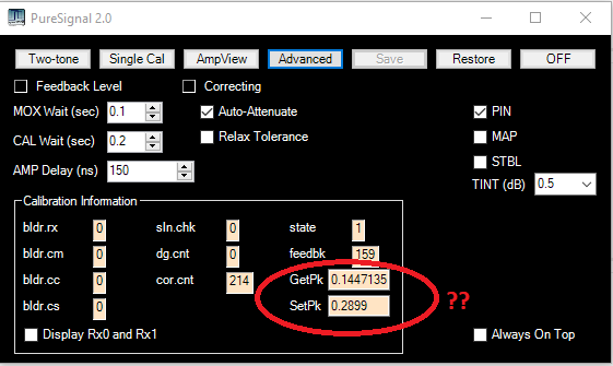

Re: New -10/-100 16-BIT Hermes Protocol 2 Firmware Topic
Hello everybody,
I have been using the Hermes Board with PureSignal for many years.
Under protocol 1 P.S runs also 100% !
Now I use the following configuration:
HW: Hermes Board
SW: Thetis v.2.6.9 (c3)
FW: 10.8 pre 5
Pure signal is not yet stable. I guess 50% TX is okay and 50% is not okay.
I noticed that if P.S is not OK "GetPk" and "SetPk" are not the same.
"GetPk" is then half of "SetPk".
(-> see Calibration Infomation)
Thank you very much for the further development of the FW for Hermes !
73, DL5AI
Arno

But here is the problem: Open the Linearity menu - then watch the GetPk and SetPk numbers.
In all FWs the GetPk number gets lost from time to time - sometimes it's not even recognizing any value from the beginning.
It looks like no feedback cable is connected…..but doing several transmissions it finds the feedback again and works again….
If I should guess what's the problem I would say that the FW is not continuously monitoring the feedback - it jumps off and on.
Once the feedback signal gets lost Pure Signal stops correcting - no wonder.

Regarding 1) there is still a major problem. If the signal gets lost the GetPk value stops at about 0,14......working values are 100% higher at about 0,29.
Don't know if this helps - regarding that 1)-issue I do NOT see any major difference comparing all pre versions - but they are all better than the older versions before. Think there is still this one bug - may be the monitoring function of the feedback signal needs just a higher priority?

Realized a bit too late that there are more versions to test. So I went back for another hour testing in my lab.
In direct comparison I would choose pre 9 (tested pre4 - pre9)…..
Pre 9 is may be slightly more stable - the cleaning process is better (and way better than pre4). Worst was pre 8.

As I reported earlier on ^^ "Thu Feb. 13, 2020 7:12 pm", I also see a problem with "GetPk" and "Set PK".
However, I do not know the exact function - so it should only be an indication.
I am looking forward to a new FW version for Hermes and would be happy to test and report everything.
