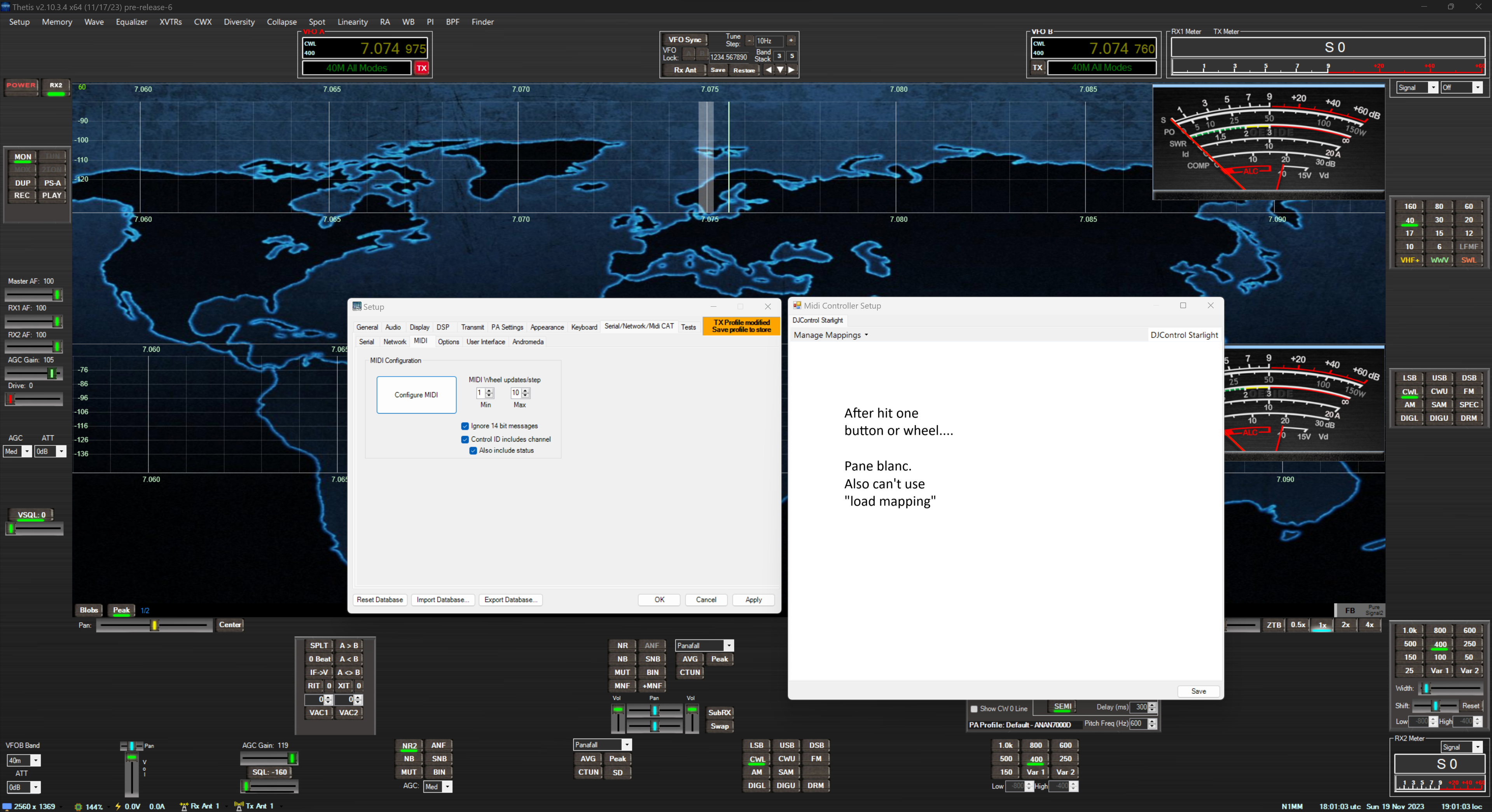

Serious MIDI issue

There's one problem though (bug?), after i did almost all buttons, wheels and knobs i did "Save Mapping" (name DJControl Starlight).
Don't try this guys ... all settings are gone, the Midi Controller Setup pane gets blanc and stays blanc.
Haven't found a quick way yet to solve this, had to reinstall Thetis.
regards, Leon

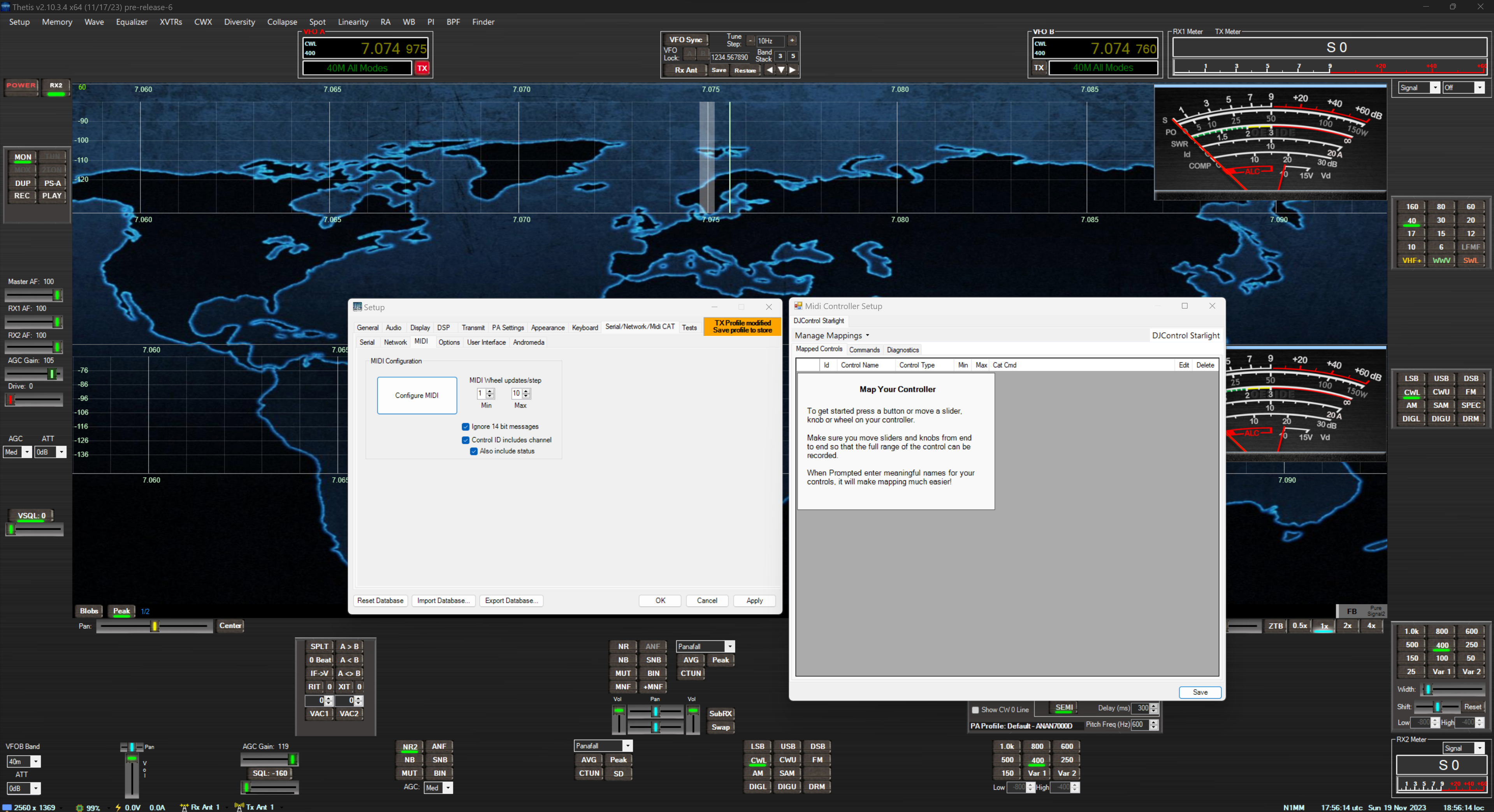

Hi, i just repeated it 10 min ago to be sure the issue is still there ... sadly, same result.
Have to rebuild all midi settings again, there's no way to load them back in Thetis.
See Pict 2 then Pict 1
Also midi2cat.xml added
Btw i choosed to do a clean install because i saw no way to delete some previous midi controllers that i used in the past.
Strangly enough they are stil visable in the .xml
r/Leon

Re: Thetis v2.10.3.3 released
Note: i deleted midi2cat.xml and started to program the wheels again.
They work great until i do Manage Mappings - Save Mapping As
After that...same result.
midi save mappings as are broken, and it seems like they have been for ages at least in my test with a version of thetis from before my ownership, at least for 4yrs +
You can see it happening here with a quick test of a very old version : https://youtu.be/bgqjkQrGx94
Do not use save mappings or organise mappings as it is all broken. Just add your mappings, then hit the save button at the bottom of the midi form. I am not planning on fixing any of that 'save mappings' stuff. Someone else can do it if they are so inclined.
