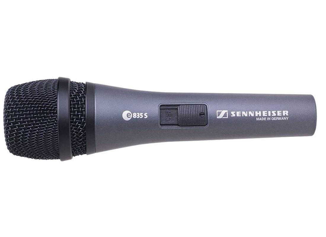

I'm using this microphone with the 10E and 8000DLE.
Getting very good reports, this is a superb microphone. Don't be fooled by super-duper microphones costing many $$$ with enhanced communications quality audio. We can mangle audio in the DSP - but first start with a good input source.
The S version has a good, silent on/off switch.

That's a great looking mic, Simon! Dynamic, so no fuss, no muss with phantom/bias supplies. Did you use anything special to do the balanced to unbalanced connection, or just make up a cable that bonds the audio "-" lead to ground?

I just use a standard cable as you describe.

I had a chance to play around with an 835S and found it to be exceptionally smooth and crisp for vocal work. Of course I plugged it into my TX audio rack and noticed right away that it did not have the usual boomy proximity effects when you moved in close. It's very nice for ham radio work because of the nice presence rise curve that starts in the mid-2K range.

I do get excellent unsolicited audio reports, so I am sticking with this microphone.
I'll try to get a SDR recording from a remote location so you can hear it. Note that I'm not using PowerSDR, rather my own software with speech compression / noise gate.

I have no doubt you'll like it - I have a scratchy on-air recording of my signal with the E835S / 8000 / SDR Console and it sounds good - like a human being.

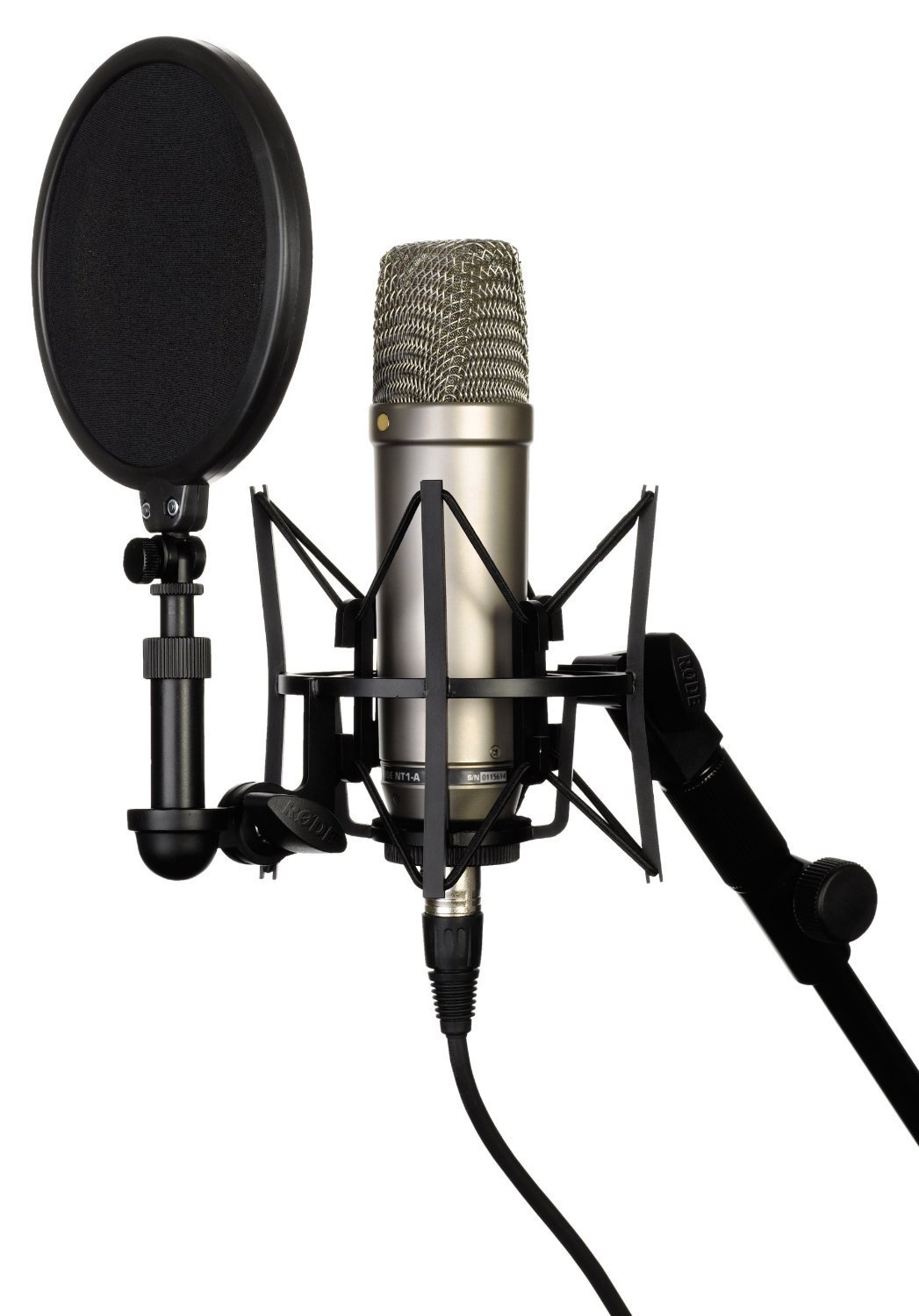

Another microphone I would like but will not buy is the RODE NT1-A Condenser Microphone https://www.amazon.co.uk/Cardioid-Conde ... _i=desktop .
