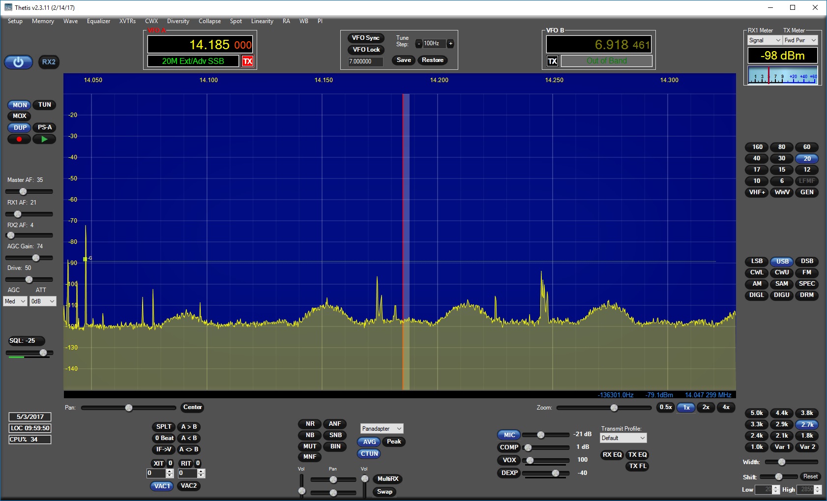

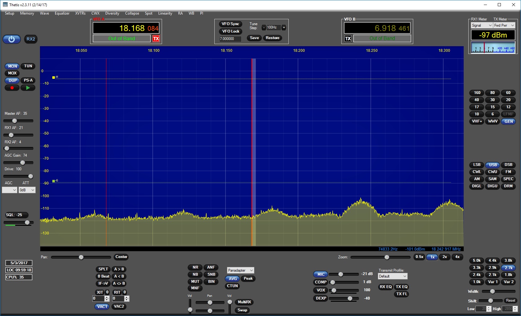

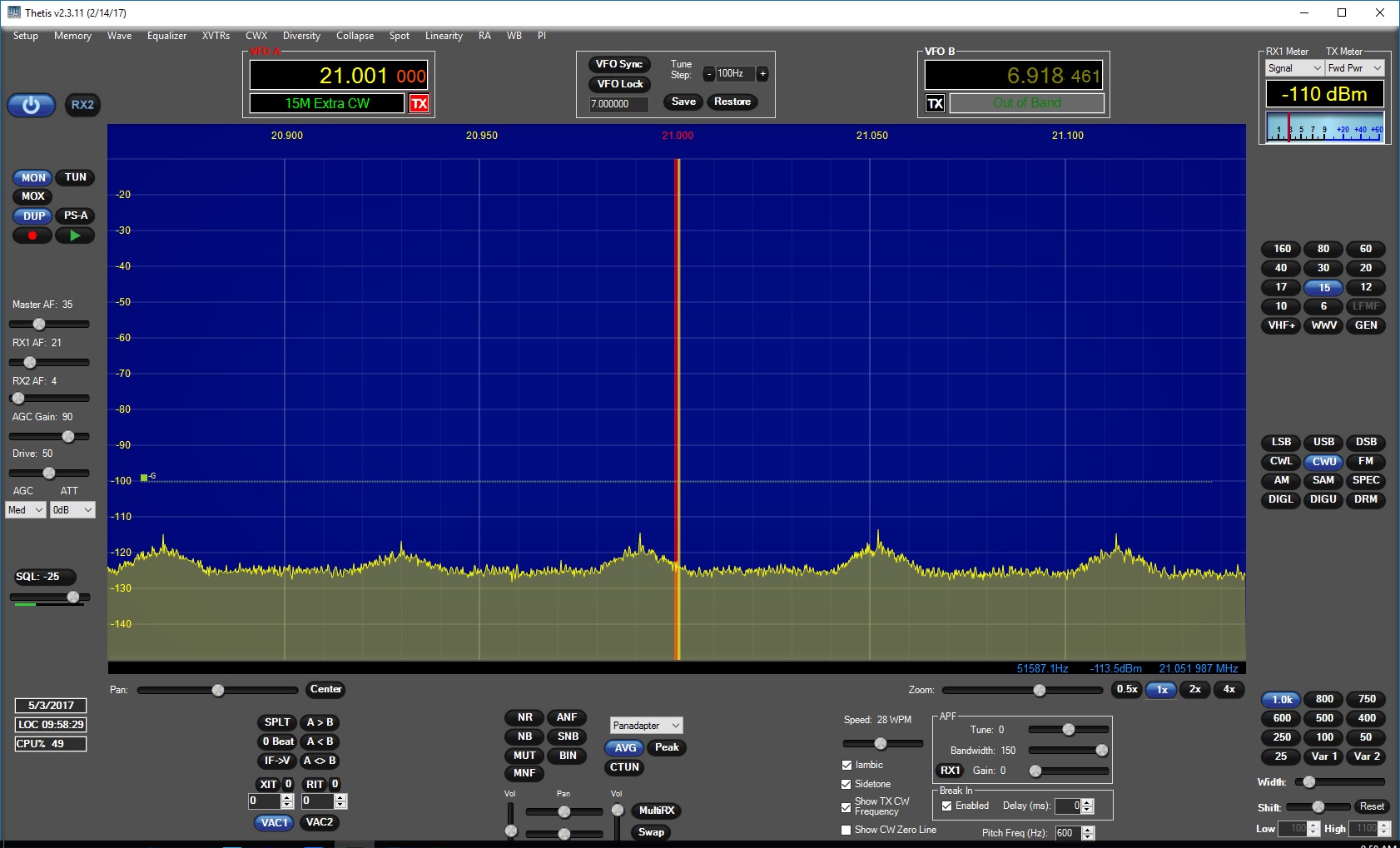

For the last day or so, I've been trying to trace a bizarre noise problem that occurs when the 8000DLE is operating. I am using an Icom 7300 and ANAN 200D for the noise display measurements.
I finally localized the source to a Netgear Gigabit Ethernet switch. If the 8000DLE is plugged into Port 4 of the Netgear switch, I see the noise as shown. If I move it to any other Neatgear port, the noise drops to zero.
So, a question for networking experts: why would one Netgear Ethernet port show this problem? A defective Neatgear product? I have to dig up another unit and swap it out. I'll report the result here.

- 8000DLE-Switching-Noise-20m-050317.jpg (323.01 KiB) Viewed 14030 times
- 8000DLE-Switching-Noise-17m-050317.jpg (333.81 KiB) Viewed 14030 times
- 8000DLE-Switching-Noise-15m-050317.jpg (324.15 KiB) Viewed 14030 times

Okay, I swapped out the Netgear switch with an identical GS108 model and all is well. I guess something is defective with port 4 of the other Netgear switch. Interesting problem that lead me on quite a chase. I did not initially suspect the Netgear device to produce switching noise at regular intervals, especially since it's being fed from a linear power supply.
