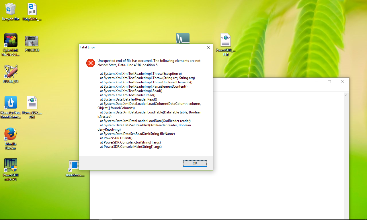

I get the message, below, when I run PSDR (setup seemed to run fine). Same message with .15 and .17 of the software. Running the latest version of Windows 10. ANAN-100b machine.

This looks to me like you have a database file that's gotten corrupted somehow, and it's happening during start-up. The fix is to (1) rename your database.xml file to something else, (2) find another database file on your computer that has worked in the past, (3) copy that file into the directory where your database file is now (in the AppData directory tree), and (4) rename it to database.xml, if it isn't already called that. This is the way to not lose most of your settings. The other fix is to reset it in Setup - but I think since this is happening during start-up, you can't even get into Setup.
If this gets you going past start-up, then (5) go into Setup and reset the database and start over (unless all is fine with your new settings intact).
If you can't find another file that works, send me an email and I'll send you one. Also, look in the DB_Archive directory in the same place that your database.xml file is.

I agree with W2PA that this looks like a database problem. I think though, that you could just rename your existing database, and start from scratch. Without a database file in place, PowerSDR should start and allow you to create a new database.
I make screen shots of all settings so creating a new database is a relatively easy chore.

Thanks all... I deleted the database and reloaded and all is fine now.
