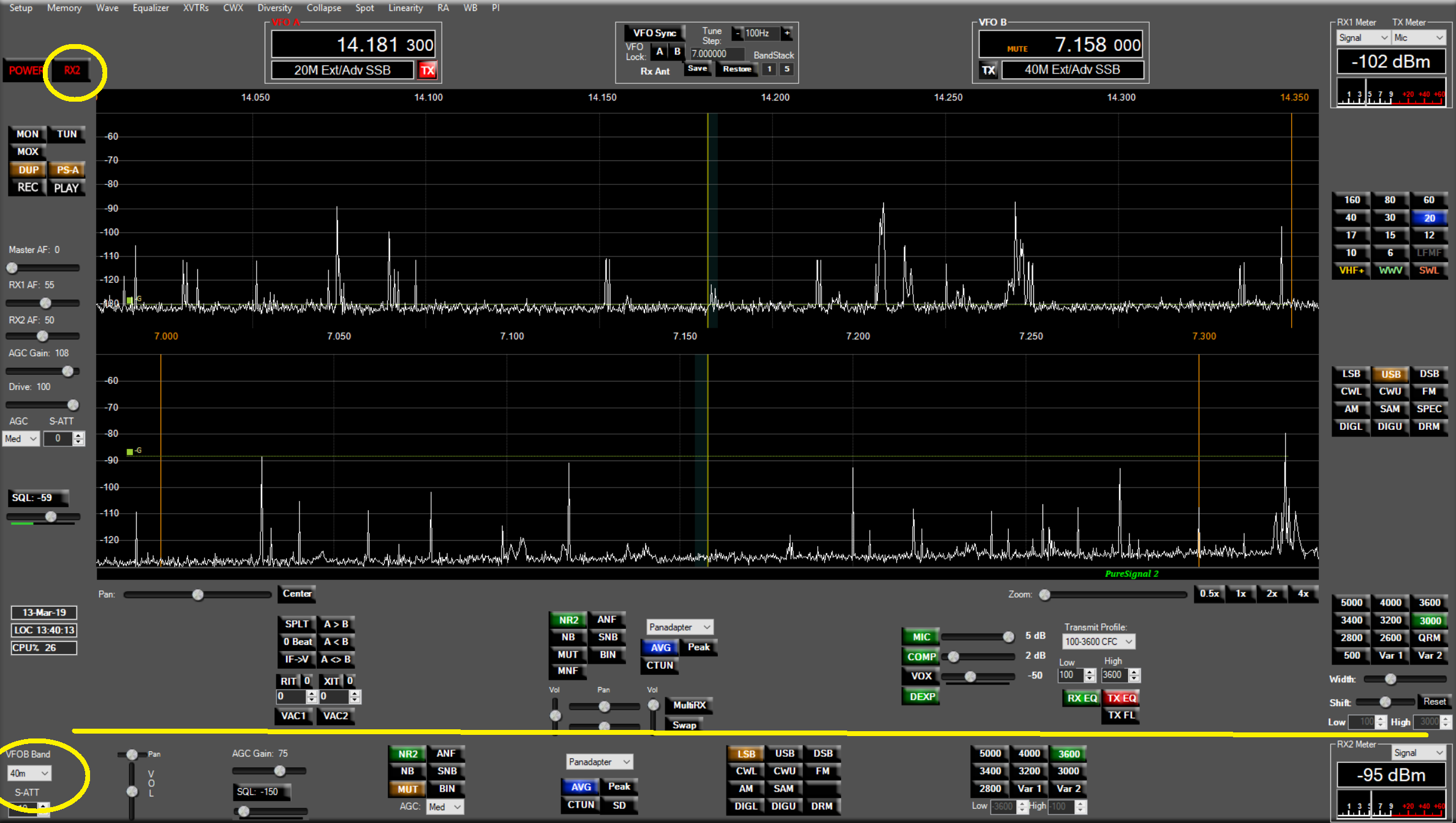

Here is a screen shot of my 7000 on 2 bands on 2 different antennas. Did you click on the RX2 button (circled in yellow, upper left corner)? Once you do then the GUI expands (everything below the yellow line) to show RX2 controls, including the band selection (circled in yellow, lower left).

yes i know about hte RX2 button.
what i did't know and the problem i had was becouse was selected the SD (stereo Diversity) funcion, so i could't switch band.
now i deselect and is ok.
about the buttons below your Yellow line is more clear now. but still i don't understand why are there. there are a lot of empy spot in the page, and all could be make more clear. i check some skin but all is the same. any suggestions?

ik7ytt wrote:about the buttons below your Yellow line is more clear now. but still i don't understand why are there. there are a lot of empy spot in the page, and all could be make more clear.
Those buttons below the yellow line (that line I added on the image only) are all dedicated to RX2 controls.
