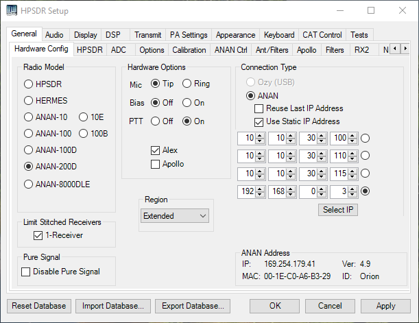

I have been running my 200D plugged directly into the PC, with the PC having a wifi connection to the router. I decided to try an ethernet switch since I may want to use a Pi console, but cannot get it to work. It's a tp-link 8-port Gigabit switch. When I plug the PC and 200D into the switch, but without the router, the PC easily finds the 200D. If the router is already also connected, the PC does not find the 200D. If the PC and 200D are running and the router is then plugged in, the 200D drops out and a computer restart is needed for the PC to re-discover the 200D. Any help is appreciated.

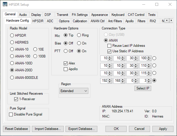

The PC, yes. Control Panel>Network and Internet>Network Connections>Ethernet>Properties>Internet Protocol version 4>Properties>Obtain an IP address automatically and Obtain DNS server address automatically.
The radio, not sure. When first connected via switch, the router assigned an address in the same subnet, and I reserved that address for the MAC address of the radio. This did not work, so I assigned that address on the radio as a static IP, see Router.PNG. That din't work, either, but it does work in that config when LAN is not attached, see No Router.PNG. The differences are that the MAC address disappears from the setup page if the LAN is attached, and version 0 of Hermes is shown. I see also that the radio continues to show a IP in the 167 range even though I assigned a static IP in the 192 range. I guess I'm not managing to get the radio to use DHCP. What have I got wrong here? Thanks.
Buck ko0y
Buck ko0y
- Router.PNG (37.43 KiB) Viewed 12518 times
- No router.PNG (37.78 KiB) Viewed 12518 times
