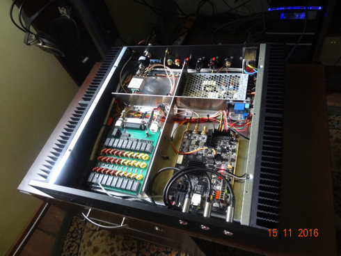

I have SDR Angelia + BPF -out 500mW. How to connect my SDR to Hilbeling HPA-8000B? PA needs a cable connection with CAT. Will without CAT will switch the bandwidth, ptt?
DSC01470 copy.jpg (228.42 KiB) Viewed 9356 times

P.S. FANTASTIC job on your radio, it looks wonderful!
Ho Scott,
Thank you very much for the info and nice words. I already know what to do. I do not have a serial port in my computer and I need to buy a card with an RS232 port. SDR Angela works very well. The good news is that there is no CUSDR to transmit because it will be very promising. Happy birthday to Wroclaw.
