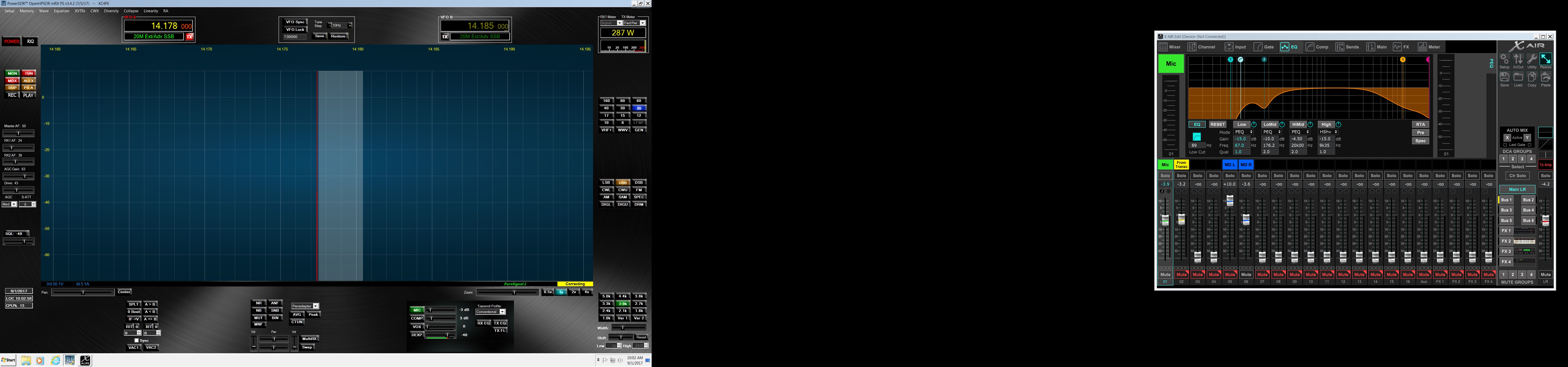

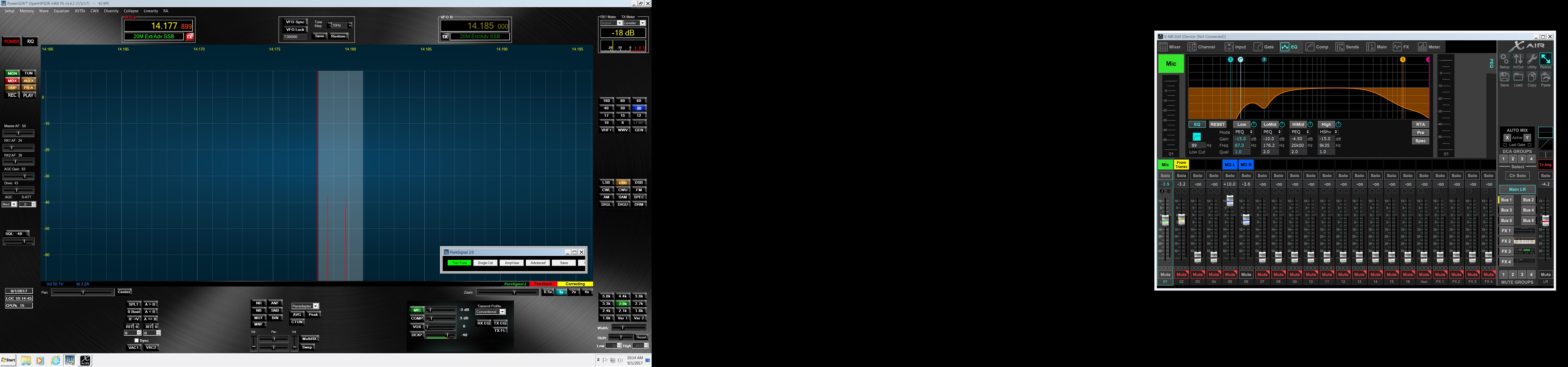

Re: Got the RED & YELLOW
[img][img][attachmhttps://apache-labs.com/community/download/file.php?mode=view&id=119ent=0]PS%20TT.jpg[/attachment][attachment=1]tune%20TT.jpg[https://apache-labs.com/community/download/file.php?mode=view&id=118/attachment][/img][/img]
Here, I hope are your two screen shots...I wanted to Emailed them..but....use the zoom feature to get a cleaner view
- PS TT.jpg (1.03 MiB) Viewed 39256 times
- tune TT.jpg (1.01 MiB) Viewed 39256 times
Wow, something's broke! It's only showing about -36dBm using TUN. That's way low
1500W = 61.8dBm. Less 44dB coupling factor, the output of the coupler should be 17.8dBm. Less the 10dB attenuator, 7.8dBm.
So there is a 44dB discrepancy between what your receiver is seeing and what you should be getting.
Thus, if your amp is really putting out 1500W (61.8dBm) something is wrong with either the coupler, the attenuator, or the cables.
Run your external amp at 100W in TUN, just to drop the power a little. At that power level there should be 6dBm out of the coupler. Remove the attenuator and see if DUP shows 6dBm. If so, then it's a bad attenuator. You can play the same game with the cables, as well.
One other thing you can try, and it's a long shot. It is physically possible, unlikely, but physically possible, that the PS INPUT and PS FEEDBACK connections are reversed internally. Obviously it is correct to use the PS INPUT connector, but if things are reversed internally...If that's the case, then you can confirm this by making your feedback connection to the connector marked PS FEEDBACK. I'd recommend doing this at the 100W power setting on your external amp--no point in stressing things. If you do that, and you see about 6dBm (without the attenuator) on DUP, then I think we've found the culprit.
P.S. next time you make a screen shot, use the Snipping Tool (it's in Accessories) to just grab the part of the screen you want. In this case, it would be the entire PowerSDR window, not the entire desktop.

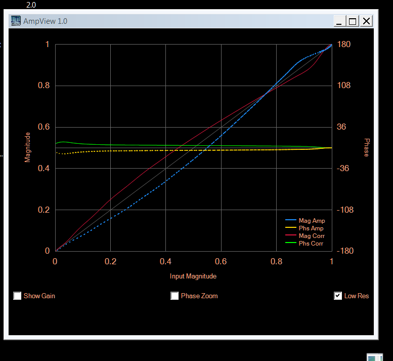

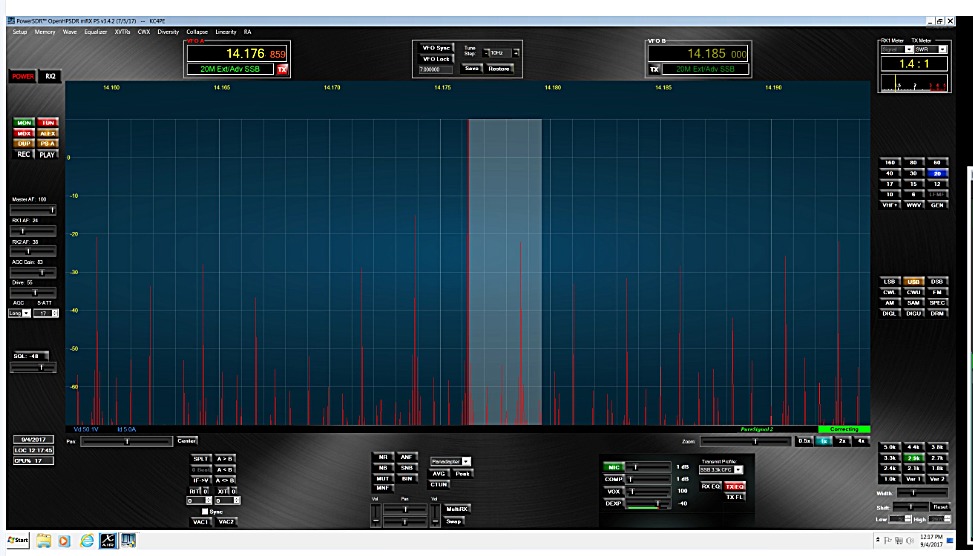

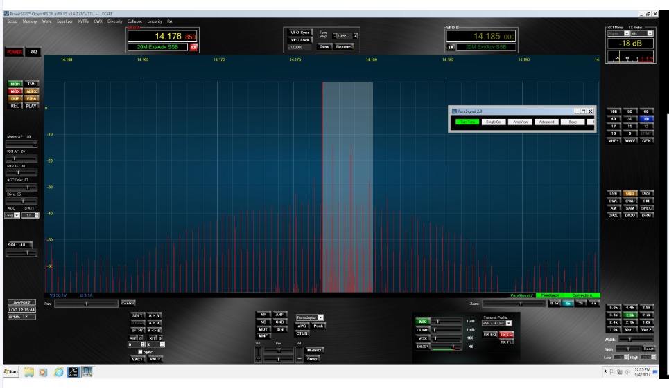

Ps Iput and PS Feedback are reversed in my 8000.
After testing all cables by using the two SMA ports, all the cables are fine. PS worked with the factory jumper and my RG8 cables, Also check the SMA factory adapters, they were all fine.
So we reversed the cable from Input to Feedback, put 100 watts through it and it works...no more yellow and red but all green.
S-ATT is 15 at 1500 watts.....
Wanted to get down to 13, so began to sub pads...still 15 even with NO pads... no combination of pads would move it off 15
Took 3 screen shots
AmpView,,,,,,,with the PS TT running...
PS with it's TT running
The standard TT at 1500 watts
They all look terrible....
https://apache-labs.com/community/downl ... iew&id=122
https://apache-labs.com/community/downl ... iew&id=121
https://apache-labs.com/community/downl ... iew&id=120
Though for 3 minutes I weas out of the woods...????
Took 3 screen shots
- standard TT.jpg (128.58 KiB) Viewed 37906 times
- Pure Signal 1500 watts.jpg (110.79 KiB) Viewed 37906 times
- ampview.jpg (54.5 KiB) Viewed 37906 times
Looks like my last guess was correct, about the reversal of the cables internally
Have you reported this to Apache?
The Ampview screenshot makes it look like you are over-driving the snot out of the external amp. The compression at the top right corner is phenomenal, I've never seen anything that bad.
I'm not saying that's the problem, only what it looks like.
At 1500W, with a 44dB coupling factor, and no pads, the step atten should be at 28dB. So, as you say, something is still wrong.
After setting the proper levels, here is this AM's VIEW, at 1500 watts ..S-ATT = 14
https://apache-labs.com/community/downl ... iew&id=125
- ampvview.PNG (41.96 KiB) Viewed 37899 times
