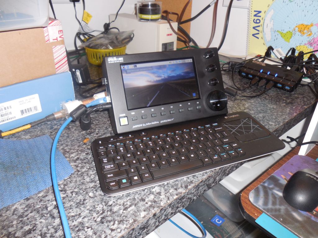

Been using a cheap ($24) Logitech mini kbd with touch pad model K400+ and K400r on my pihpsdr-Controller with no problems. Love to have that small footprint near display. Pix attached.
73 de Ken N-9-V-V
73 de Ken N9VV
