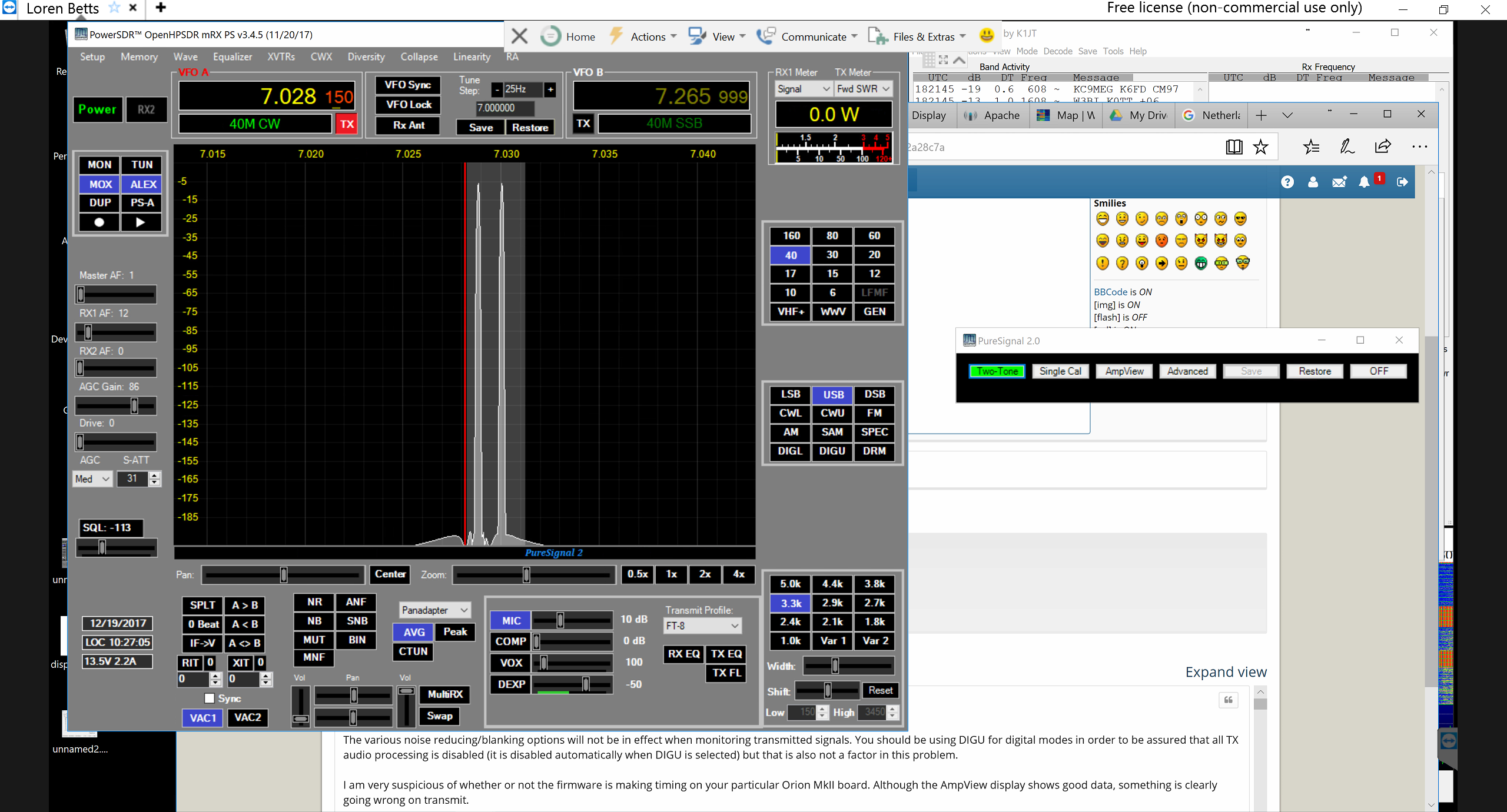

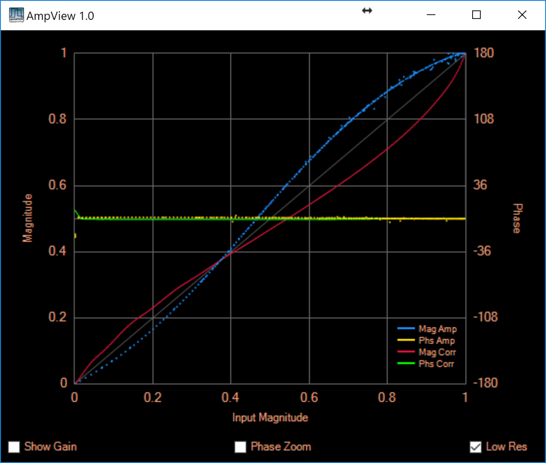

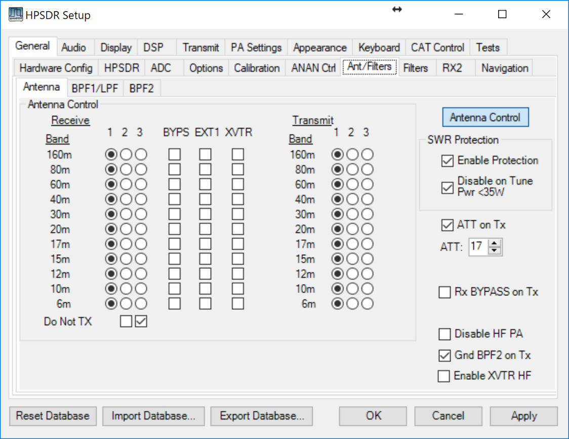

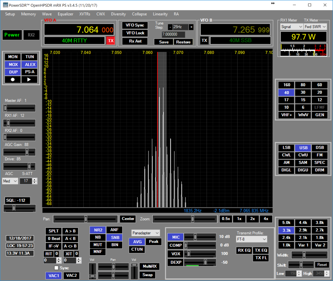

I have a 7000DLE running PSDR 3.4.5 and am having issues running PS. If PS is disabled then the transmitted two-tones look reasonable. If I uncheck the PS disable but don't enable PS-A I get very an output that does not look right. The output is independent of drive level. I can bring it all the way down to 1% and the result is the same. Below are figures of my setup and results. Any assistance would be appreciated.
- unnamed3.png (313.63 KiB) Viewed 35955 times
- unnamed2.png (307.34 KiB) Viewed 35955 times
- unnamed1.png (281.91 KiB) Viewed 35955 times

Re: Pure Signal Issue

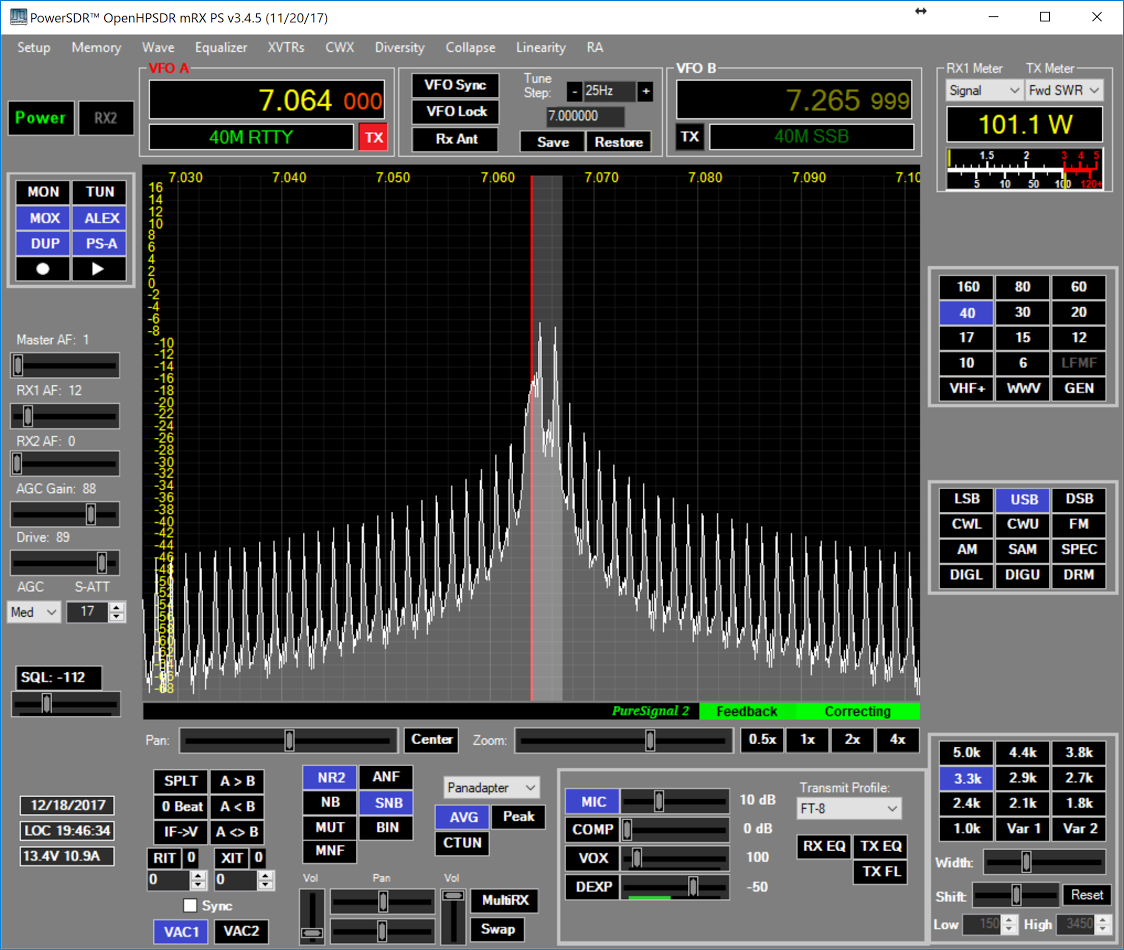

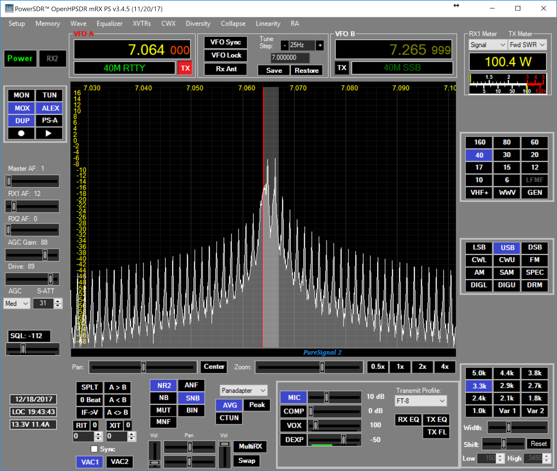

More figures.
- unnamed5.png (145.87 KiB) Viewed 35953 times
- unnamed4.png (313.61 KiB) Viewed 35953 times
just a precaution - it might not effect what you're doing but I noticed a couple things:
1) I know that if you have some (all?) of the noise abatement stuff on the panadapter will be effected on transmit. Mostly I notice that if NB2 is on that the xmit waveform gets bounced around instead of being steady ... so just to be cautious you might want to not have NB2, SNB on (nor NR/2) ...
2) I see you have an FT8 profile selected ... note with the latest version of software (starting I think with 3.4.5) the issues with incorrect removal of audio enhancements had been fixed ... previous to this the CFC could get left on ... also I believe the leveler. Now you don't need to select a separate profile for digital modes - just set up your SSB profile and leave it at that - the program will automatically turn off the EQ, CFC, COMP as needed ... with that said I don't know what you have defined in your FT8 profile - perhaps it is related to the issue at hand?
The various noise reducing/blanking options will not be in effect when monitoring transmitted signals. You should be using DIGU for digital modes in order to be assured that all TX audio processing is disabled (it is disabled automatically when DIGU is selected) but that is also not a factor in this problem.
I am very suspicious of whether or not the firmware is making timing on your particular Orion MkII board. Although the AmpView display shows good data, something is clearly going wrong on transmit.
There were three releases of Orion MkII firmware in quick succession: 2.0, 2.1 and the latest is 2.2. See here. Be sure to also look into the "previous" folder. These revisions came out in quick succession because there were reported problems with improper timing closure on certain serial number boards, and most of these reports were associated with PureSignal.
Two suggestions:
1. With PureSignal running, see if there is any substantive difference between DUP on and DUP off. DUP on is showing you a true, full duplex view of your own transmission as routed from the internal coupler to RX1. DUP off is showing you the calculated spectra of the data going out to the DAC. If they are effectively the same that implies that the problem is with receiving the PureSignal data or with processing it. If DUP off looks good, then that implies the problem is in the transmit side of the firmware somewhere.
2. In any case, I'd strongly suggest trying firmware versions 2.0 and 2.2 and see if that makes any difference.
Loren: are you comfortable using HPSDR Programmer to load new firmware? It's not hard. See here.
Two suggestions:

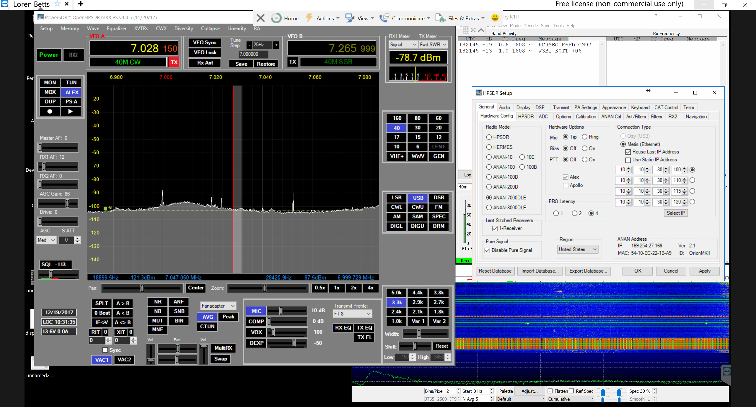

I am noticing something strange on receive. Looking at CW signals you will see that there are additional side tones when PS is enabled whereas they do not exist when PS is disabled.
I found out the cause of the issue although I do not understand the mechanism. I had the sample rate in the Primary Audio tab set to 38,400. Setting it to 19,200 appears to solve the issue. I wonder if it is a display issue since the amp view looked reasonable.
Also, should this be used in digital modes?
Dr. Loren Betts
W6VH
W6VH
Ah ha! That's the problem! PureSignal is not supported at sample rates above 192KHz. This is combination of two things. First, although on paper it should work, 100MBit/s Ethernet has trouble keeping up with the bandwidth required when sample rates are at 384KHz. During transmissions you are sending an IF data stream to the radio, and receiving 2 IF data streams back, for a total of 3 IF data streams, plus audio and control/status data streams. This is also why stitched receivers are disabled when PureSignal is enabled (although I can see a software/firmware method to get around this limitation, it's just not implemented). Second, the PureSignal algorithm is optimized for 192KHz.
So go back to firmware Rev. 2.1 or 2.2, keep things at 192KHz, and be happy!
