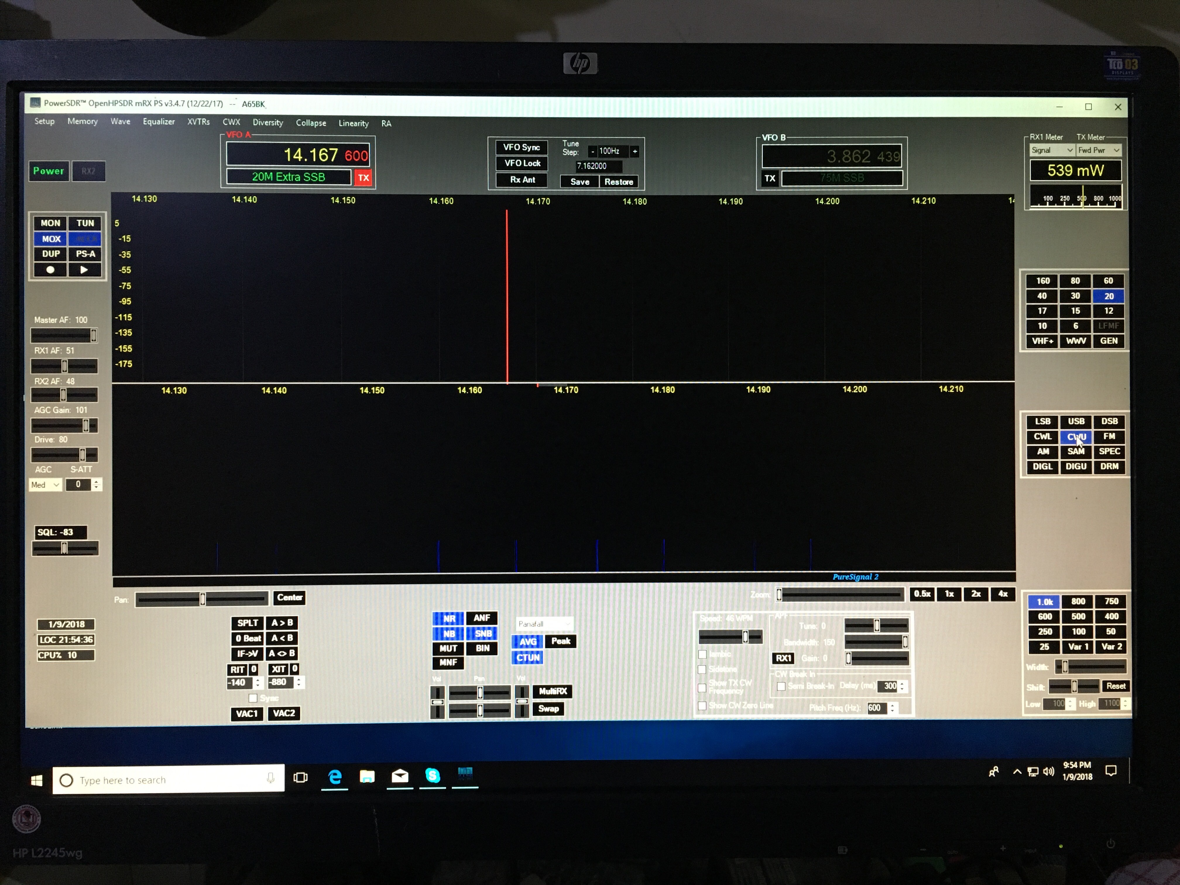

Hi Scott, Gary
Thanks for reply. As Gary mentioned, I don't get a continuous DOT or DASH !!
So it can be something else than a short to ground. Is it ?
Please see the screen shot when I select CW mode. It switch to "MOX" not "TUNE". But . still I get same output power as if TUNE is pressed !!
Please advise further.
73s
Prem.

Re: CW Mode Operation
I have no clue what could cause that.

Hi Friends,
After a detailed troubleshooting opening the box on my Hermes board, I could notice that one CW line pin on U9 had a dry soldering and which was the trouble for my CW faulty MOX .
I corrected dry soldering and now , only if I short either Key point to ground only it switch to MOX. I am not a CW operator and so don't know much.
Where can I get the details to understand
Lambic
Side tone
Semi breakin functions ?
If I short Dit or Dash line to ground, I need to get continuous Dit or Dash . Is it ?? I dont see it.
Any other setting missing for me ?
Thank you all for advising and helping me to clear my Hardware fault.

How I can eliminate TX going to Off between words, while I sent CW ?? The PTT relay clicking between words is annoying. There will be some setting to avoid this ?? Please advise me.
73s
Rds,
Prem
I had noticed open connection on U9-76 Pin.
73s
Rds,
Prem
Change the break in delay setting seen just below the APF window when in CW mode. Just be aware if it is too long you might miss the first element of someone replying to you! The relays CAN be annoying. They're not quiet that is for sure.
Hi Gary,
After increasing delay to 360 ms, I could get rid of that issue.
