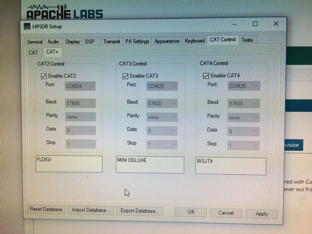

I tried, using Hamlib for Rig control in Fldigi, using one Com Port from PSDR (Com 14) . Com 24 in PSDR paired with Com-14 using Com-0-Com.

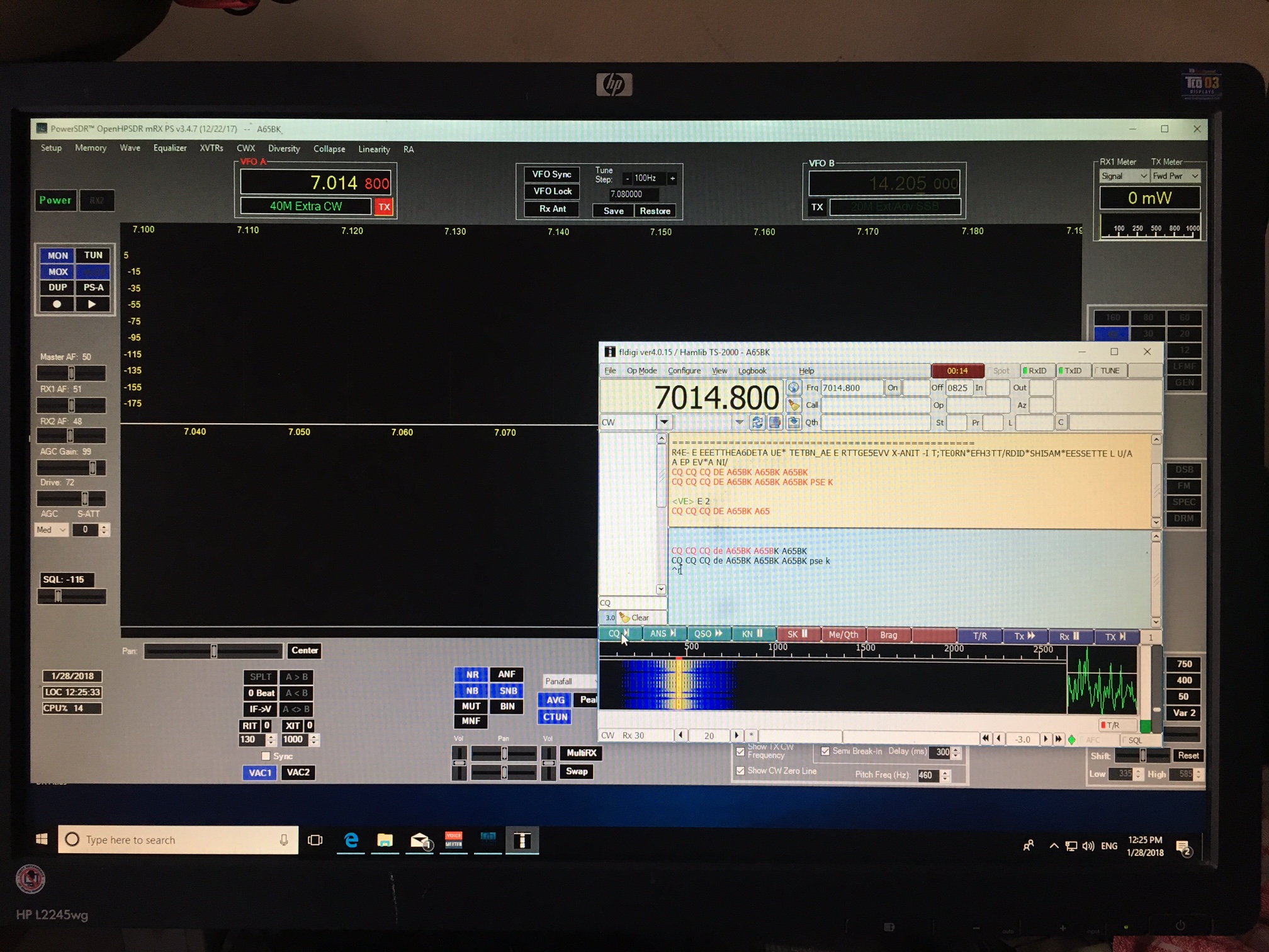

When I press Tune or T/R in Fldidgi, I get CW side tone from speaker, Radio keys to Tx mode. But Power S meter shows 0 watts and finally no power out from Radio.
In Hamlib used Radio TS2000 and Com 16 as Device. Com16 paired with com26.

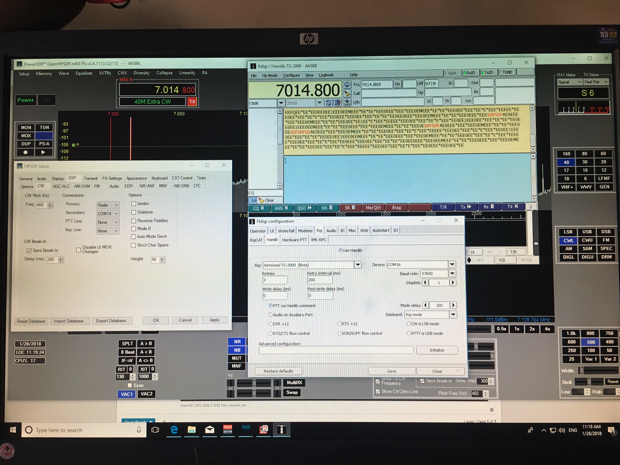

In PSDR DSP/CW : Primary - Radio ; Secondary - COM14 ; PTT- None ; Key line - None.
Attached a screen shot for reference.

A65BK wrote:Hi All,
I notice that if I select DIGL/U in SDR screen, I get power out.
Is that the correct way ??
If I select CWL/U, power out is zero.
73s,
Prem
DIGU (or DIGL) is the correct, and ONLY way with Fldigi unless you build an AFSK external keyer. The reason for this is because Fldigi only implements AFSK CW, i.e. CW using audio tones. Therefore it cannot be run semi or full break-in UNLESS you implement their so-called QSK interface. See here and here (always best to read the manual ;) )
