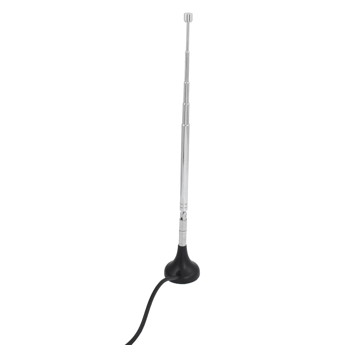

Posts: 6110
Re: Accuracy re fidelity on/with the TX display while using PS
AB2EZ wrote:...it would be best to use a short pick-up antenna attached to the separate receiver's input...
That's what I do. I want an over-the-air look at things.
This is what I use. I just stand it up on the windowsill in my studio:
