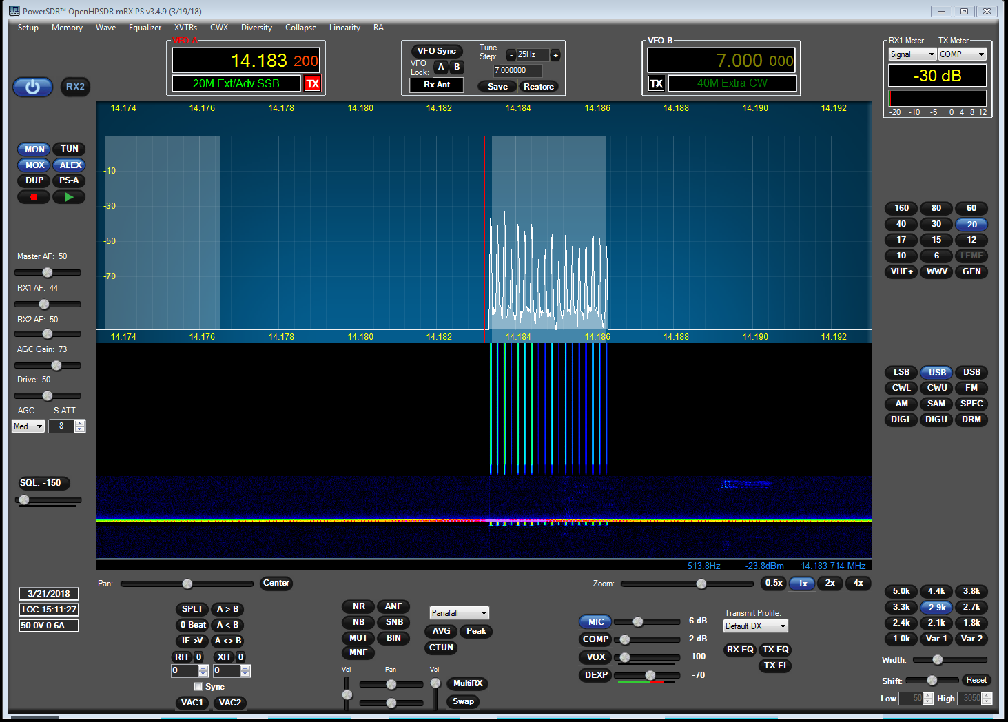

Just upgraded my 8000 to 3.4.8 ... on my first look see...the RX was fine but when I hit the PTT I have no audio just what he screen shot shows...Did I miss something during the configuration.
Then disconnected everything attached to the radio..PS. mike/PTT, etc..key'd and the same... and NO..NO TX power....
I'll let it stand and see???

Looks like a corrupted database. Export your database (in case you want to go back), reset the database, see what happens.
